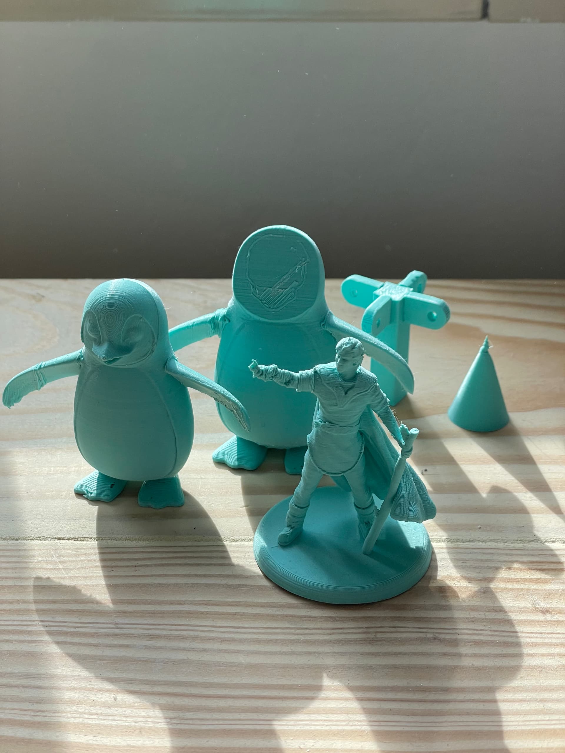

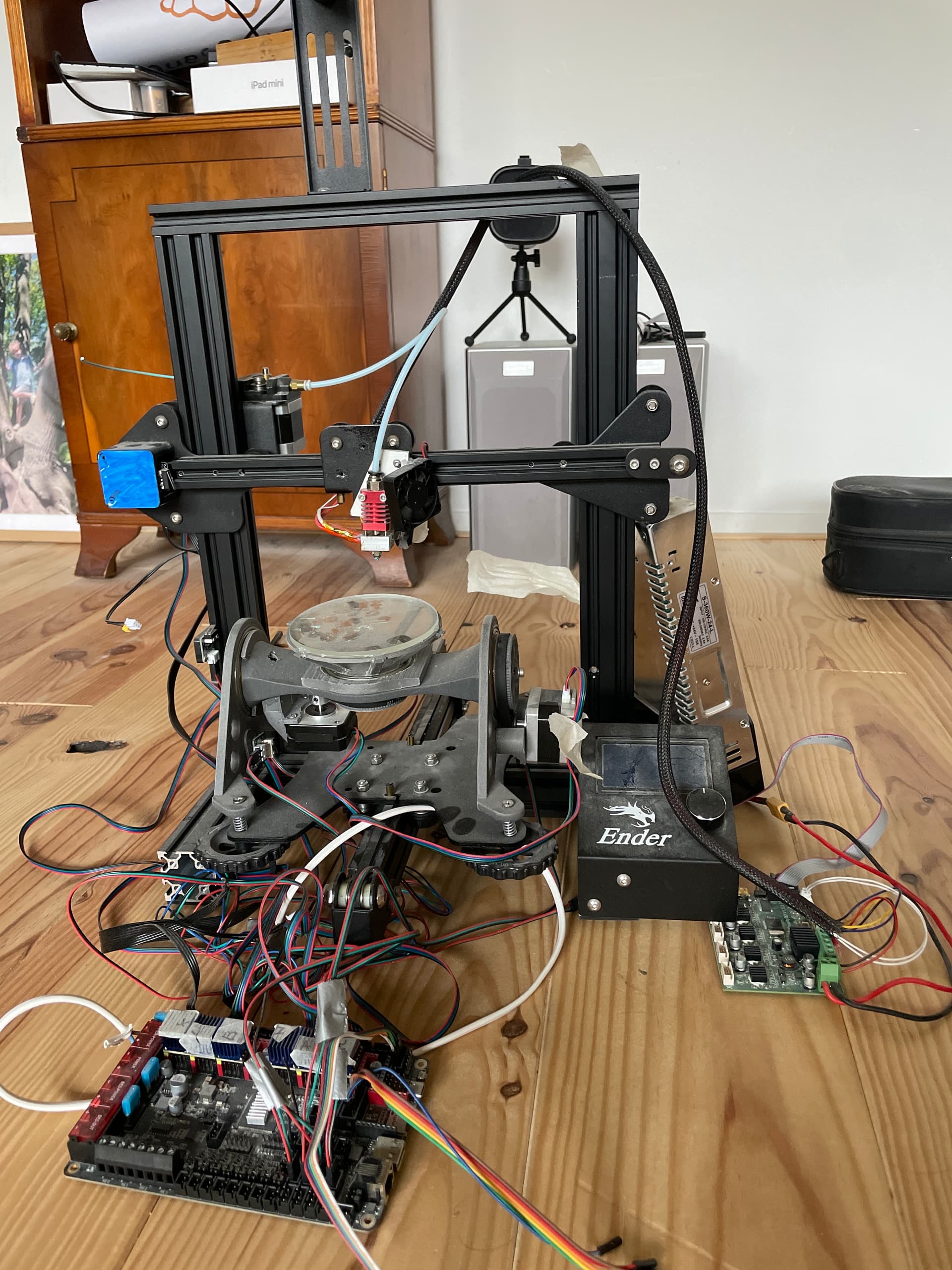

I have modified an old (and replaced) Ender 3 V2 with a 4th and 5th axis.
I also wrote an indexed slicer to print in multiple orientations.

The interface is via the Blender application, I wrote an addon in Python. And the gcode is created via the Cura Engine.
