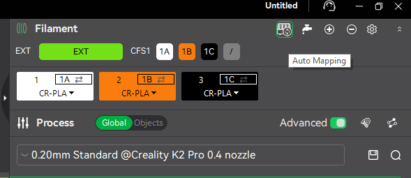

I am not having this problem using the latest Creality Print and the CFS with a K2 Pro. I have 3 colors loaded now and it will print just fine. Press the Auto Mapping icon in the top right to refresh what colors are in the CFS. Make sure the colors are correct and in the right place.

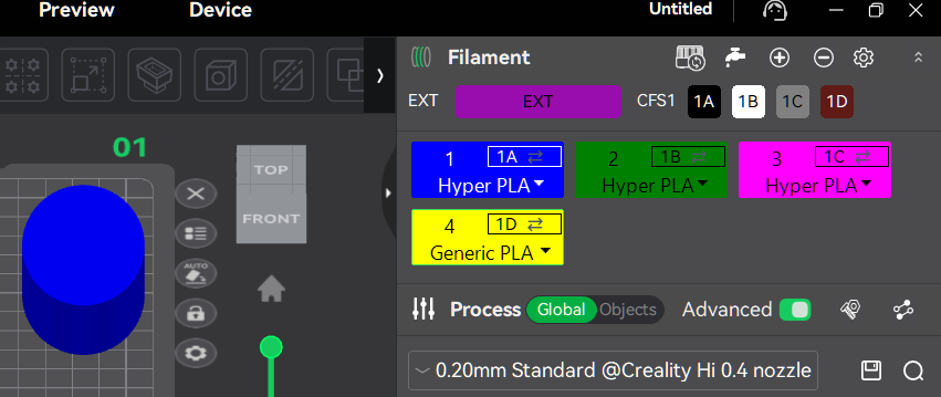

You must to assign spool slot to every color of your print to be able to print, even if you print will not use it.
By example, you slice a piece with 4 colors on your config, but your print have only one color, never less you must to assign a spool to the others colors.

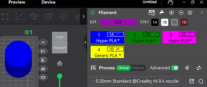

In this example I got a blue model and my slicer’s filament are blue green, pink and yellow. but my fcs have Black, withe, grey and brown filaments

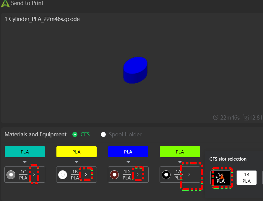

So when printing, you must to assign a color to each filament even if will be no used:
in this case the model will be printed using brown.
