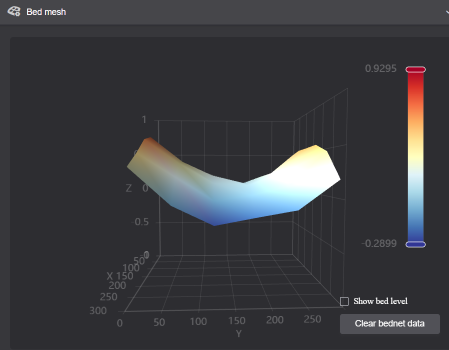

I have a very annoying issue of bed mesh warping with my K1 Max. I’ve succeed to achieve this result so far with spring bed leveling and rotating some screws but I honestly don’t know what to do anymore.
The first layer doesn’t stick to the platform well enough to keep printing on the right and left side of the bed.
I tried following this video and this one.

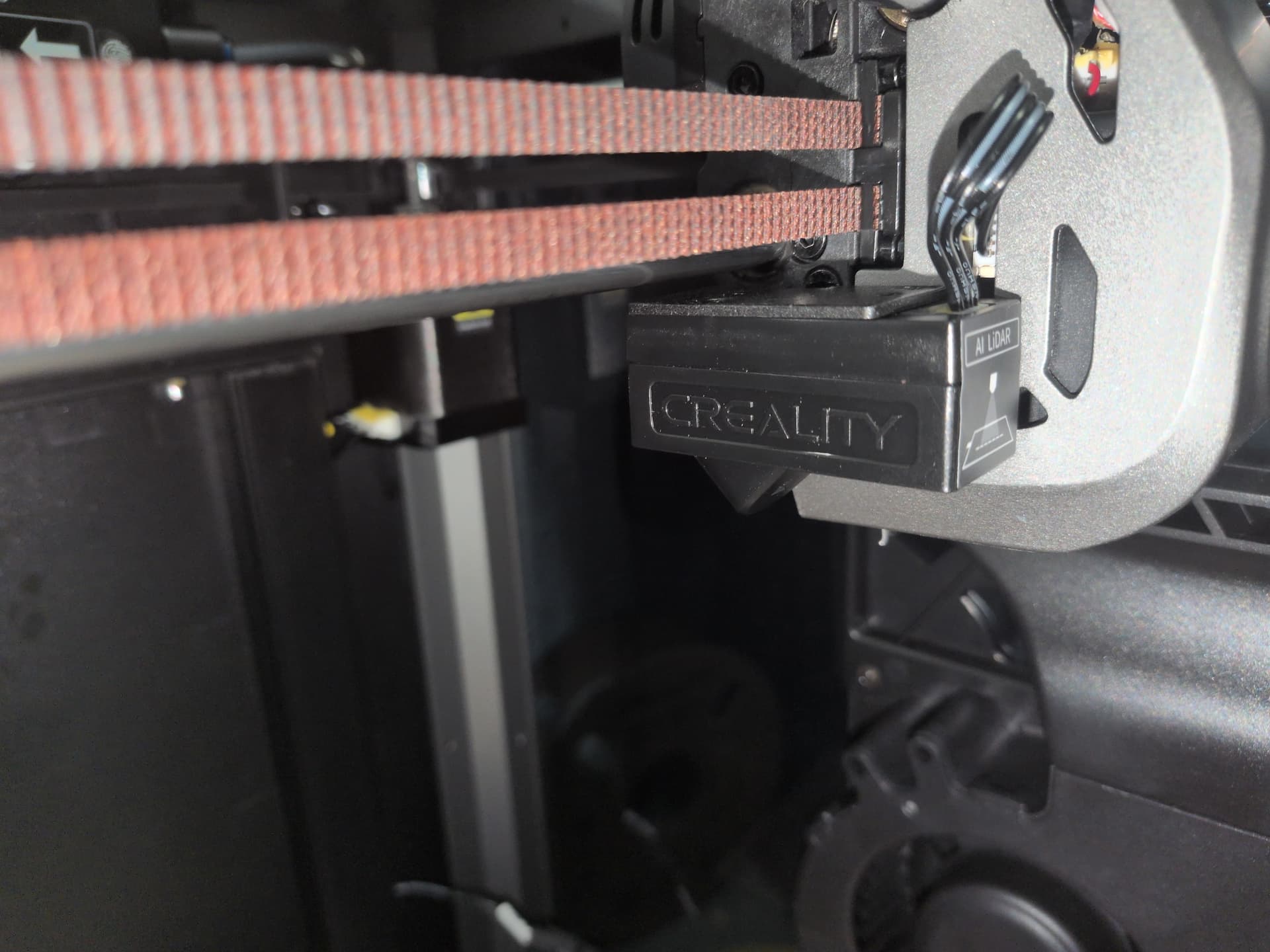

An other question, is it normal that my lidar has this gap on the back ?

Bed Mesh
This does look severe, sadly I’m not able to view my bed mesh. Are you certain that you did Skipping as shown in the video?
Alternatively Strain Gauges cost 25 EUR which might be worth replacing

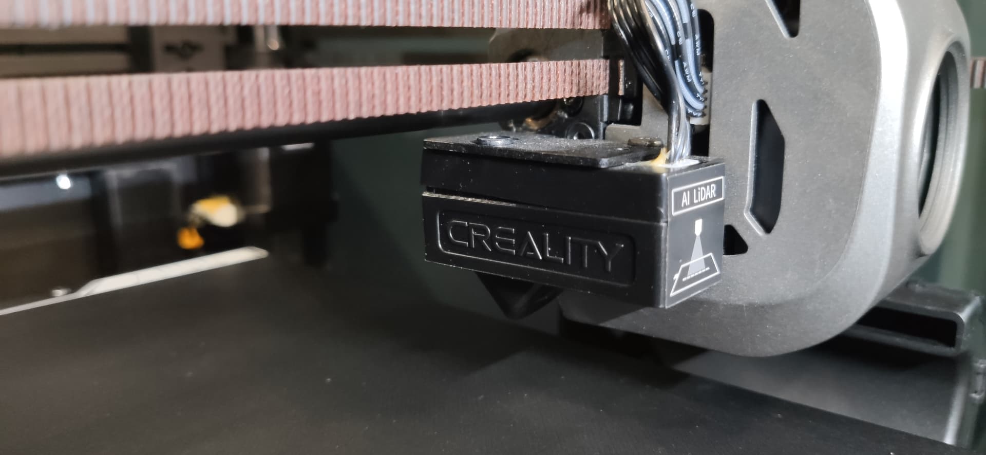

LiDAR Module
That one is defintly cracked! I attached a picture of mine as reference.
Keep me posted if you need any reference!
