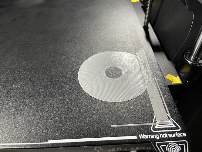

Calibration/Model Conflict
Is there a way to avoid this (I’m filling the entire print bed with these) ?:
I’d even be happy if the solution was an automatic pause in the beginning of the run so I could scrape the calibration print off the build plate before the model prints on top of the calibration strip, but I’m guessing that’ll probably require me to manually add an “M00” at the top of the G code(?).
I’m not familiar with the K2 plus menu but on the K1 Max there is a setting to not print the calibration strip. Not in front of the printer now but it’s an option in the camera menu. Maybe on the K2 you could turn that off if it’s an option…??
Thanks!—That’s true…I loaded the file from the printer’s memory and remember un-checking the “Use CFS” box, (I’m using the external spool for the first time) but I also remember NOT un-checking the “Calibration” box.
I’ll deselect “Calibration” and give it a try on the next print of this plate.
