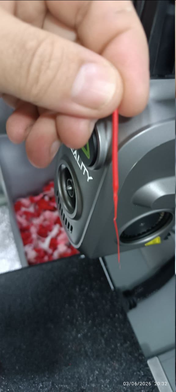

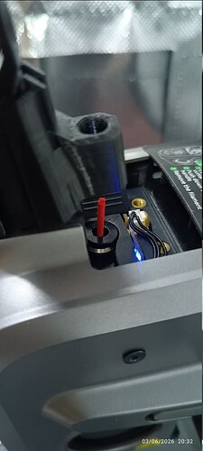

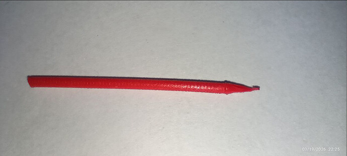

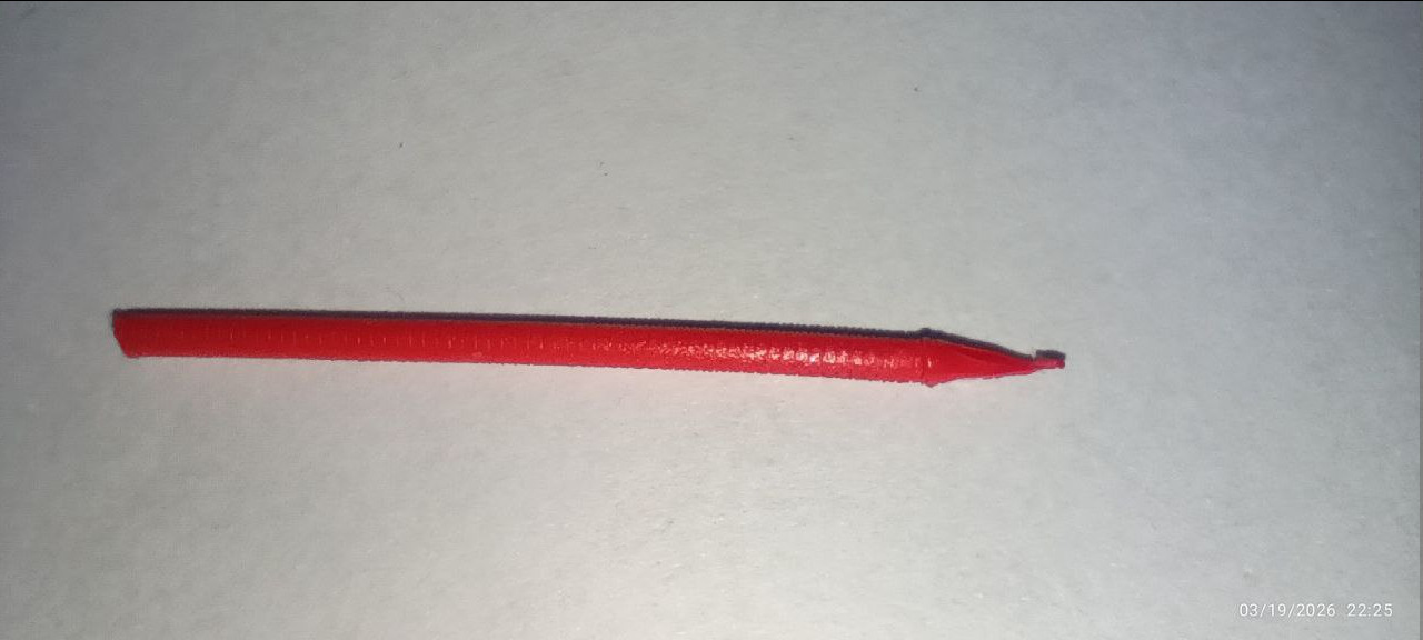

After check all the path of filament I removed the PTFE tube from extruder and I found this:
Removing the piece of filament becomes IS ALL THE FILAMENT ON THE NOZZLE, like if I did a cold retract!!
The bad thing is happen several times on a 7 hour printing.
On short printings whit several filament change do not happen!!!
any ideas about how avoid it?

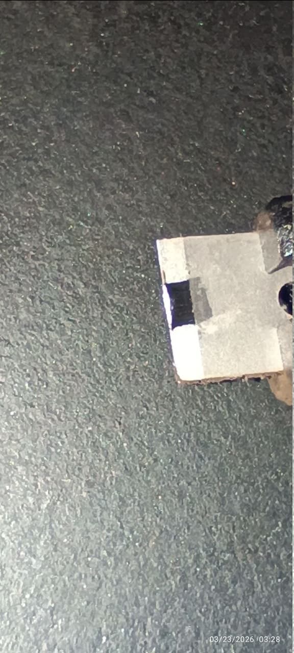

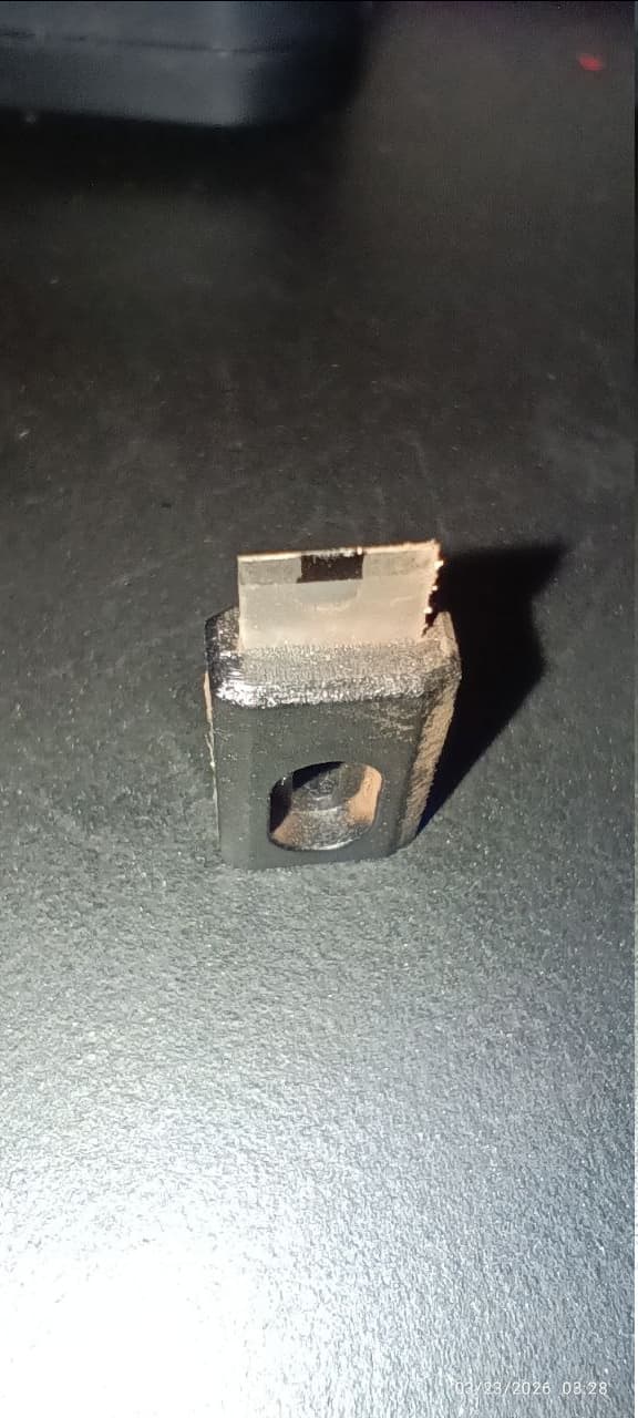

This is the state of my cutter blade:
Seems the tip of the blade has become dull so the filament is not full cut. I will print a long printing next week and let you to know.
As side quest I buy a pack of 10 new blades, but they do not work on neither of my extruders, THE MAGNETS ARE INVERTED so the blade is not kept in place but is pressed all time, so I had to sand my extruder (to the remove the glue of magnet) and change the polarity of the magnet!!!
