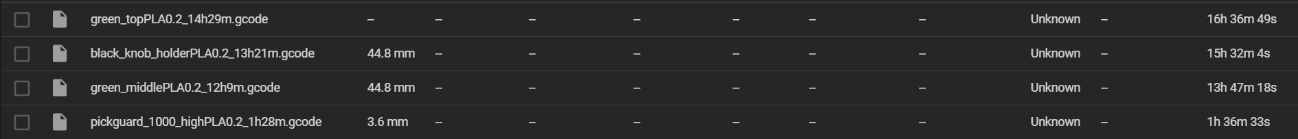

I have printed the Prusacaster for a colleague
https://www.printables.com/model/398795-the-prusacaster-a-3d-printable-guitar
How long did it take to complete? How much fill did you use? It’s cool by the way.
I don’t fully understand this table leveling, for me it levels everything before printing. Can this be turned off? It doesn’t really bother me, it only takes a few minutes.
sometimes even with the 4 corners level routine, it’s still a tad too high.
I followed the blog recommendation for the prusacaster
7 walls + 25% infill for the core piece
3 walls+15% infill for the rest
Core piece took 43h
and the rest, quite a lot
I haven’t printed for more than 16 hours. :sweat_smile:
