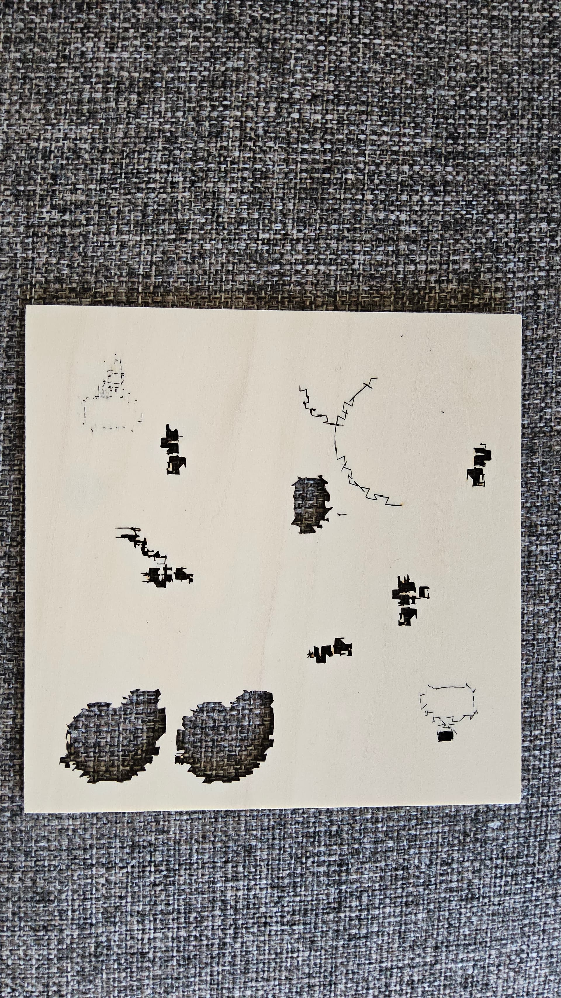

I have a creality falcon pro 10 w but while cutting its makes weird lines like zigzags shown below. I have everything installed correctly but the problem still exist. I tried a lot of solutions but no hope :frowning: . Can someone heeelp me please.
I solve the problem. The solution is try to lower to an old version of lightburn.
