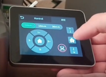

i saw several thing, you dont have 2789 error, yu have 2798 error, on Servo motor X and Y, i want you to try this first, touch this on the screen to unlock the printer, in this menu
once its unlocked, gently move the printhead, if its unlocked u will be able to move it, also the bed, if u succefully unlocked the bed and the printhead and u can move it, try again to make the printer to home.

I unlocked the printer, and I can move it by hand very easily. However, when I press the “Home” button to move it to its starting position, I get the XS2001 error.
