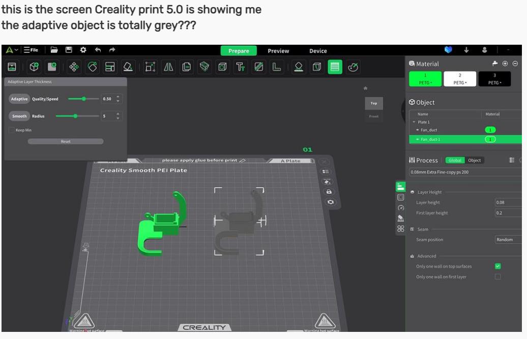

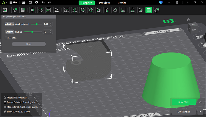

this is the screen Creality print 5.0 is showing me
the adaptive object is totally grey???
who can explain???

tjan: after all, it was already explained here: select imported object and push ā€œAdaptiveā€.
I just did that the right object I pushed adaptive
but it becomes gray

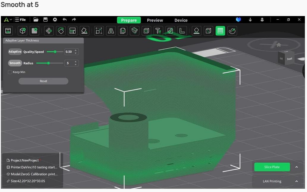

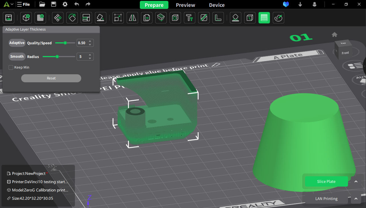

the pictures of davinci 10 from cp5 are gray/greenish
why does that not happen in mine cp5.0

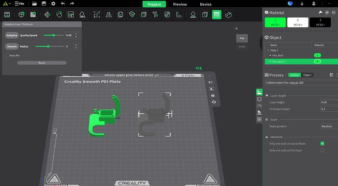

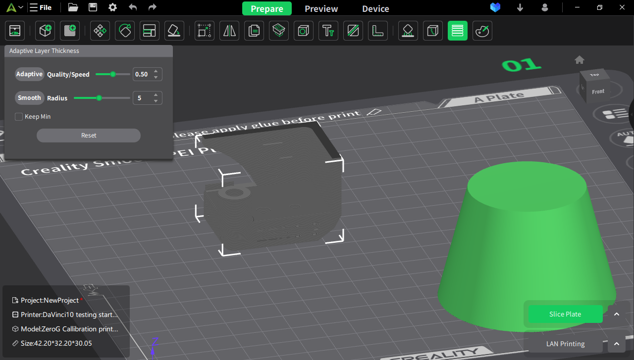

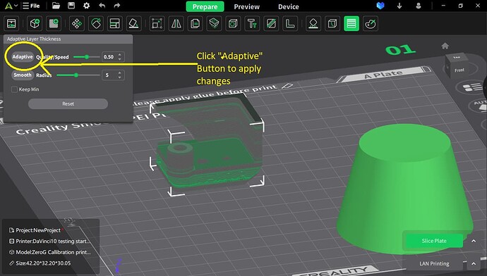

before hitting the adaptive button it is grey…
after hitting the adaptive button
and finally after hitting adaptive and smooth

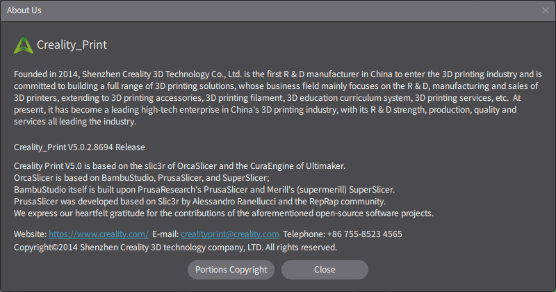

Maybe its the version your running:
Here is mine
thank you so much
now I get it :joy:

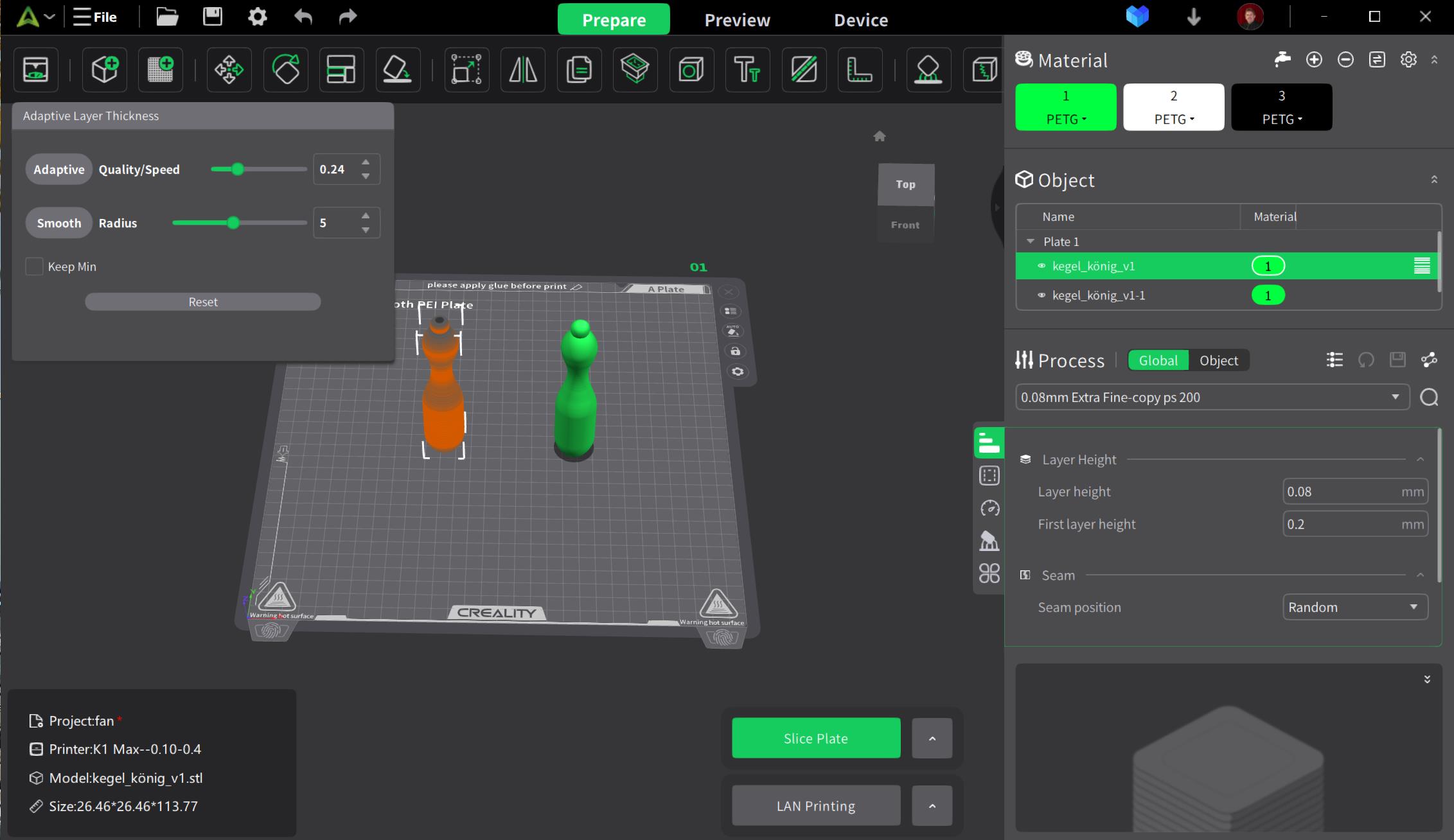

this does it look like in version 5.0.3
If you don’nt select keep min the printer is free in chosing layerheight it will take the thickest then and vary with smaller.
when selecting keep min it will stay within a certain layerheight and not choosse the thickest to begin with.
but when I selected keep min with 0.08 layerheight it thickest lines were 0.12 mm
but it didn’t select draft 0.24 or 0.20 which he will do when not selecting keep min
