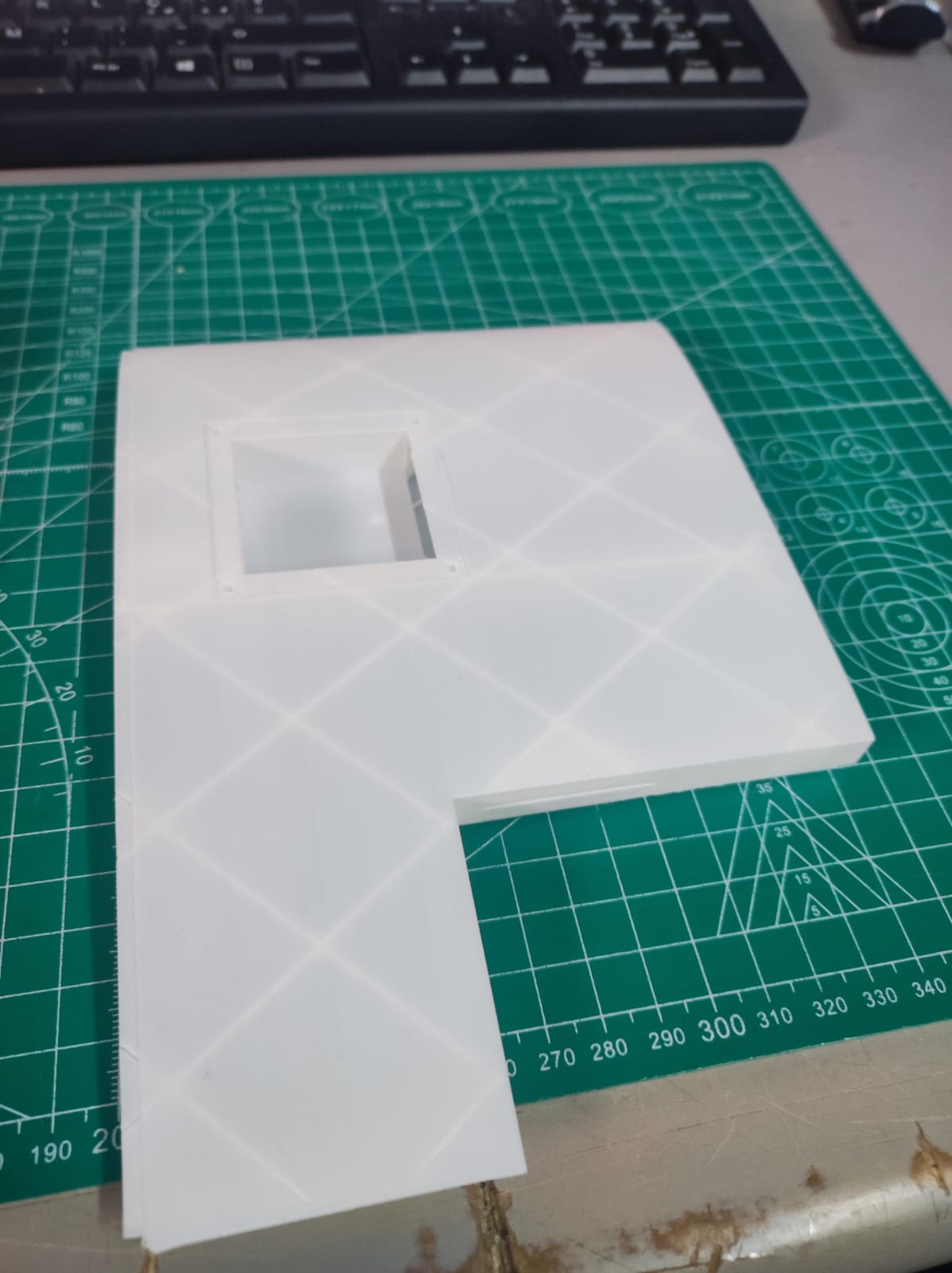

Oh thank you a lot for your kind and quick answer.
I used AI (ChatGPT) before my post but sincerely I prefer answer from users for sharing experience.
Regards
Antonio

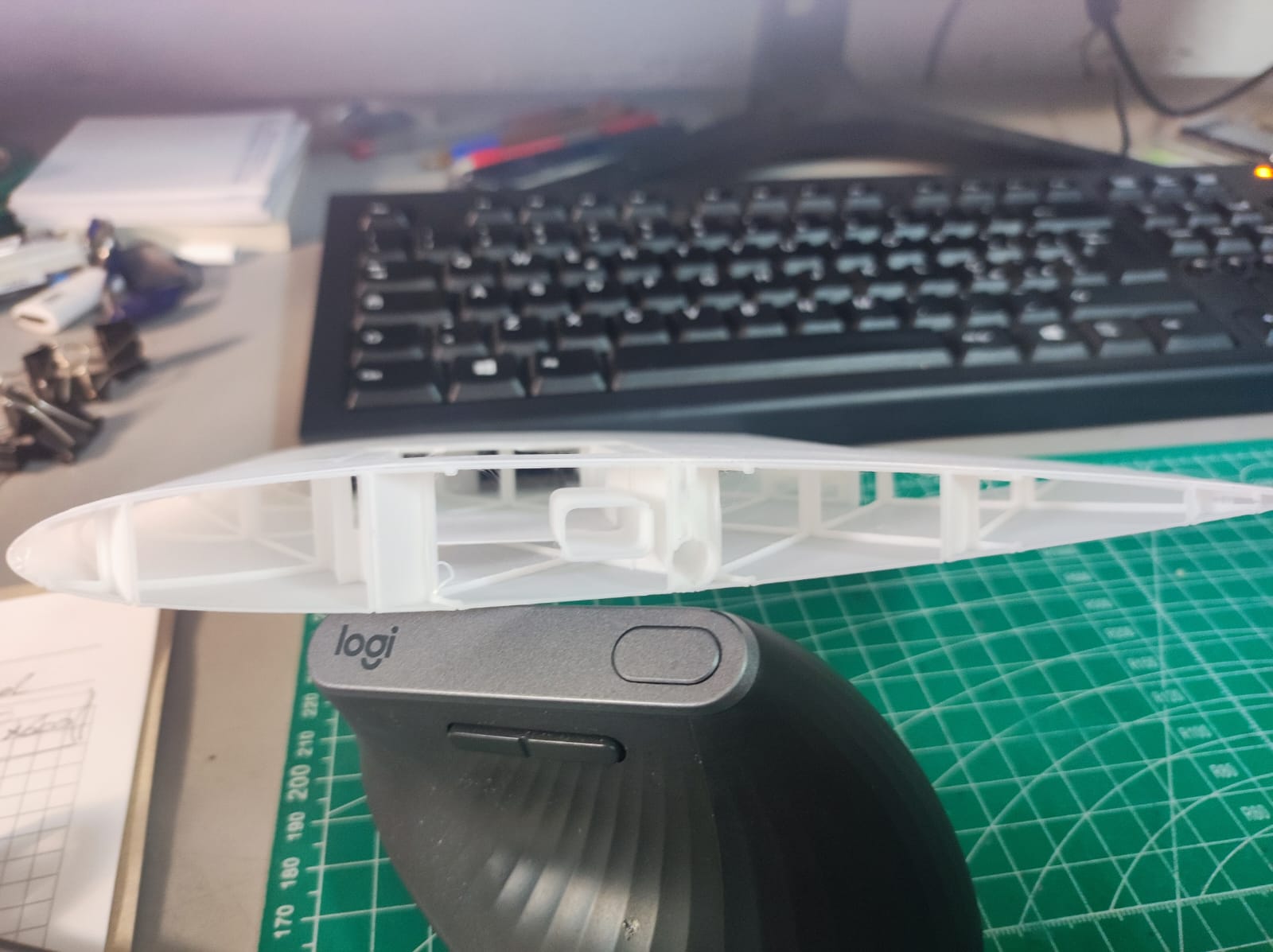

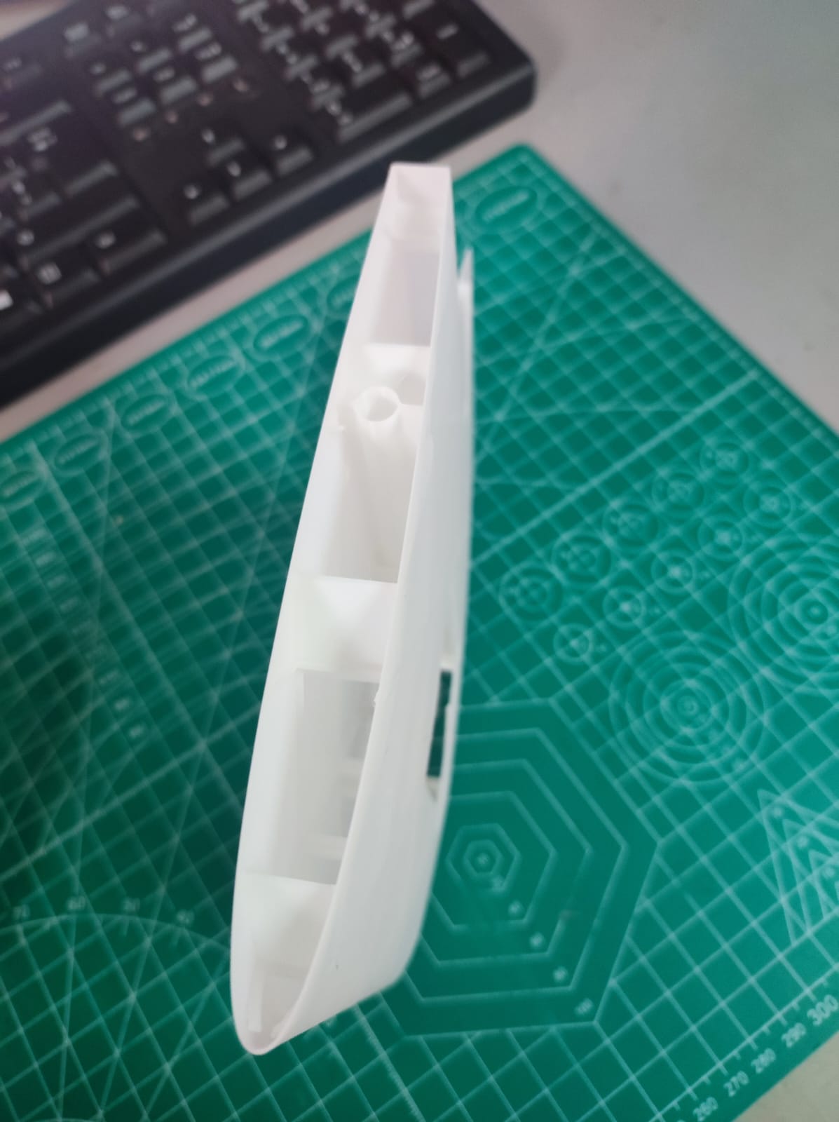

hi John following your instruction and studying an alignement between simplify3d and Orca I’ve obtained this with the K1 Max. The advantage is that 2 pieces can be merged in one so the printing time is the same but the pieces are the half and the structure is more strong. Orca is really better then creality and can be linked directly to the printer … simplify3D need Repetier Server. Thank you a lot.
