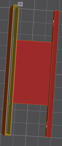

Hi forum,

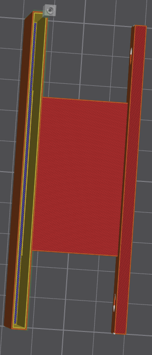

I have been successfully printing on my K1 Max for nearly a year now. But recently, Creality Print stopped allowing me to fill open voids. I can see the Sparce Infill Density, but when I increase it from 15% to anything above, like 75% it doesn’t change. The void is still hollow. Changing the patterns doesn’t help either.
Any idea what I’m missing here? It used to work great, then all of a sudden, one day it stopped. Thanks!
No one has any idea’s?
I just tried to uninstall the most recent version and roll back to an older one and that fixed it. Seems to be something wonky in the new version with my setup.
There is a new feature in preview that is call lite mode. when this is turned on the infill doe not show in the preview. The switch to toggle on/off is under the Gcode area in the preview.
