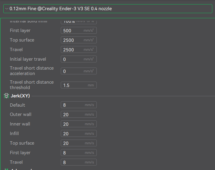

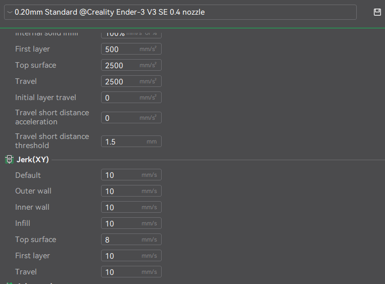

Hi There, i have a Ender 3 V3 SE and i use the Creality Slicer. I use all the default settings from the slicer, as it is from the same organization as the printer i assume they have all setup best than i can.
When i use the 0.20mm profile, nothing is wrong, but every time i try to change to the 0.16mm or the 0.12mm profiles i got this message:
Yes the warning is cropped and show no scrollbar.
Beside that i found it odd that the values change itself when changing profile, see:
0.20mm
0.16mm and 0.12mm are the same
0.12mm
Compare the “Top Surface” value… it is set to 8 in the 0.20 profile that works, in all other profiles this is set to 20… change it and hope for the best :wink:
It’s not strange that settings change when loading other profiles, the settings are saved in the profile!
I mean it is strange that the value change to one that is not allowed
… it probably was in one of the recent updates of Creality Print. If it works after changing this value, forget you had this “problem” and keep on printing…
