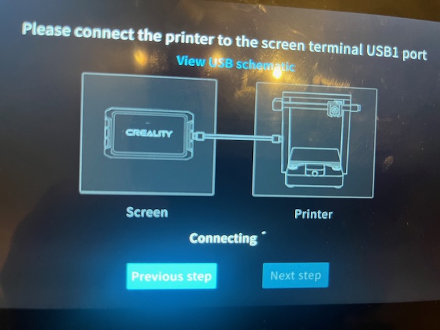

Just pulled out the printer plugin from the number one port and number one port came back ! Still getting this

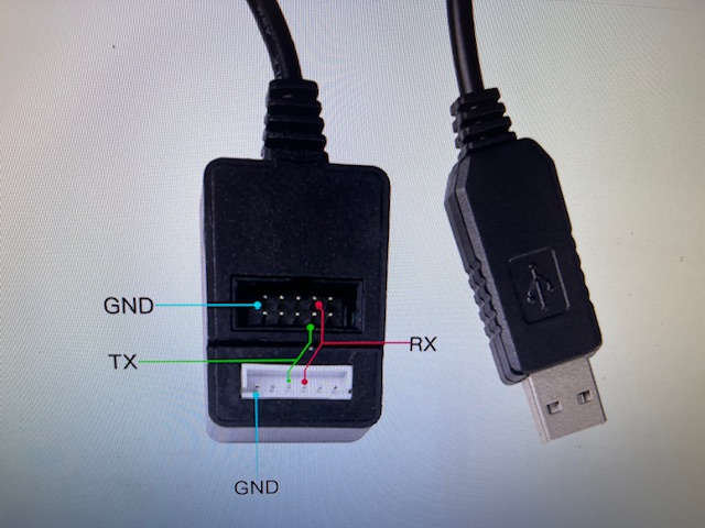

So looks like we should have got this grown up cable in the first place to stop all this misery ! This is it , 9 quid uk money I guess , heres the pics !Just been told my Creality Pad is no longer under garantie, as its been blitzed by my printer when it shorted out the board ! 1 year garanrtie on it ,Im2 months over !! Good luck all and watch out for that stupid mini cable connection !!

That’s the cable I use to connect my Sonic Pad to my V3SE, it’s a shame it isn’t bundled in with the pad.

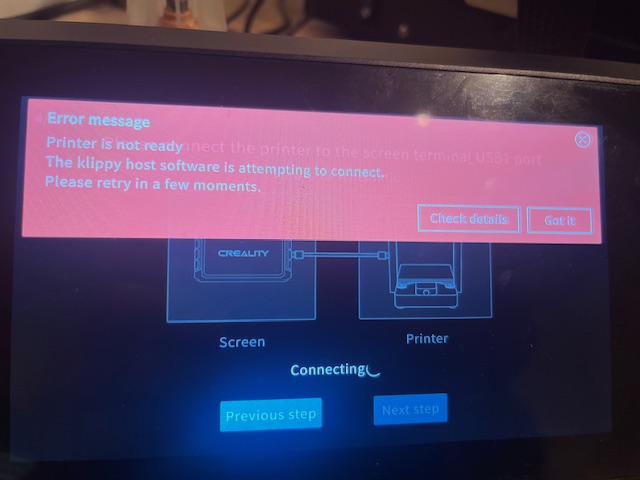

So got the new board from Creality ! Tried out the new usb cable and guess what it sparked !!! So after changing my pants ! I took the offending usb out switched off took the bottom off the printer no burn marks ! And then put in another usb in with the printer switched off , I put it in and the printer wont run ! The fan moves a millimeter and stops lights out zero ! THEN ! I put the original cabel that came with the Sonic pad put the adapter end on , that screwed up last time , I ofcourse tested on my friends Creality printer it was perfect , and it runs !! BUT ! Loaded the program on the stick looks all good , only recognises the number 4 port , tells me its loaded and can now tranfer the card to the printer and watch as the Sonic pad and the printer talk to each other ! Nope , just these messages ! Will wait now for my new Sonic Pad and that special cable and see what happens !! I havent had so much fun since I broke my leg !

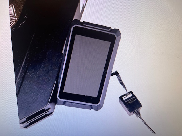

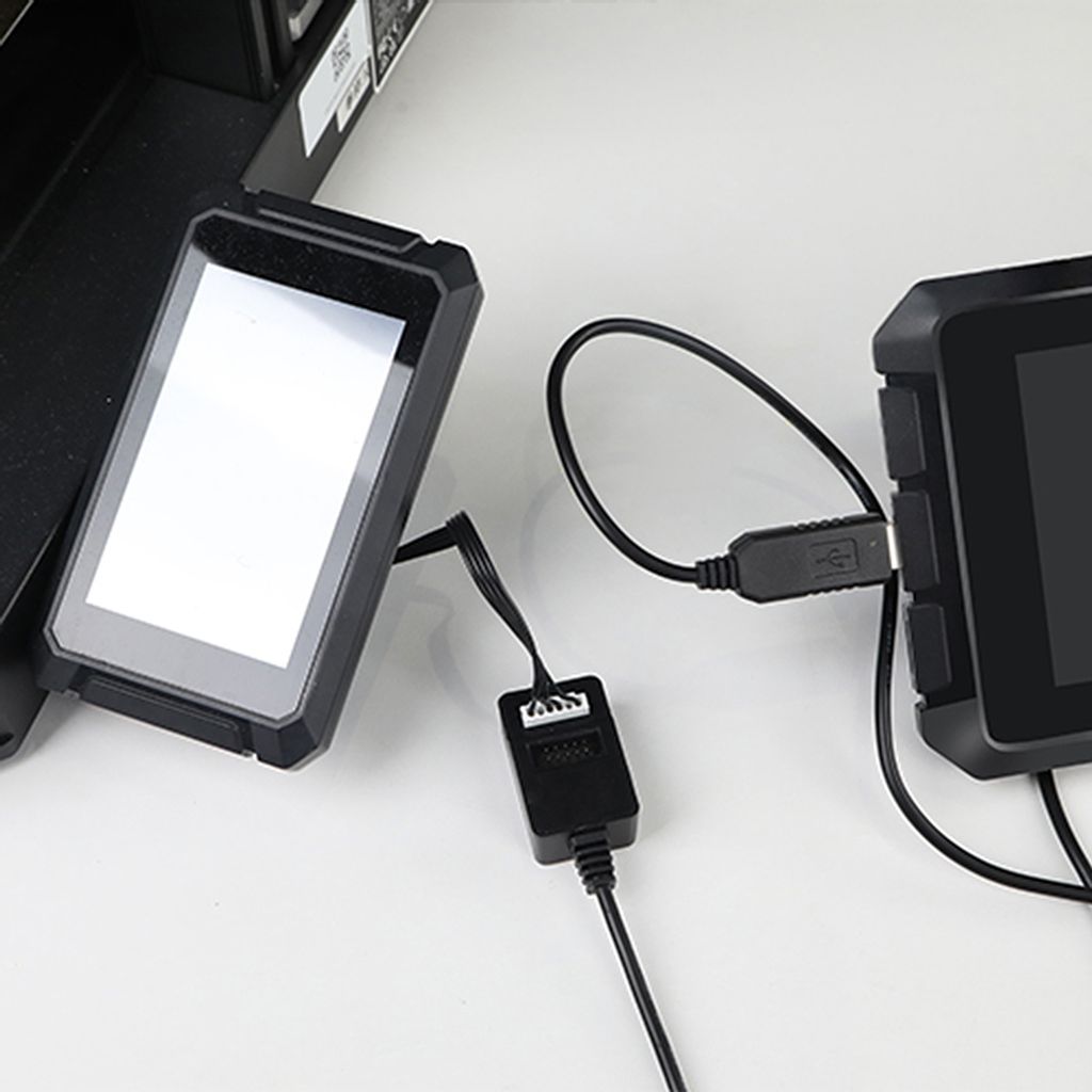

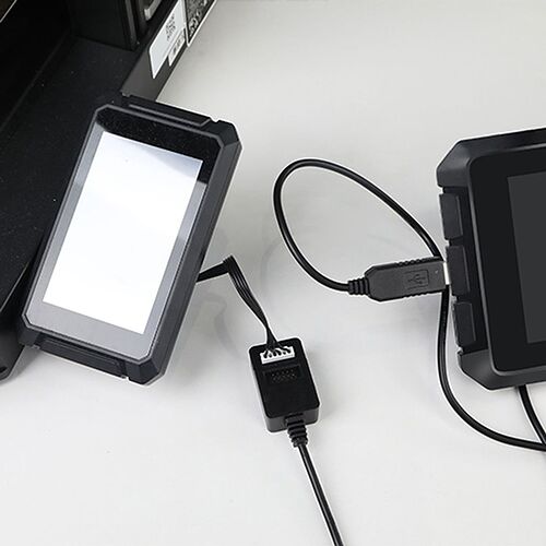

OK, bought a Sonic pad and adapter cable ( Actually, the adapter cable came with the unit ! ) So, do I just hook up the sonic pad with the 4 conductor cable that was plugged into the original display and not use a USB cable at all?
If it is the same as my V3SE the answer is yes. You may have to write the firmware to an SDcard first and flash that to the printer first. The sonic pad should guide you through the process.
