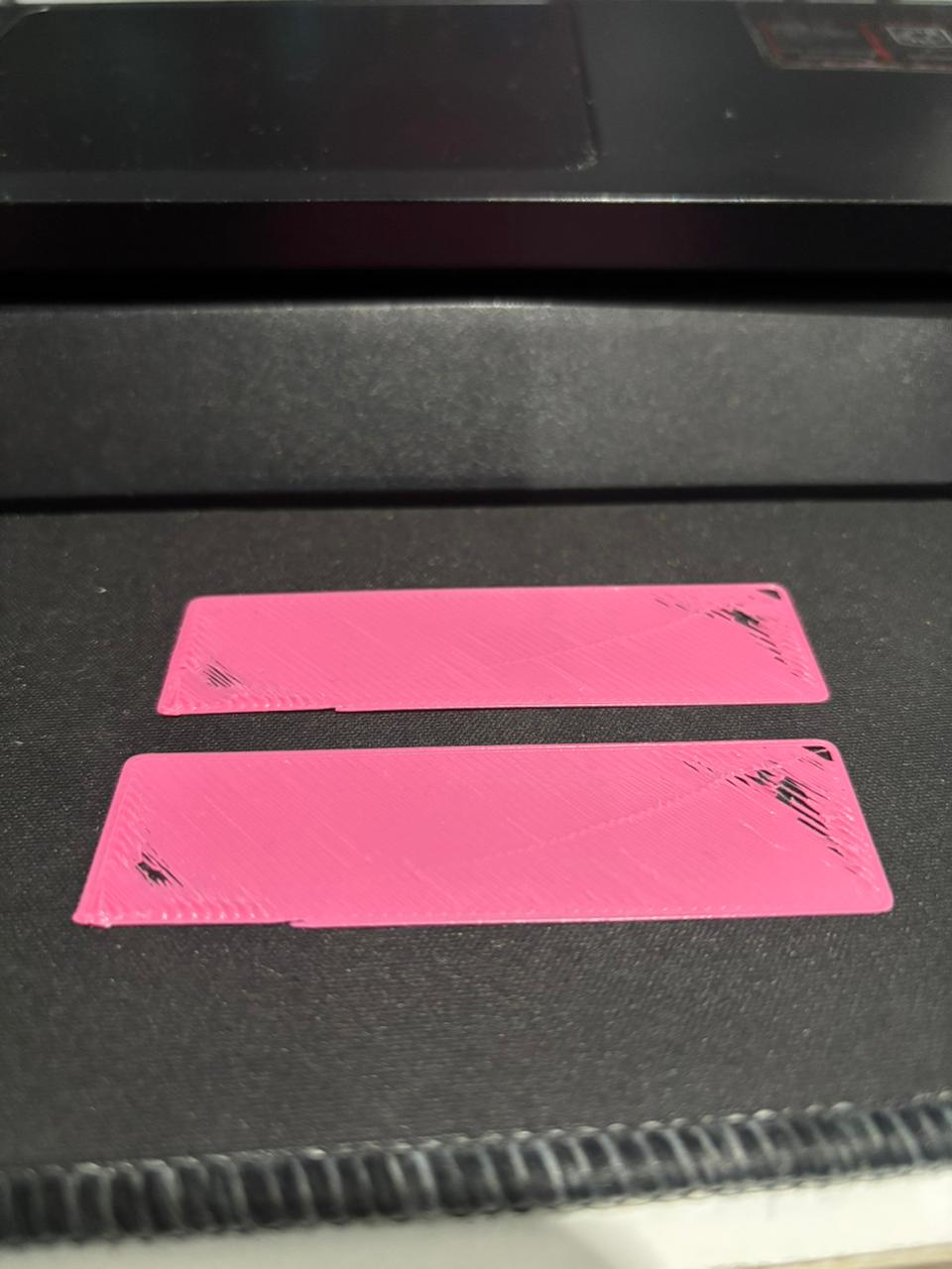

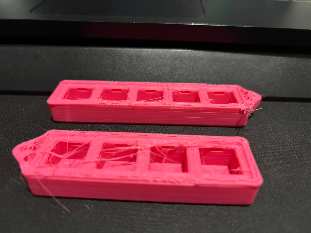

Hi guys, my ender 3 V3 was printing normally and no problem with the first layer, but then half way through the print, the print failed.
after that I stopped the print, did the auto bed leveling, and try to reprint but now the first layer has some issue
anyone can help me fix this problem?
Seems like a Z axis offset setting. Your filament must be closer to the bed so it can spread evenly.
Don’t trust the auto leveling function of the printer for the Z Axis value.
Check this video
Also check your temperature for the filament and bed. Usually a couple degrees higher solves a lot of the problems.
Have you check if your printer is under extruding? You must calibrate it if that’s the case. Please check if you have under extruding issues.
Today, I tried auto leveling it again and did a test print before trying out your suggestion.. somehow the first layer prints perfectly again. But thanks for the suggestion, I will keep that in mind whenever this happens again.
