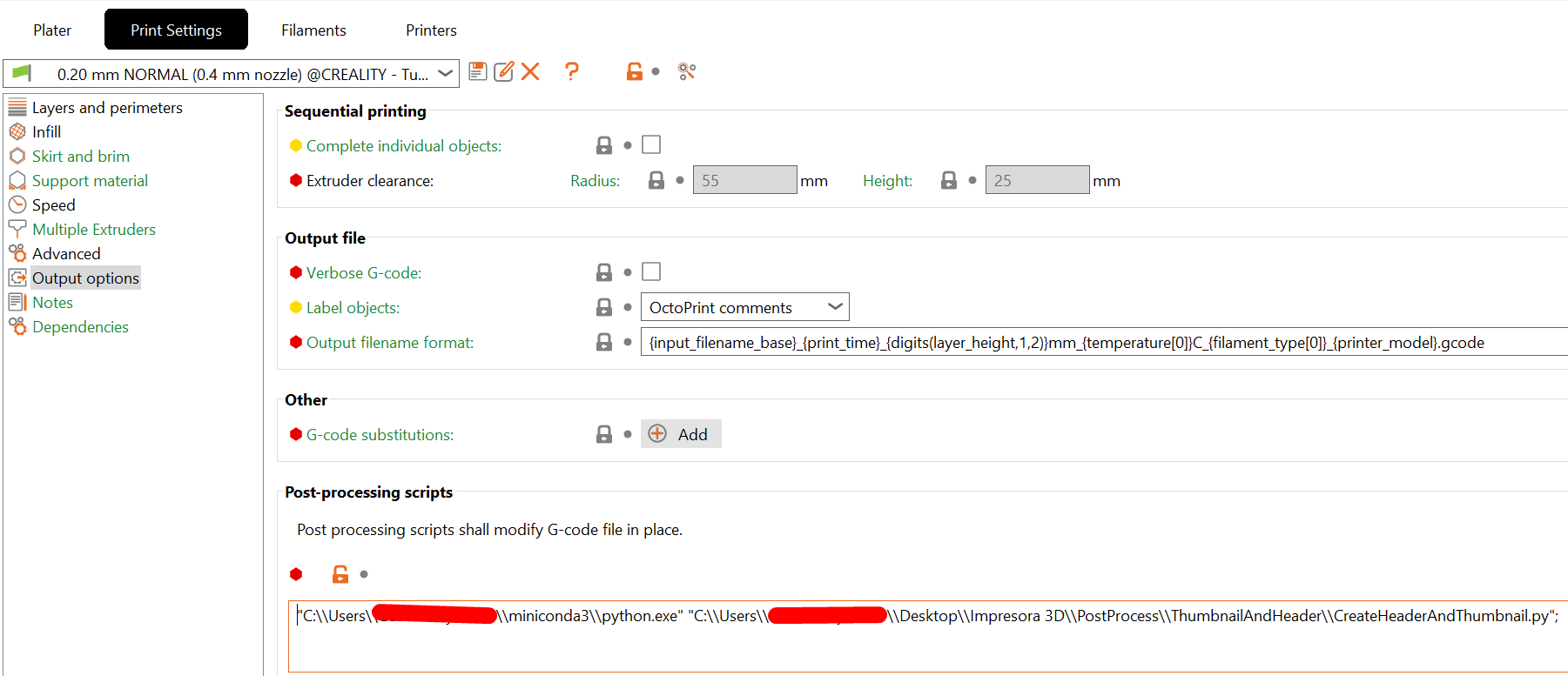

Hello! I would like to fix the thumbnail problem on my Ender 3 S1 Plus but I cannot find where to put this code. I am using Prusa Slicer (version 2.8.1). From your instructions it suggests I need to download “Pillow”? I know there is a “G-code thumbnails” setting under the “Printers” → “General” tab, but I have no clue what to set the picture size to. I am very new to messing with Gcode so I am grateful for any help.
You need to write the following under “Print Settings” > “Output options” > “Post-processing scripts”:
"full/filepath/to/python/interpreter" "full/filepath/to/postprocesing/script"
or
"python/interpreter/environment/variable" "full/filepath/to/postprocesing/script"
like so:
This setting is “Print profile” specific, meaning you will have to copy and paste the text in each print profile you use
Ok, a little progress, but I still have issues…
I copied the code from post 16 and pasted into Notepad. I saved as a .py, created a folder and stashed the file in there. I then copied the filepath,
“C:\Users\user\Documents\thumbnailfilefolder\thumbnailGcode.py”,
and pasted it into the “Post-processing scripts” area. In the post above you stated that the “full/filepath/to/python/interpreter” is needed.
Do I need to download a python interpreter?
Also, when I attempted to export the file, I received a message similar to @Hromi:
PrusaSlicer has encountered an error
Failed starting the script C:\Users\user\Documents\thumbnailfilefolder\thumbnailGcode.py C:\Users\user\AppData\Local\Temp.15432.gcode.pp, Win32 error: 193
Thanks for the help.
You need a python interpreter to run the script
The error you are getting is because prusaslicer is trying to execute the python script without an interpreter
