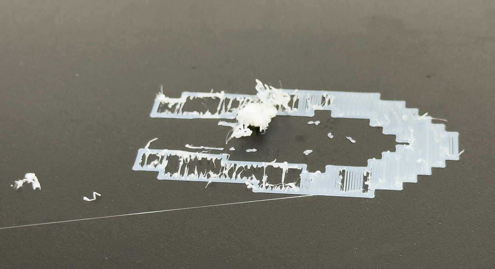

I used the H1 hot end as you suggested and include the 10mm brass tube. I re-ran all calibrations except the Z-offset which the printer console would not let me run. When I installed the filament again - the same Creality PETG I had been using last week - the printer immediately started ticking when extruding. I tried printing benchy but gave up after the first few layers as the print was a mess.
Any thought as to what I did wrong?

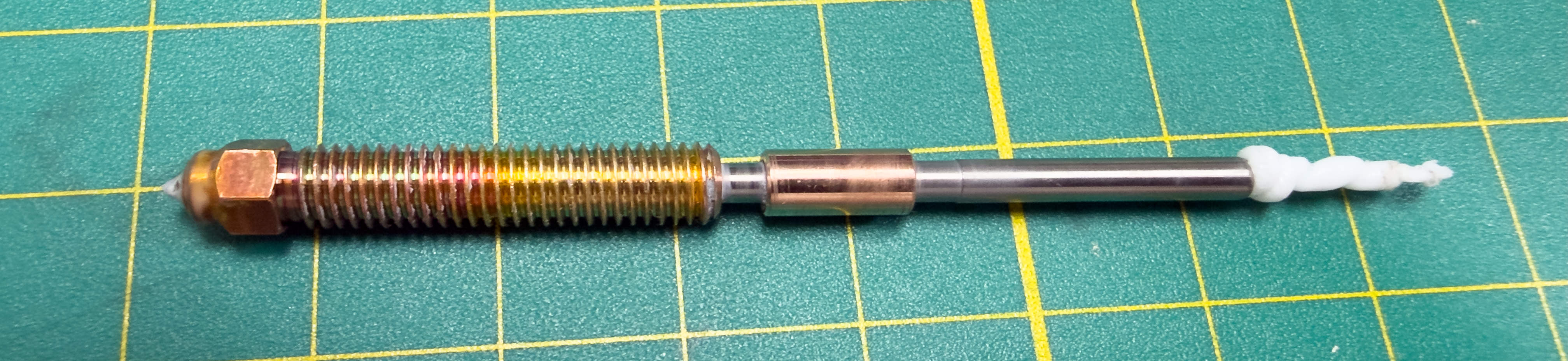

I just re-read your original post LoriAnn and realized that I did not re-run input shaping. Once I’ve cleared the jam I will try that and see if it fixes the issue. But first I have to clear things out :stuck_out_tongue:
I gently heated the end with a torch and was able to remove most of the filament from the tube. More importantly I pushed a new piece into the tube and was able to get a nice clean thin stream coming out of the nozzle. So I think I’m back where I started - but still need to figure out why it won’t extrude for me.
I did use the heater coil and thermister from the H1, not the Ender, and recalibrated them using the console. I assume that they use the same thermister across most models so hopefully I don’t need a new temperature curve for that.
I used the exact brass tube that Barry had suggested and cut it to 10mm +/- .1mm. I cleaned the cut end and it slipped cleanly over the nozzle. I also used a generous amount of thermal grease on the nozzle.

OK - this is embarrassing. I must admit to a bit of operator error. In my care not to strip the threads I failed to tighten the bolts that hold the heater to the ceramic block fully with the result that it was able to wobble a little. I’m sure that explains the horrible print but …
It still ticks and will not feed …
Help please!
