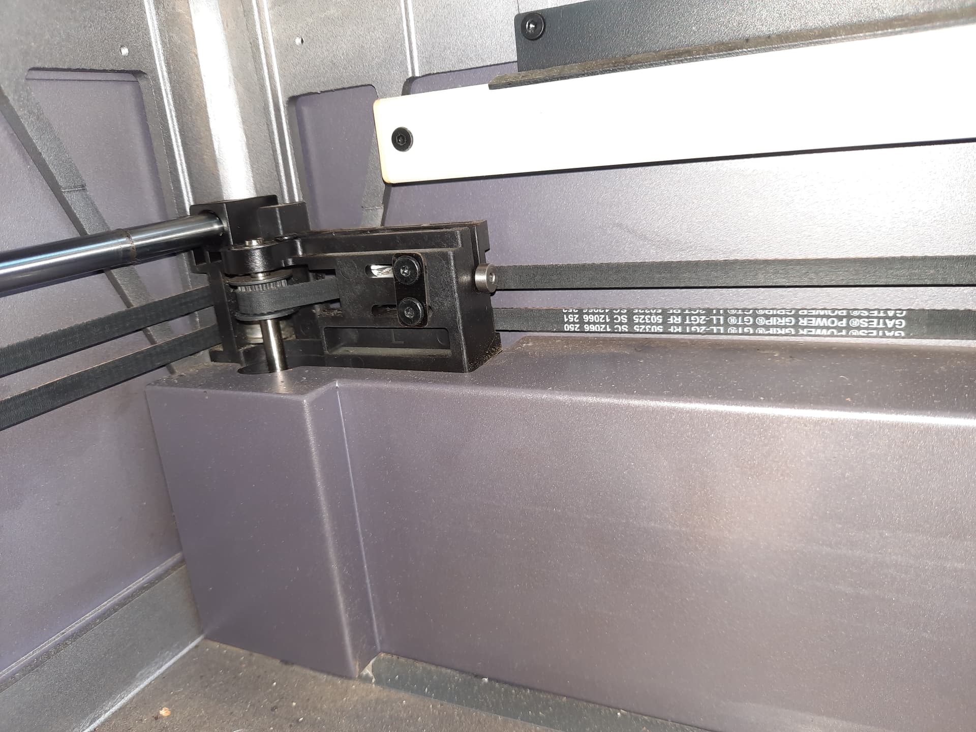

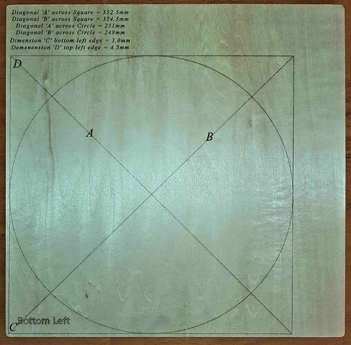

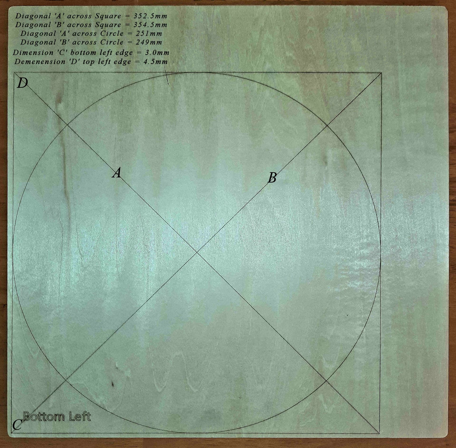

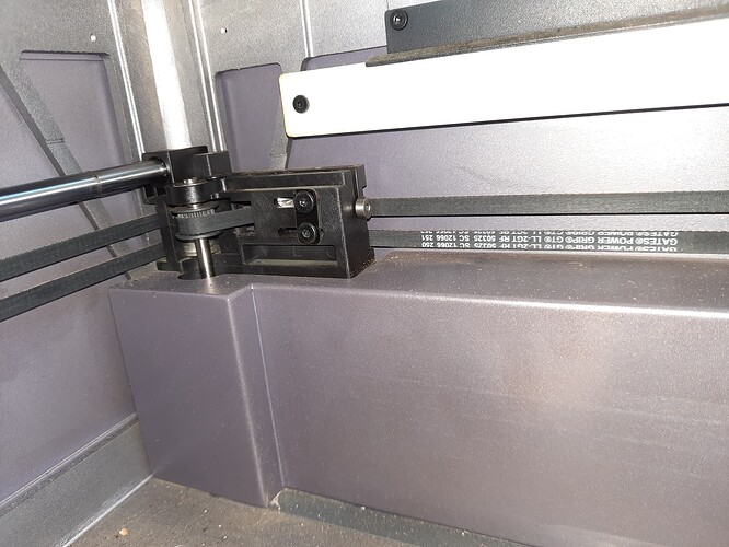

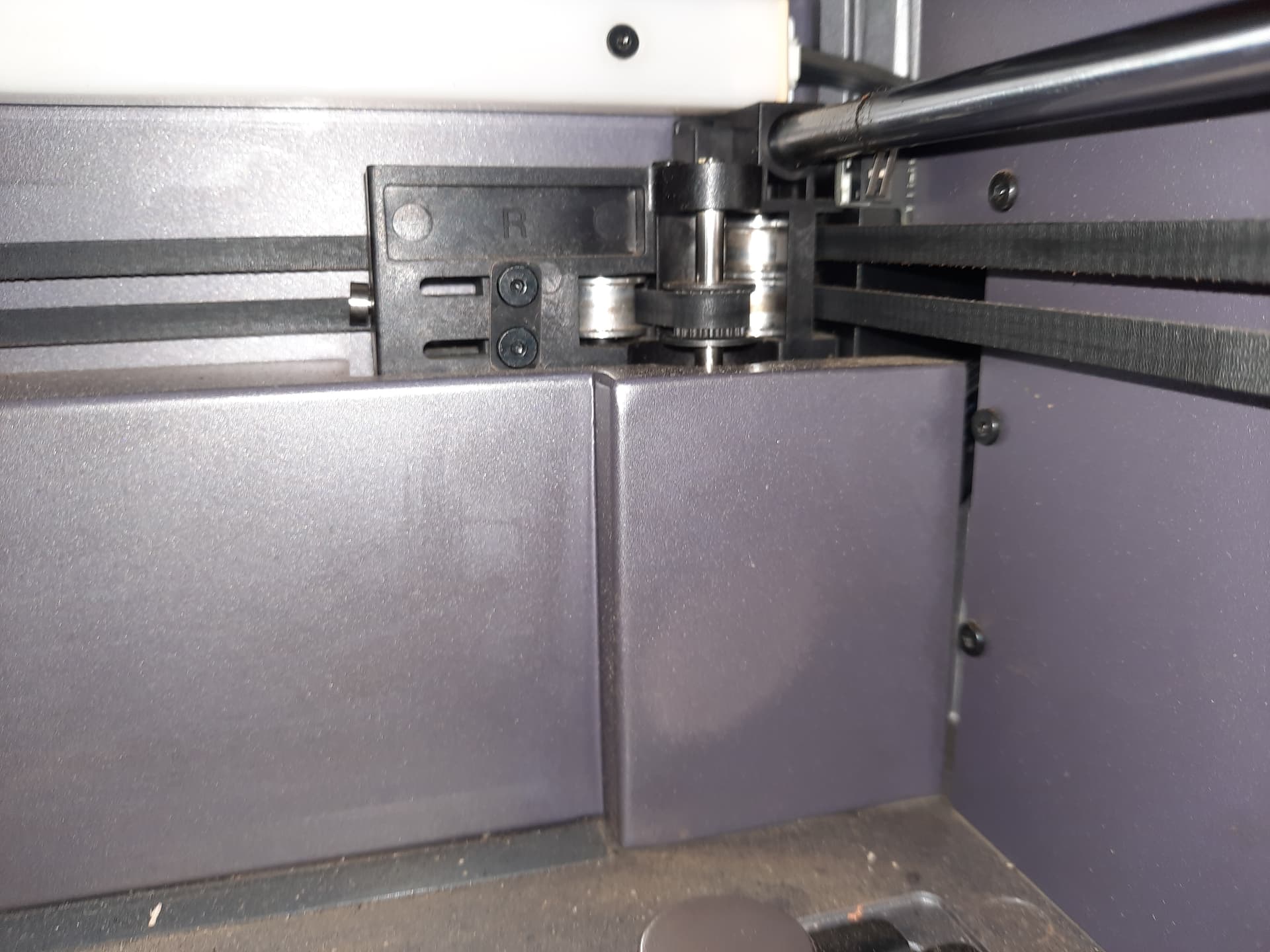

As my skew was to the right, see photo of test cut, I decided to exert more tension on the right belt tensioner and less on the left, again see photos attached.
Now, for me, this corrected the skew to a state where if I cut a square, I could turn the blank through any angle, 90,180 or 270 and the blank would fit back into the hole. Before, this was not possible.
So, what I suggest is try adjusting your belt tension, biasing it towards the lean of the skew. Bearing in mind, if you do not have enough adjustment, you may have pull the belt tighter at the other end, at the laser head, by slacking of the belt pressure plate and moving it tighter by one tooth on the belt.
