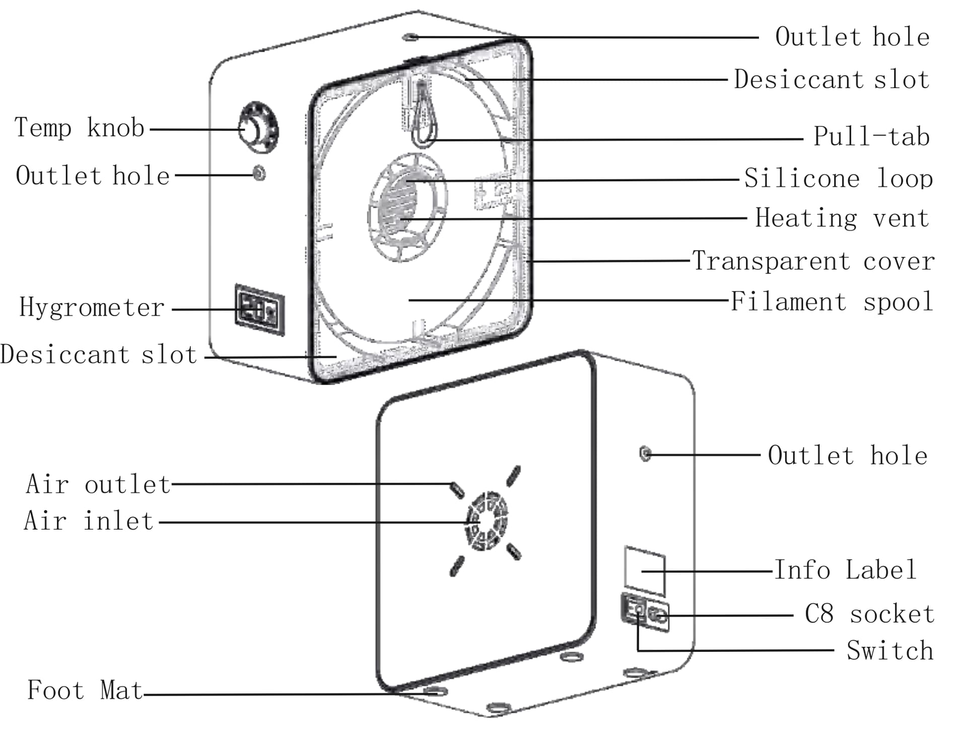

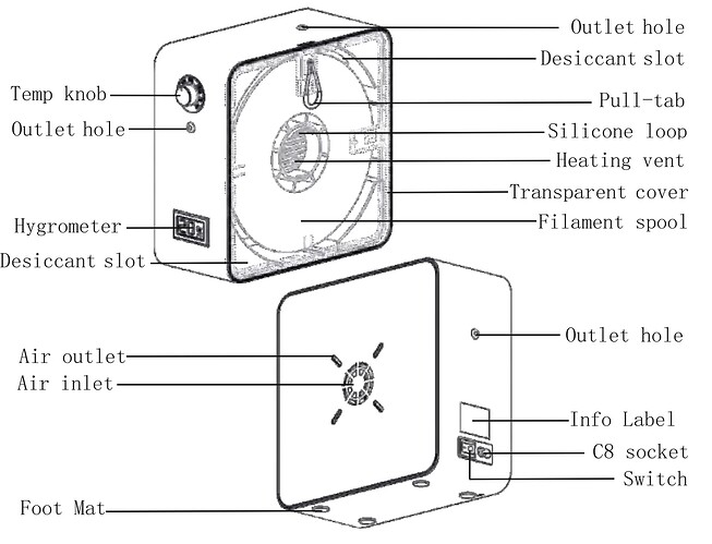

Thanks to R_D and everyone on this thread, I’ve just ordered one of these:
whose instructions warn to keep hands away from the hot air outlet:
It’s a very simple ‘open-loop’ machine - no timer and no thermostat - but it’s very compact, very low power consumption, does well in review trials, and has filament outlets in refreshingly sensible places.
And it cost less than the spool I’m going to put in it !
David
Hello Tuppenced,
That looks like a good solution.
Also good that it has places for Silica gel bags.
The humidity display is also a very good feature (note that the accuracy is likely to be around 1~ 2%, that is plenty close enough. Greater accuracy would involve a sensor that would make the price of the drier double).
I would be interested to hear feedback from you after using it for a while.
Cheers.

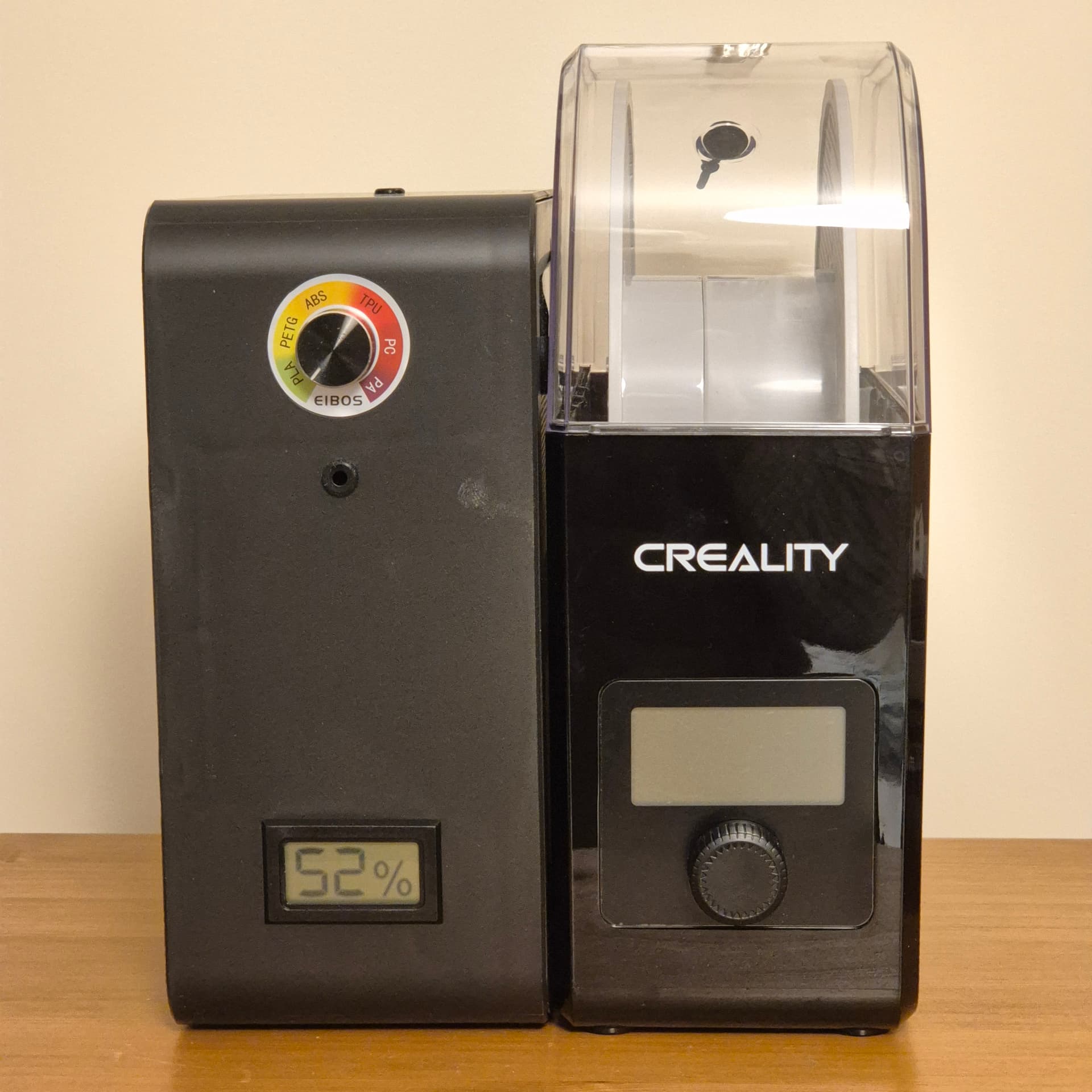

My EIBOS Easdry cost £32 including delivery from China to the UK.
It arrived in exactly a week, and I could track each step of its progess online.

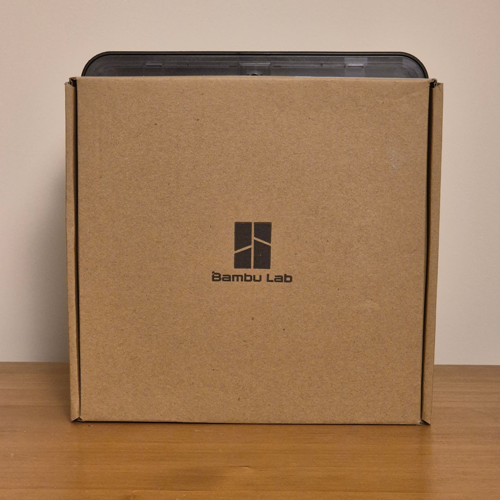

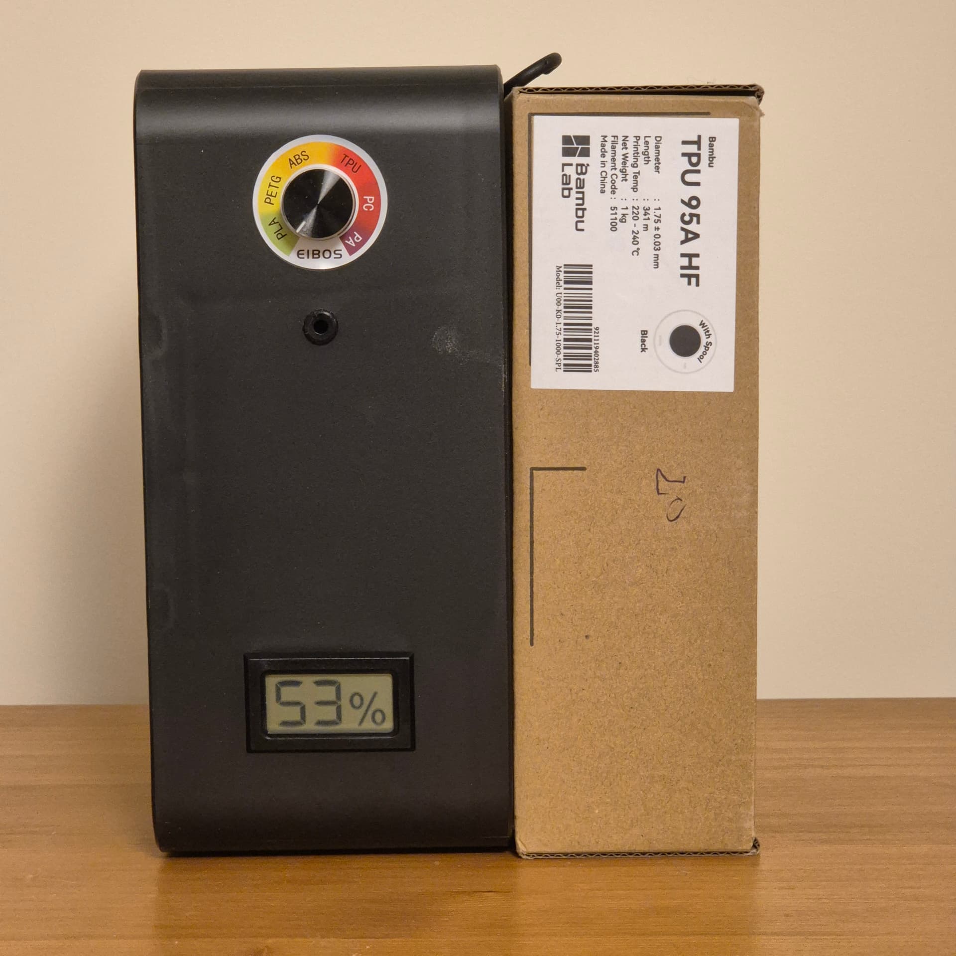

It is barely bigger than a spool box:
Comparing it with my Creality dryer:
Both take up the same space on a storage shelf, with the Eibos able to fit many a spool rack.
Both have the same type of detachable mains lead, which makes them easy to swop around.
(And if you want to back them up to a wall, you can add a cheap right-angle cable adaptor.)
On both, the on/off mains switch is annoyingly inaccessible, low at the back, beside the mains socket.
The top-loading Creality needs far less bench space, because the Eibos needs a lot of space on one side, to get the lid off and change spools, and on the other side, to allow air in and out of the side ports.
( Whether this matters depends entirely on what else is competing for space, and whether the hot air could cause harm.
To take an obvious example, a block of four Crealities could make a neat AMS for my Bambu A1 mini, while four Eiboses would need each need space to breathe.)
The Eibos is very significantly quieter than the Creality, both in volume and in harshness.
At 1 metre distance, the Eibos raised the average sound level in a quiet room from 20dB to 24dB while the Creality raised it from 20dB to 29dB.
(Whether this matters depends on what else is going on in the room - your printer may drown both.)
The non-thermostat Eibos will need calibrating before first use, because my mains is 245V.
The Creality doesn’t have the desiccant compartments that the Eibos has.
The Creality may need extra filament holes - and the starting point of this thread is that it may benefit from a closable air vent.
Eibos operation is necessarily simple (once calibrated):
Finally, the simpler Eibos was two thirds of the price of the Creality - your Tariffs may vary.
Because I already have a separate drying oven (vented, by the way), I shall only use them during printing, and not for pre-drying.
I’m pleased to have one of each.
