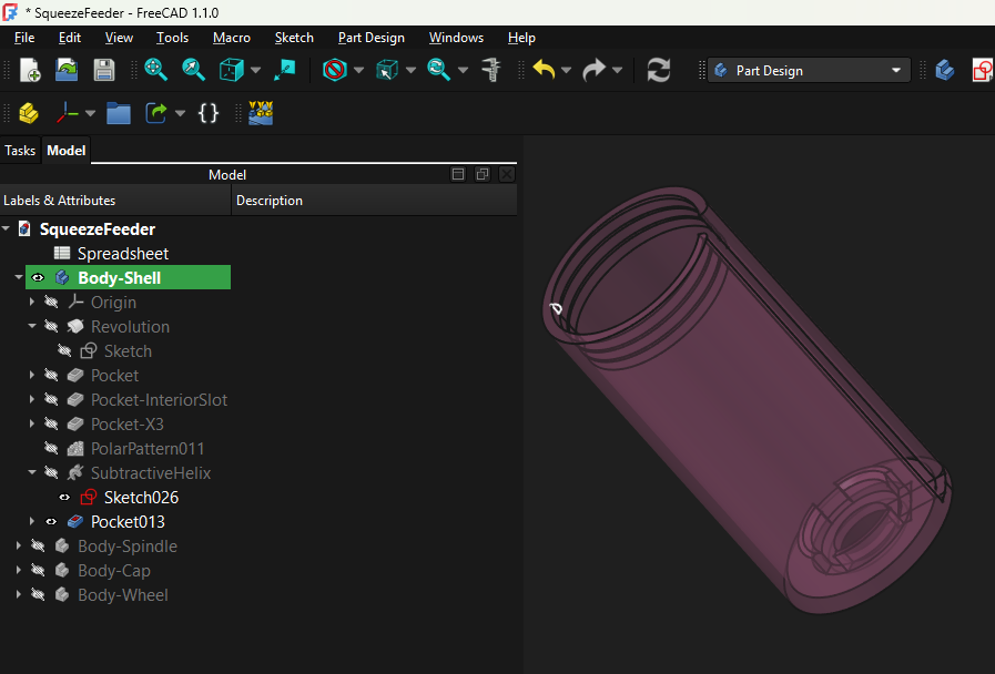

I’m running CP 7 and I’m having trouble exporting this 3mf file. attached are the images of the file, with no errors in FreeCAD, and the exported image in CP. As you can see the threads don’t come through.

MY error. I inadvertently used an Additive spiral in FreeCAD instead of a Subtractive spiral. The lines that you see on the model are where the base of the thread would be.
