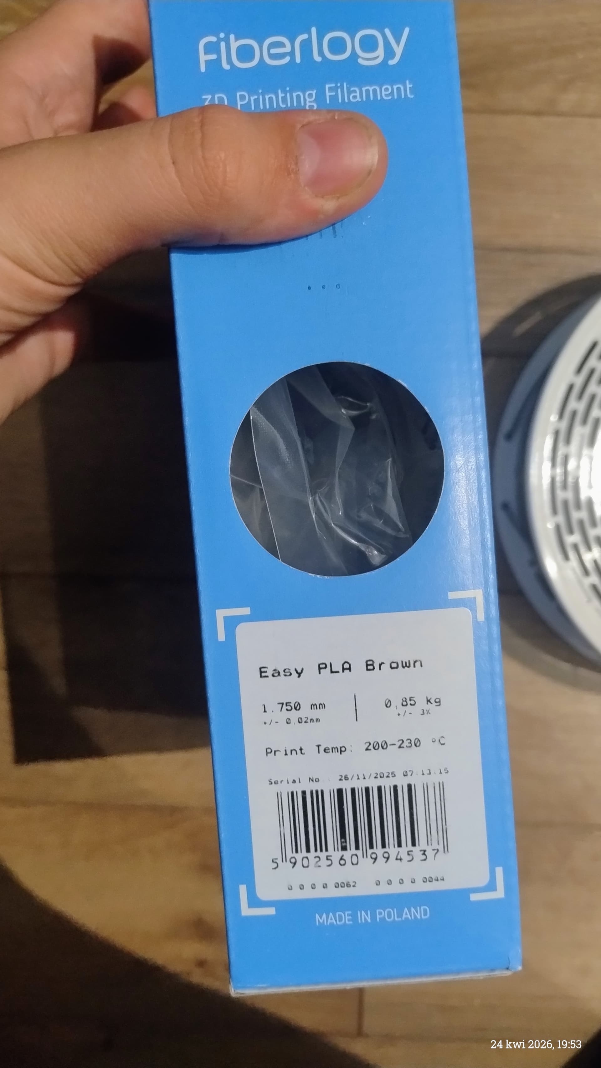

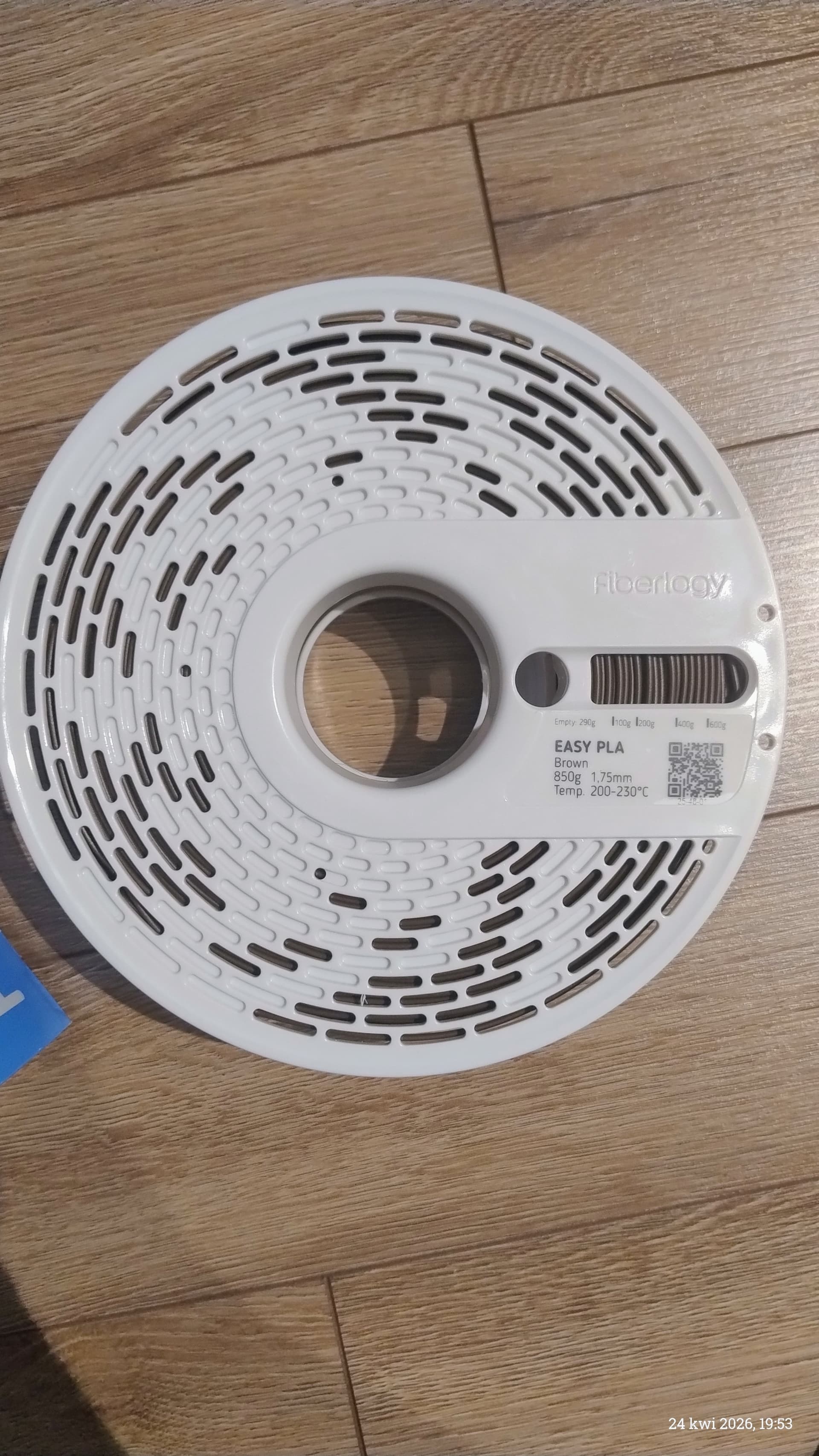

Good morning. I’m a new Creality K2 Combo user. I’m having a problem with one of the CFS filaments. It doesn’t slide well on the rollers. If possible, is it possible to print from both the CFS and the spool holder at the same time?
Fiberology has pretty wide rolls (i think 84mm where as the slot only allows for 70mm or something. Looks like you will need to use a spool rewinder and move it to a different roll. The height or diameter is 200mm which OK but some older Sunlu rolls were not big enough and so people have created spacers that make them work. The side to side width (sometimes called height) cannot be adjusted.
This is a known issue with AMS as well as Creality’s CFS.
to answer your question you cant print from the holder and CFS at the same time. The other reply covers how you can fix it.
