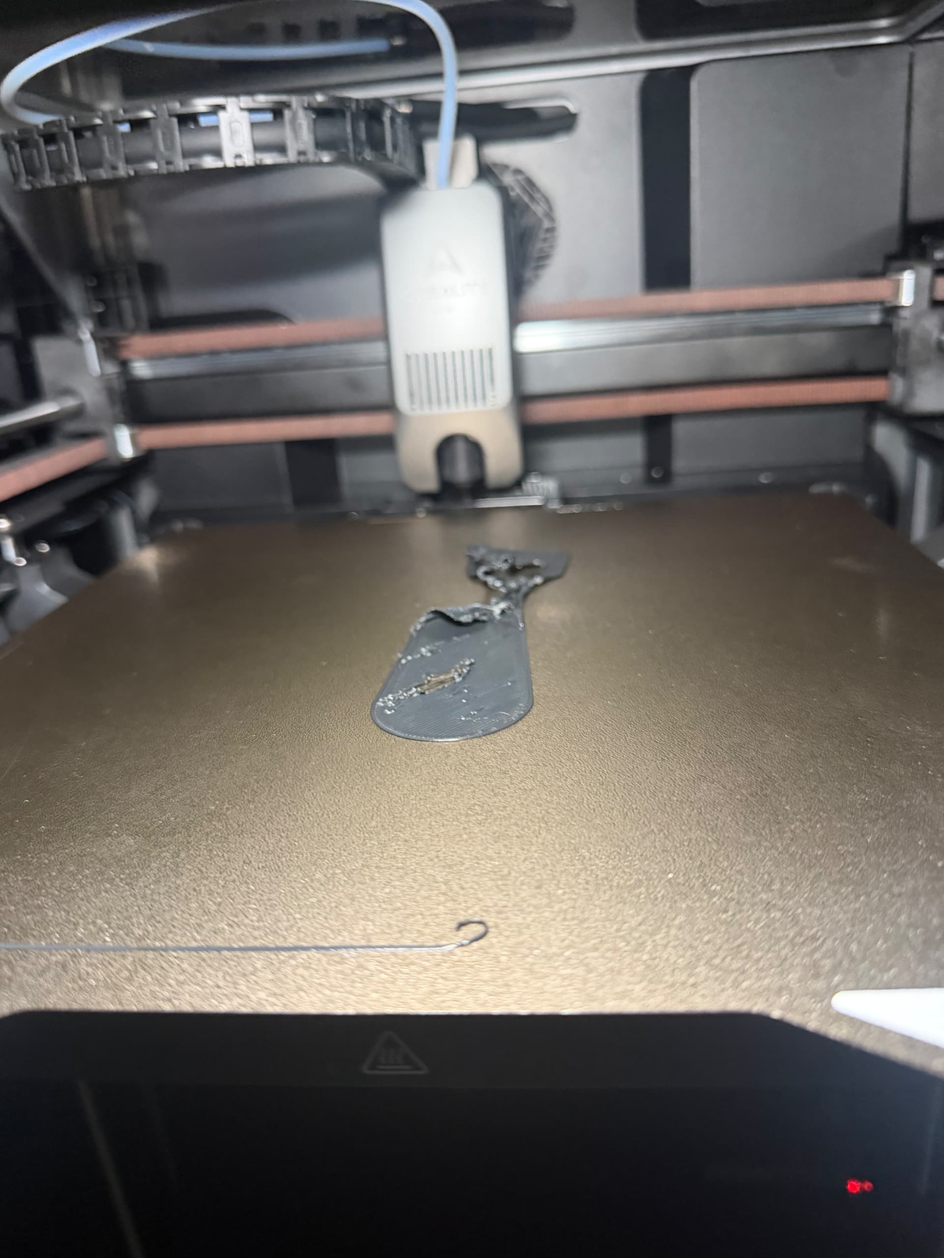

Help? Stuff is lifting and messing up prints
I’m new to 3d printing, so I don’t know what this is called (and I’M Sure this has been addressed!), but…
any ideas on how to fix this?
Hi, I recently got a Creativea K2 PRO printer.
  • First, you need to know what filament material you’re using. For example, I’m currently learning to work with ABS, and it doesn’t adhere well to the bed. (Solution: wash the plate in soapy water / use isopropyl alcohol to degrease / apply adhesive to the plate.)
  • Second, there could be a difference in the bed/plate level. Check that there’s no debris underneath the plate, which could cause the nozzle to rub against the plate during printing and lift the printed layer. (Before printing, perform all calibrations that can be accessed from the printer’s screen.)
I’m using Ender PLA from Creality.
I just unloaded and reloaded the filament and hit print on a file. It’s printing perfectly.
When it’s done, I’ll try printing it again.
This is where the problem usually happens. On the next print, if I don’t unload and reload.
