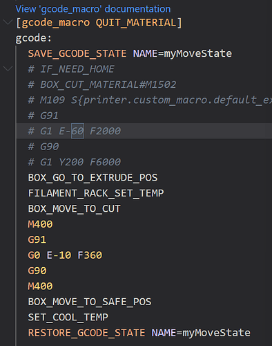

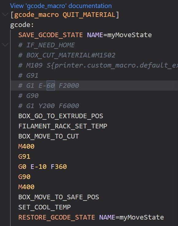

I just installed the DXC2 today, and went to change the firmware–only to find that the directions don’t match my firmware. I’m using V1.1.3.13 still (downgraded from the 1.1.4 version due to print failures). Which firmware version needs to be used to make the instructions work? Will this be an isssue each time there is a new firmware?
I took a picture of the only thing that almost resembled the first set of instructions–that looks like this. Is this the setting that needs to be changed to E-40 ?

Just remember that the 2 edits you make to help with retract get over written when the firmware gets updated. Had update today and thought it might rewrite everything so checked straight away and sure enough it had. Just edited it back and got on with prnting.

Hi. If you are referring to the changes in `box.cfg` and `gcode_macro.cfg` mentioned in the installation instructions, those are applied during the installation process. As I understand it, however, the changes relate to filament retraction and extrusion into the hotend.
