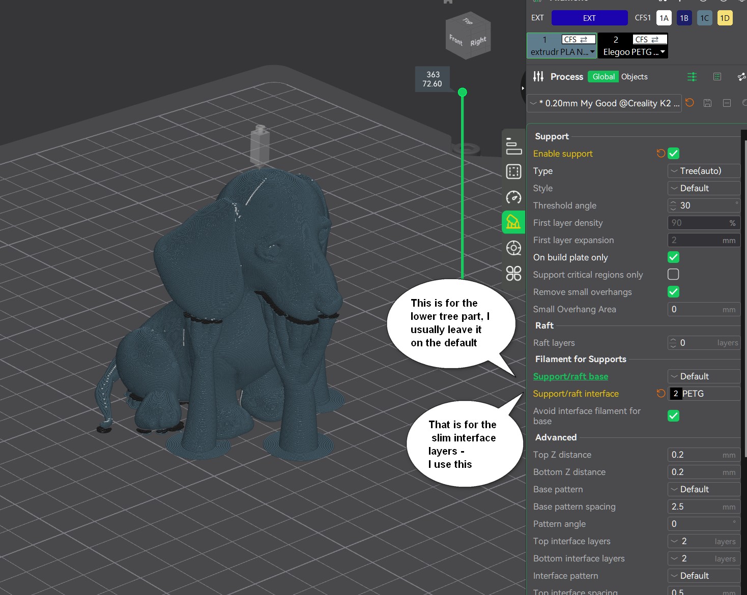

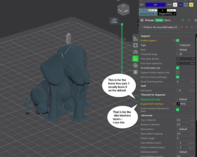

It’s in the support settings like below:
I made a post where I tested some of it.
p.s.: Could you maybe delete your second post about the same topic?
