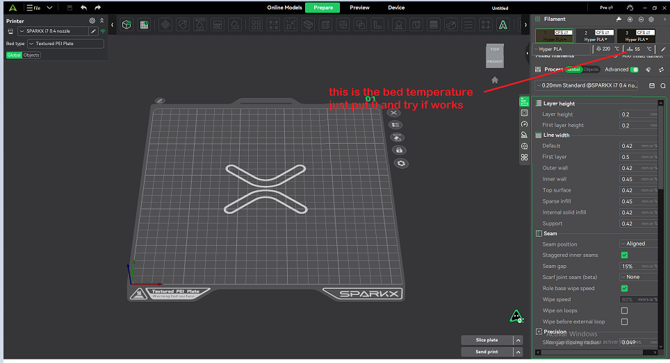

I took my printer in for maintenance and they told me it has a problem with the print bed temperature sensor. This sensor is registering 75°C at room temperature when it should actually be registering between 24 and 25°C. They said I can still print without a heated bed, and that I need to set the bed temperature to 0°C in the laminator. I’d like to know how to do that in the Creality Print laminator.
first you click here
the this wil pop up
and do what is say in the image, try, and tell us if it worked
when you click on your filament, you have the nozzle temp, and to the right you have the bed temp
anyways, what i say, if it worked, it’s a temporally solution, it is not a real solution, the solution it’s to change the pcb Bed, or the sensor of the bed, i dont know what must be changed, but something is broken i think
