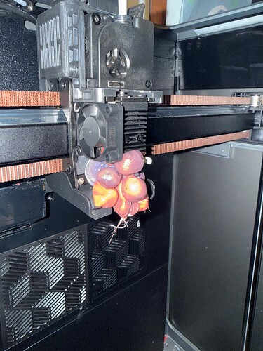

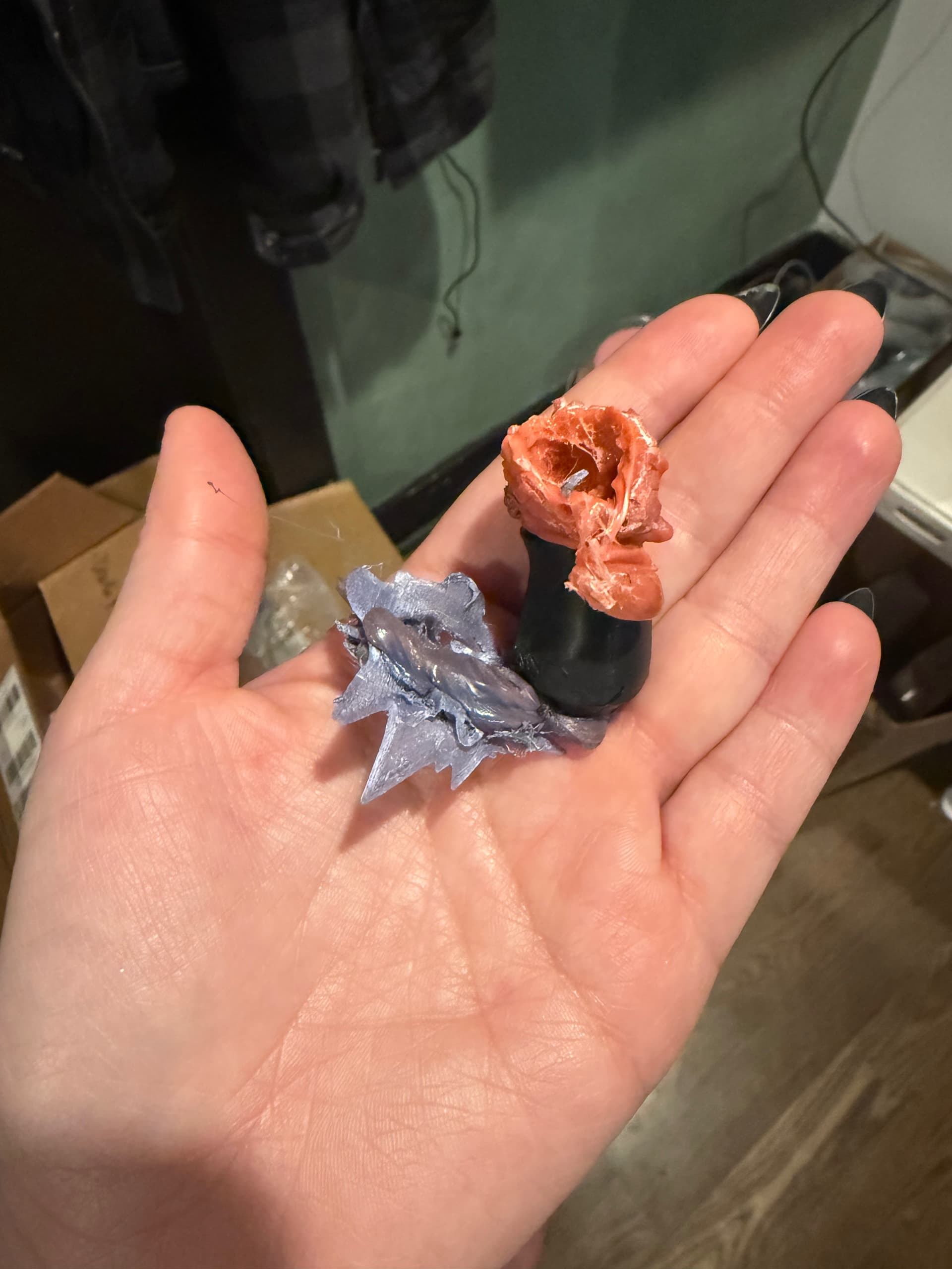

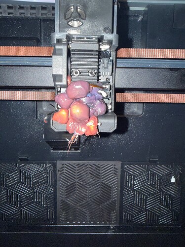

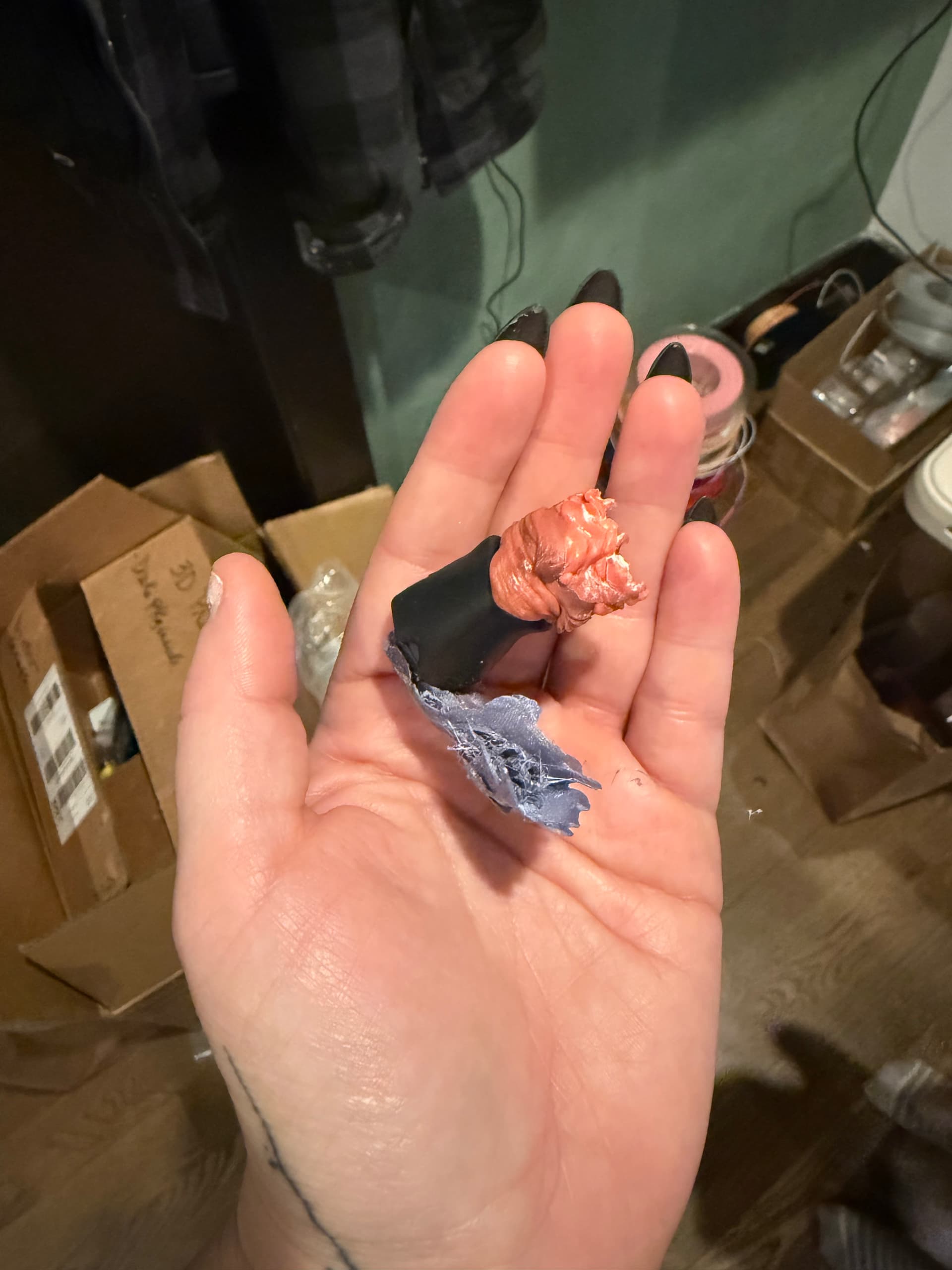

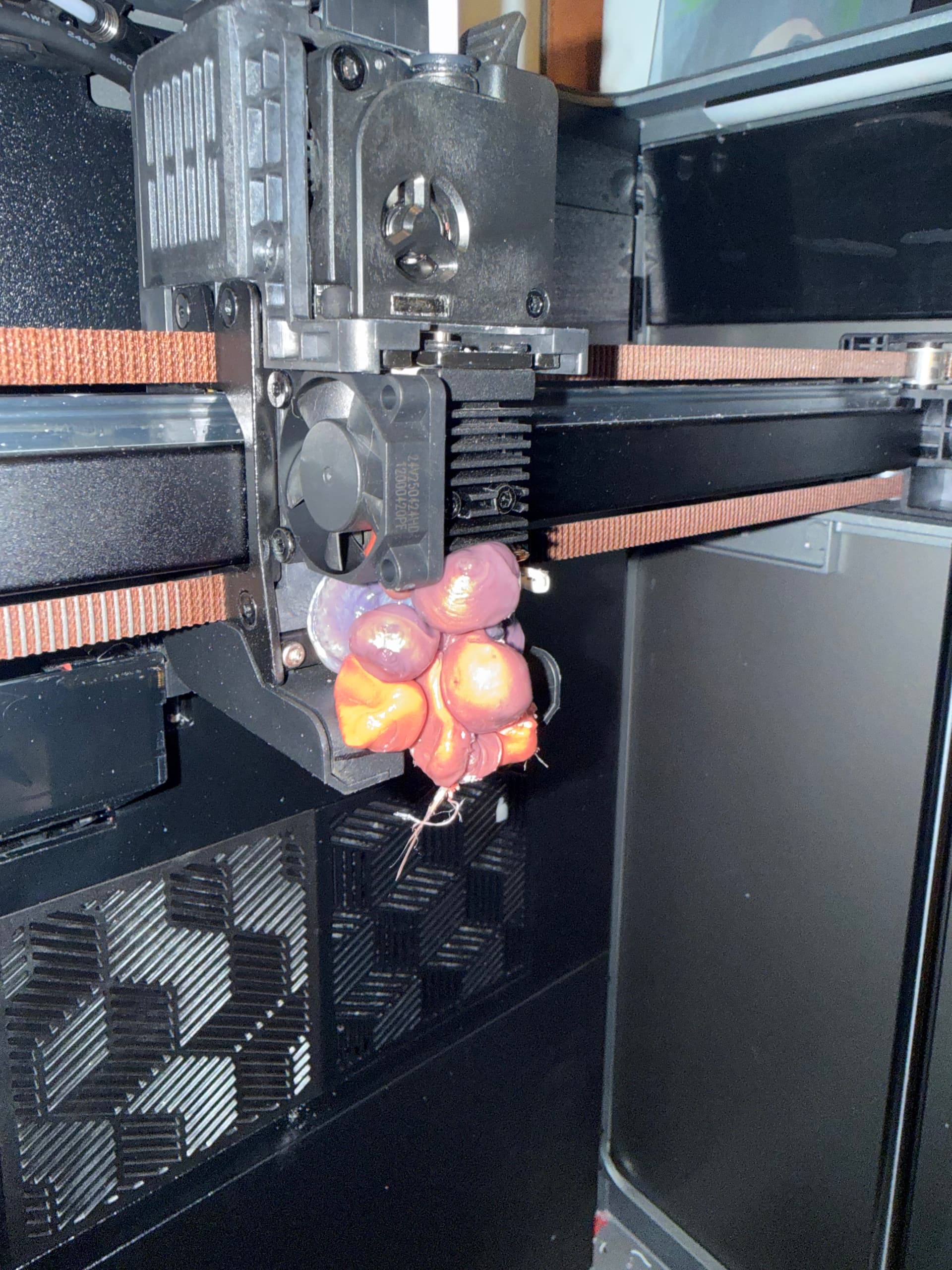

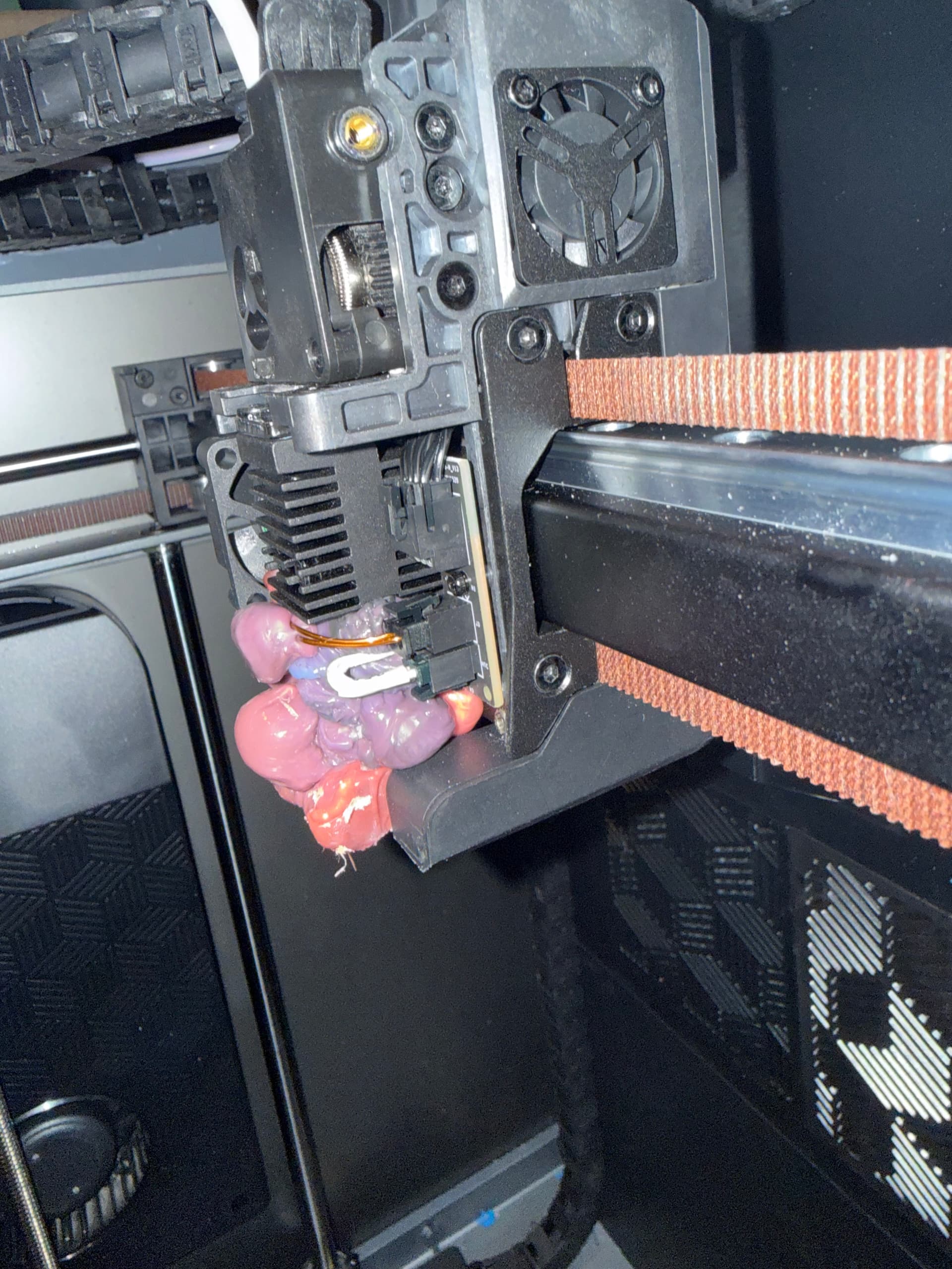

I woke up to a mess…
Help :sweat_smile: started a Pokémon print before bed, woke up to a nightmare
Thats not a Pokémon print but “The Blob Of Death”…
You have to check on a regular base if the hotend is still secure attached…
happens to all of us. First try to clean it up. need up the nozzle 220ish and start to pull pieces off. Be carefull of the small wires for the hot end. you can use a heat gun or hair dryer to soft it up. once you get the big pieces out of the way you can see if there is any damage. if not just keep cleaning it, it will take some time, slow and steady. if you dont want to take a bunch of time you can remove the hot end and replace it with a new hotend and nozzle.
Mac486
Thank you! I’m going to see if it will heat up at all. I think the melted filament is obstructing the fan. I get an error that says “Abnormal head break fan!”. Definitely going to see how far I can get with a hair dryer :crossed_fingers:t3:
