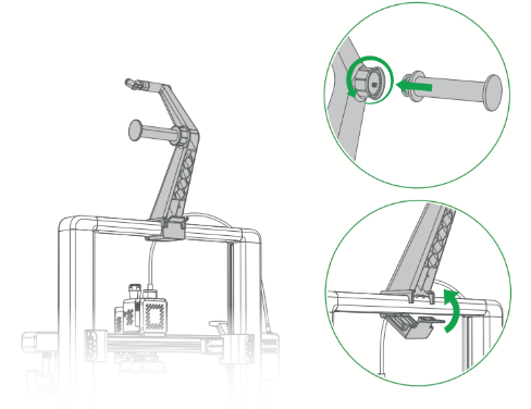

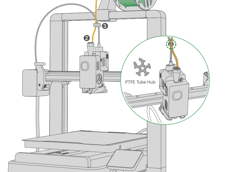

Installing the Spool Holder
Assemble the i7 external Spool Holder and mount it onto the Gantry. Connect one end of the PTFE Tube to the Spool Holder Filament Inlet, and connect the other end to any filament inlet on the Toolhead Manifold. Please secure the Toolhead Cable and the PTFE Tube into the filament hub to prevent damage during operation.

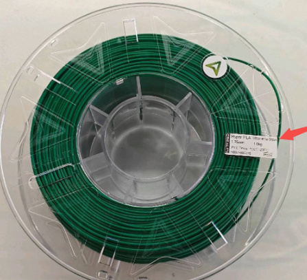

Filament Preparation
Prepare filament in advance. The filament included with the product is Creality Hyper PLA.
Load Filament
Place the spool onto the Spool Holder. The included filament can also be placed on the Spool Holder.

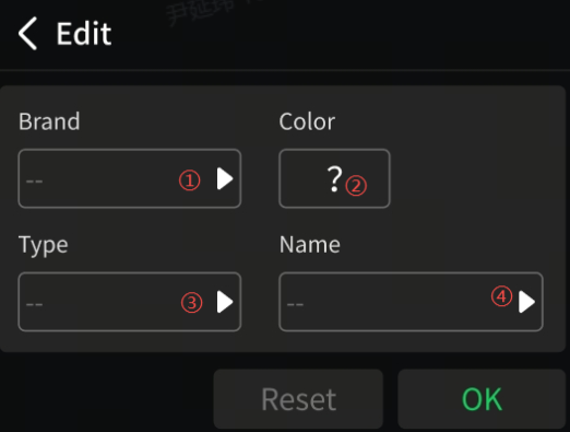

Filament Feeding

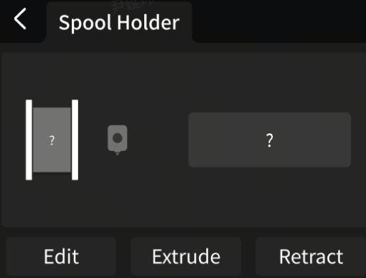

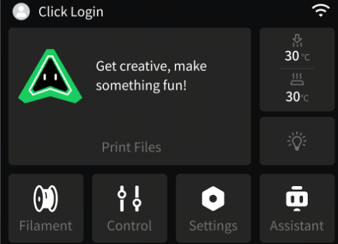

On the Printer Screen, tap Filament, then tap the Edit button. Enter the filament information and tap OK.

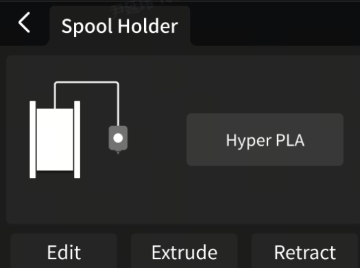

① The Toolhead will display a small white dot, indicating it has detected that the filament has been successfully loaded.
② Tap Feed. The nozzle will heat up to 240 °C, then start feeding the filament. At this time, gently push the filament again.
③ Observe the Nozzle. If the filament is extruded normally, the filament feeding is successful. Wait for the printer to complete the entire feeding process.
④ If the filament is not extruded properly, push the filament again until it is successfully extruded.

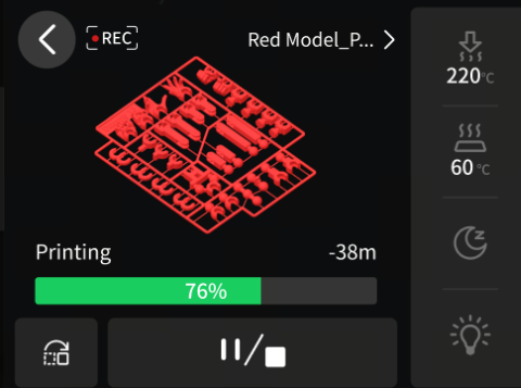

Start Printing
Before printing, make sure the Print Plate is placed flat and there are no foreign objects on it.

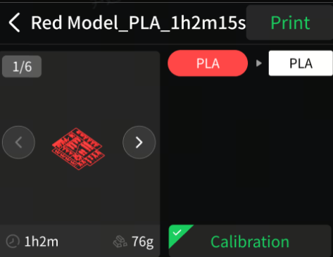

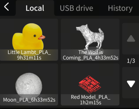

To start printing using the printer model file:
Tap Print File and select the model you want to print.
It is recommended to enable the Calibration option, then tap Print.
