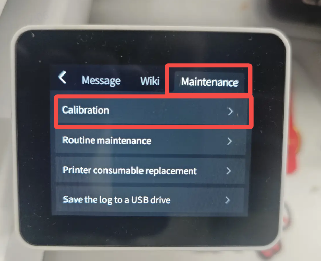

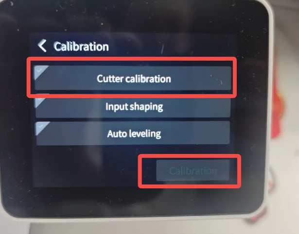

Abnormal filament cutting occurs (it is recommended to run Cutter Detection first);

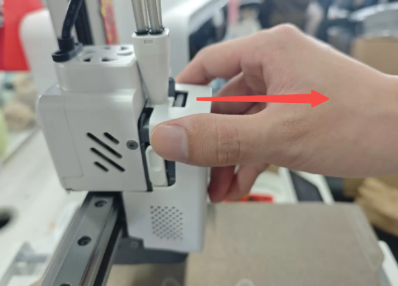

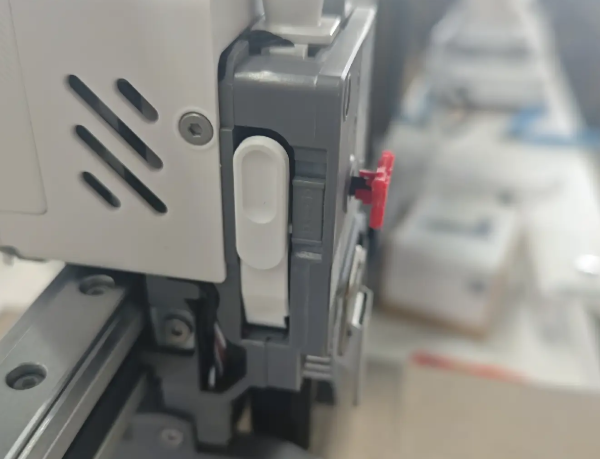

Remove the Toolhead Front Cover to expose the Toolhead Assembly;

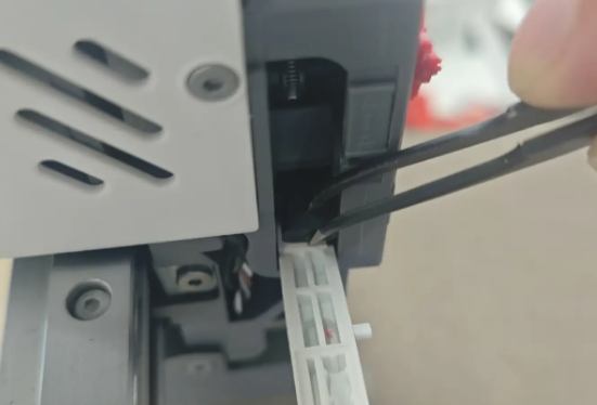

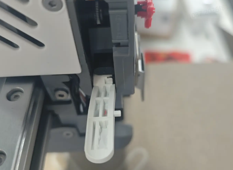

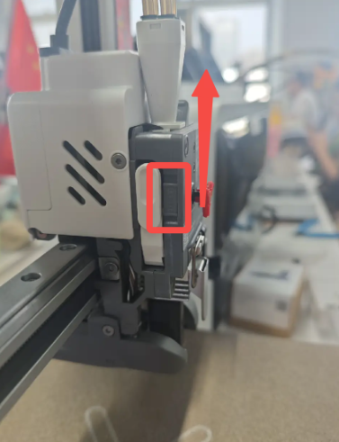

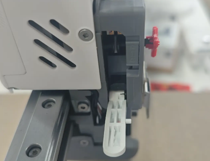

Locate the latch in front of the Cutter Arm on the left side. Push the latch upward; the cutter arm will automatically spring open;

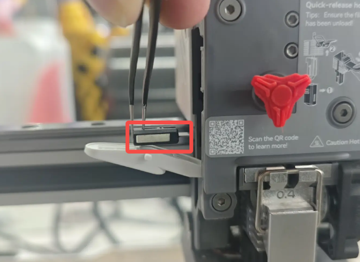

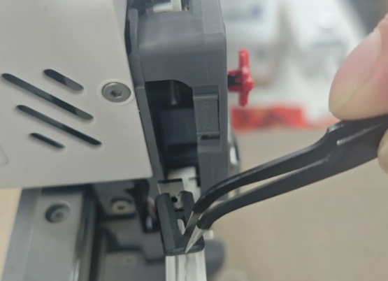

Using tweezers or a hex wrench, slide the cutter out from the rear toward the left side; Warning: The blade is sharp. Handle with care to avoid injury.

Prepare the new cutter and make sure the magnet side faces forward;
Insert the cutter into its original position. The cutter will be pulled into place by magnetic force;

It is recommended to run Cutter Detection to ensure the cutter is in the optimal position.
