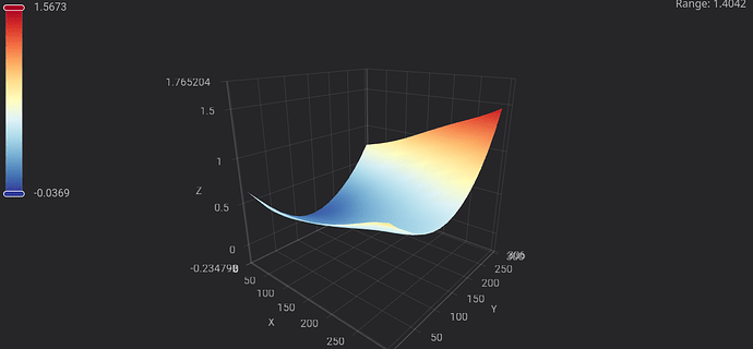

I have seen this is a issue for some K1 max owners a taco or potato chip shaped bed. I am wondering if there is any solution other than another several hundred dollars spent on a new tool plate bed?
09:20:44 $ BED_MESH_OUTPUT
09:20:45 // Mesh Leveling Probed Z positions:
// 0.626156 0.565656 0.565781 0.631844 0.744625 0.891469
// 0.256719 0.265500 0.336156 0.435213 0.545031 0.635062
// 0.071594 0.141750 0.234940 0.342398 0.410906 0.536000
// 0.117562 0.182071 0.314435 0.419663 0.537102 0.620219
// 0.343915 0.444031 0.538219 0.650494 0.784966 0.905063
// 0.742943 0.843500 0.985085 1.147750 1.297801 1.467321
09:20:45 Mesh X,Y: 16,16
Search Height: 5
Mesh Offsets: X=0.0000, Y=0.0000
Mesh Average: 0.52
Mesh Range: min=0.0631 max=1.4673
Interpolation Algorithm: lagrange

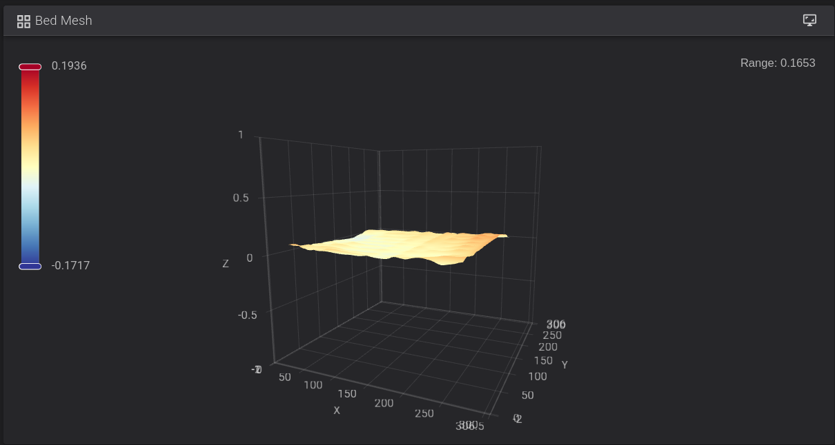

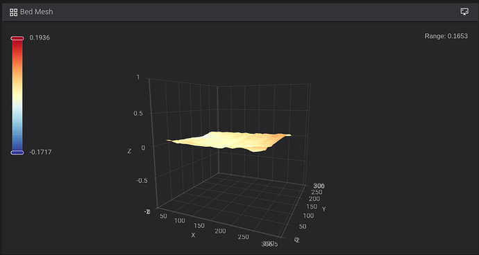

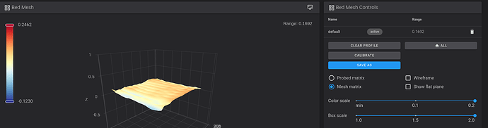

Figured I would post the results after my re engineering. Also don’t mind the ripples I’m sure thats oil canning from the PEI plate stamping process. Mesh taken with a BTT Eddy. thanks for reading
made a few more tweaks and going to call it good.
