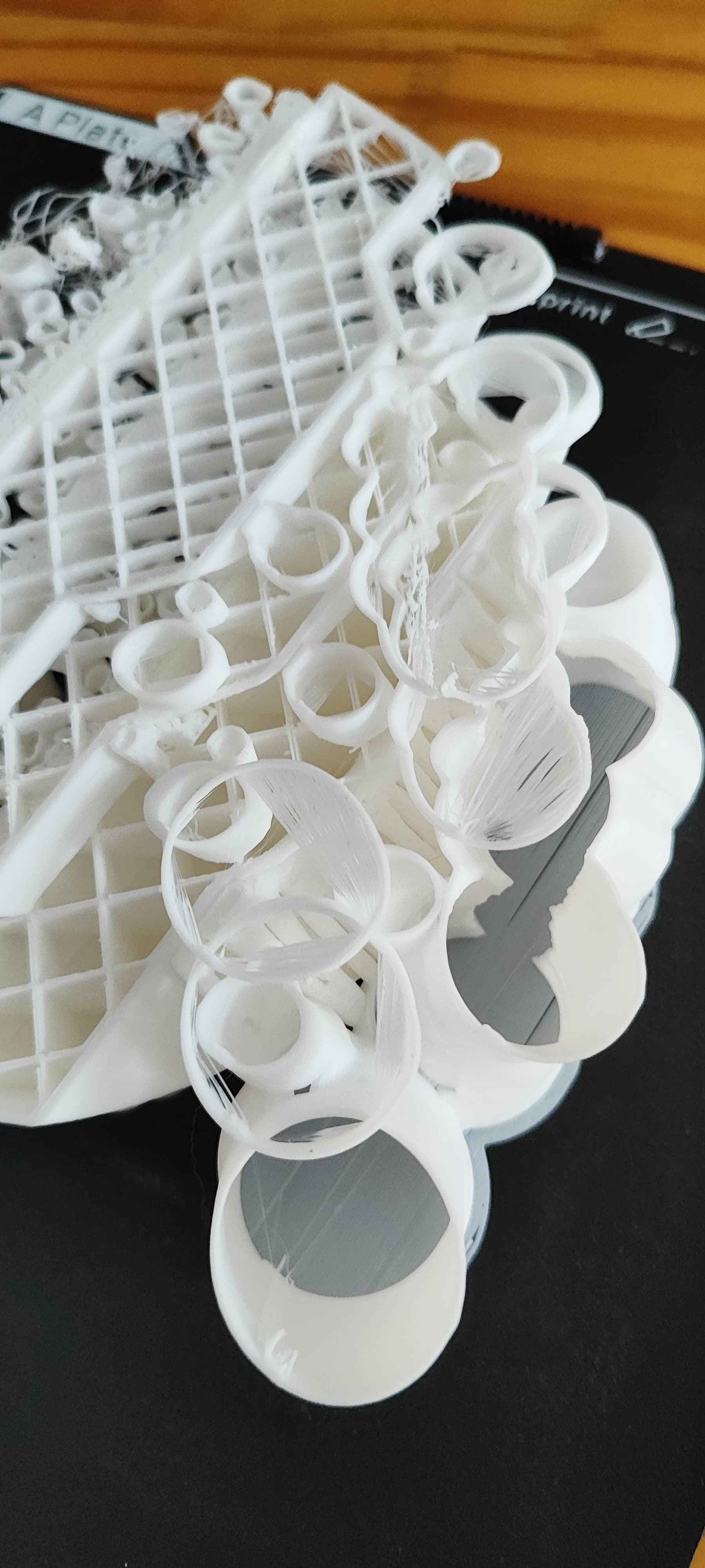

​Hi everyone,
​I’m losing my mind dealing with a massive and consistent layer shift issue on my Creality K1C, and I’m hoping someone here has experienced this and can point me in the right direction while I fight with Creality Support.
The Problem:

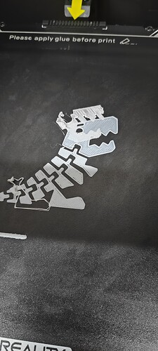

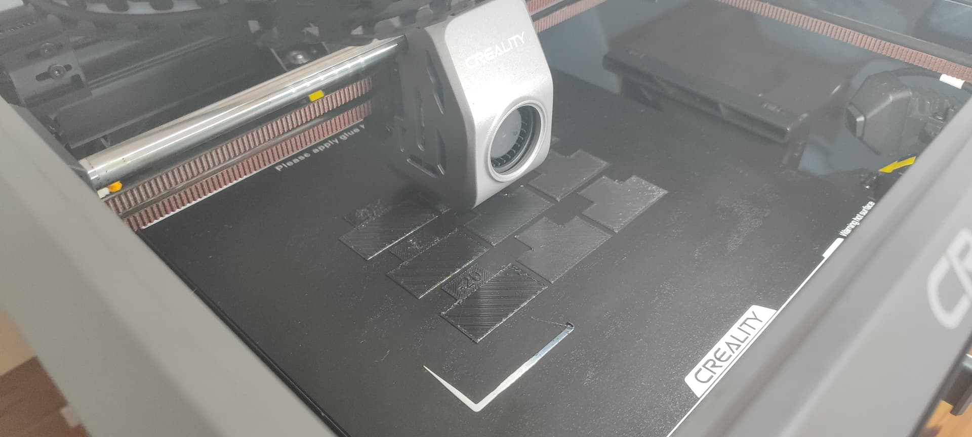

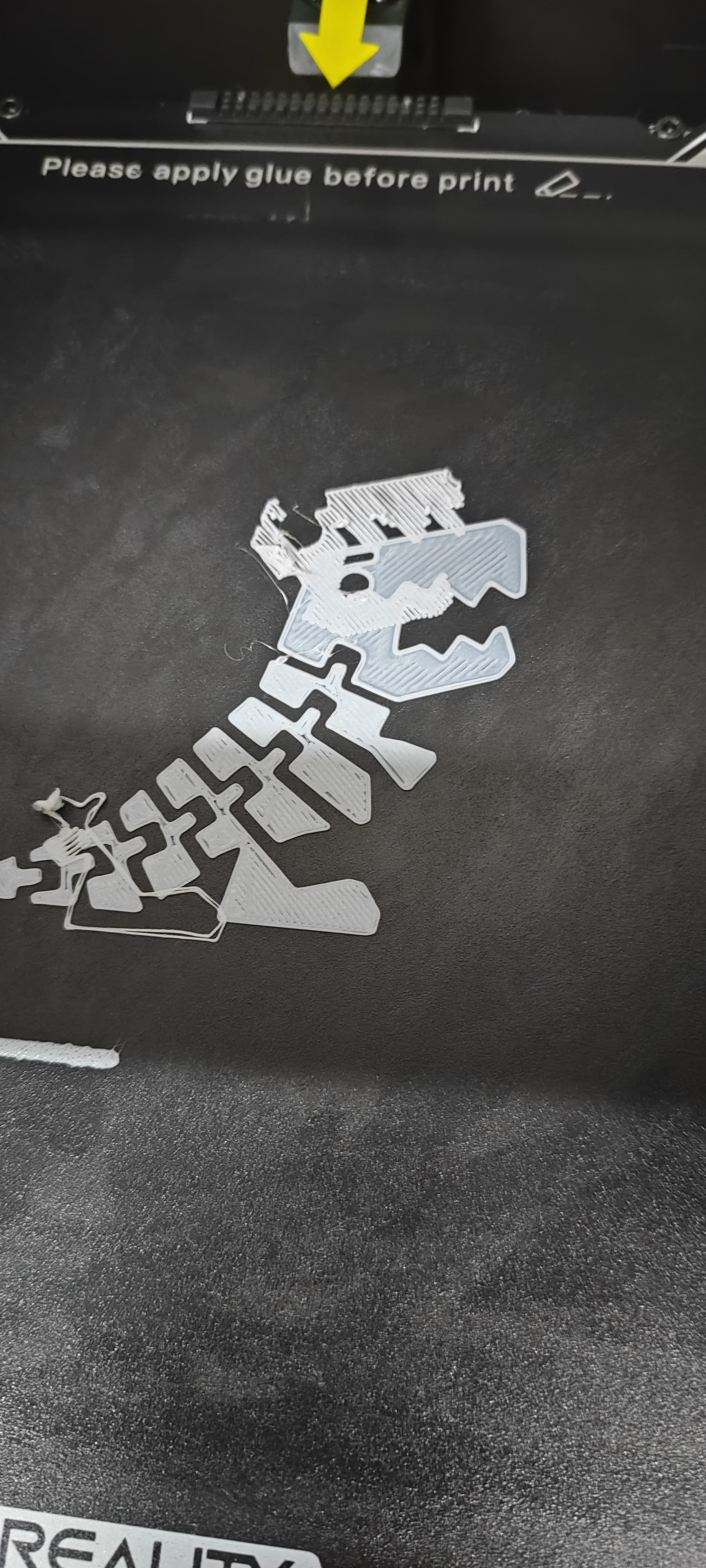

My K1C prints perfectly fine for quick things (a Benchy comes out flawless). However, on larger/longer prints, after hours of seemingly normal operation, the printer completely loses its XY position reference. It suddenly shifts diagonally — always about 5 cm to the left and up. It happens regardless of the sliced file, and always follows the same shifting pattern.
​I’ve already wasted almost 1kg of filament just trying to diagnose this.
What I have already tried (and ruled out):
  • Belt Tension: I used the frequency measurement method (measuring Hz) to perfectly tension and balance both A and B belts on the CoreXY system.
  • Lubrication & Cleaning: Cleaned and re-lubricated the linear rods/axes exactly as the manual states.
  • Cable Chain: Checked the X gantry cable chain and toolhead harness. Everything moves freely with absolutely no snagging, binding, or tight spots during long X-travels.
  • Motor Voltages & Hardware: Checked the stepper motor voltages, checked pulleys, grub screws, and connectors. Everything is tight and secure.
  • Speed/Acceleration Test: I even ran a large print completely slowed down to 50 mm/s (with low acceleration) to rule out the motors skipping steps due to high speeds. The exact same diagonal shift still happened.
Current Situation:
I opened a ticket with Creality Support. They actually agreed with me that this is NOT a slicer, profile, or simple “belt slip” issue. Their official response was: “This is almost certainly a hardware or mechanical fault triggering a kind of ‘step-loss’ plus a homing/location error.” They escalated it to their technical ops team for a warranty replacement (likely the motherboard or stepper motors), but we all know how long that can take.
My Questions:
  1. ​Has anyone had this exact 5cm diagonal shift on the K1 series?
  2. ​Does this sound like the stepper drivers on the motherboard are overheating (thermal runaway) after a few hours and dropping steps?
  3. ​Is there any DIY fix or further testing I can do to pinpoint if it’s the mainboard vs. a specific motor while I wait for the warranty parts?
​Any help is highly appreciated! I’ll attach a timelapse and photos of the failed prints.
