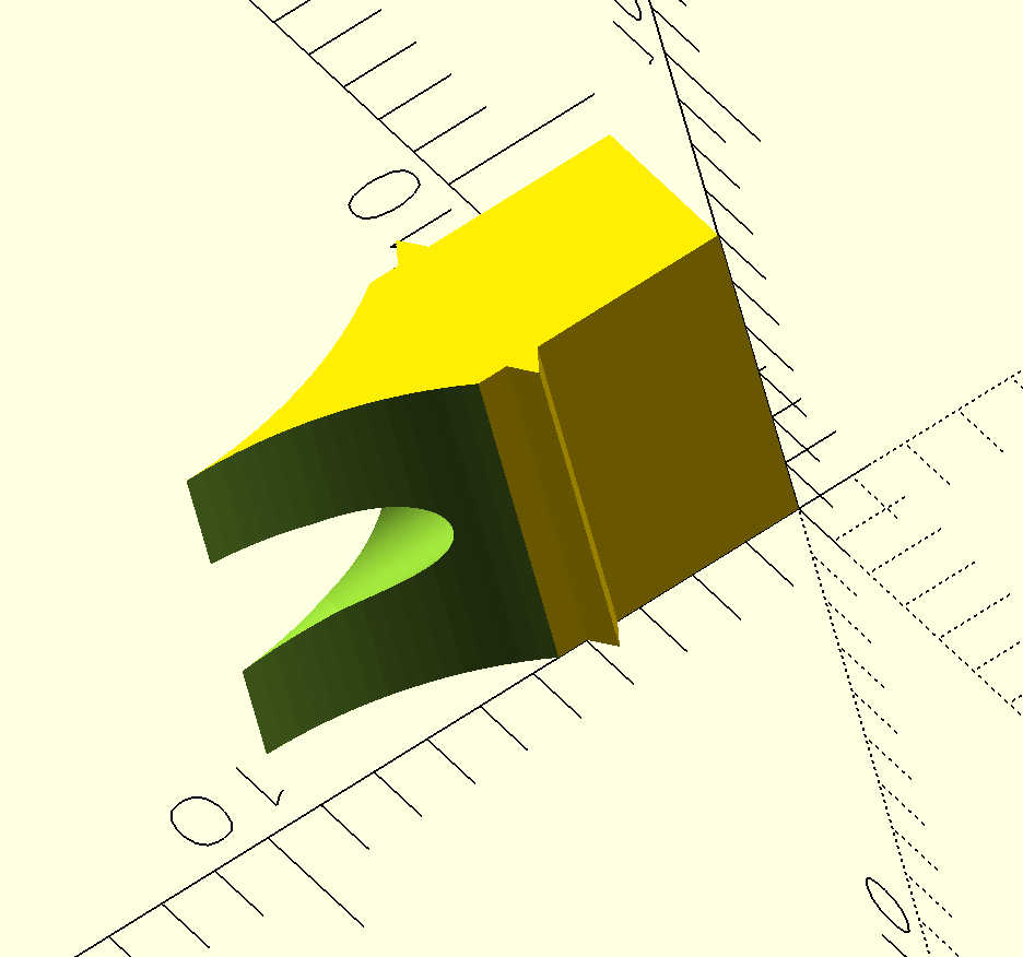

OpenSCAD model, can supply OpenSCAD and STL files if anyone is interested.

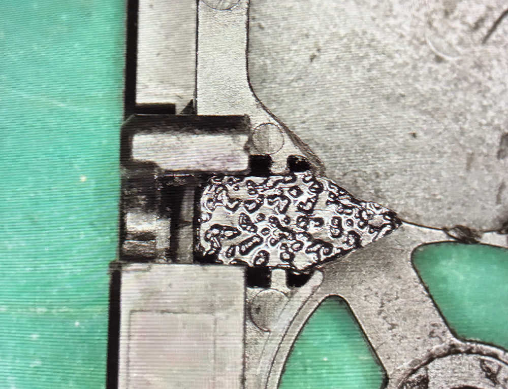

in situ

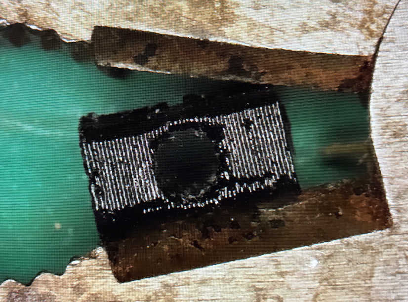

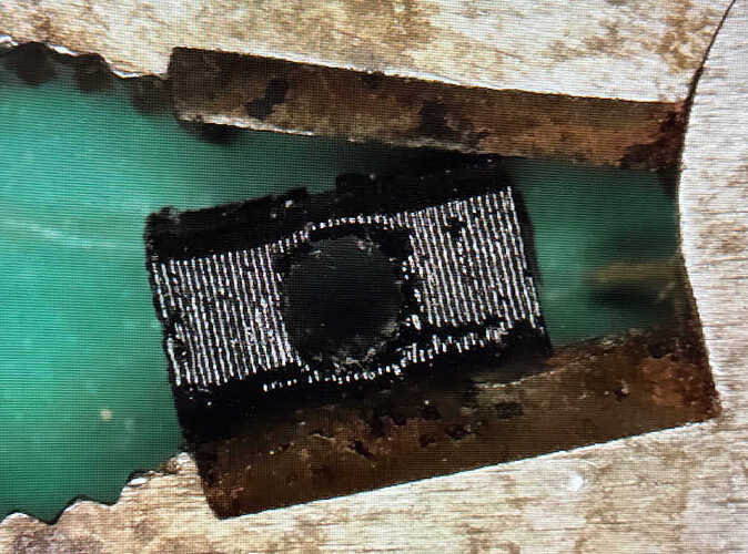

Underside exit point - printed at 1.95mm but had to ream it out with a 1.8mm drill bit

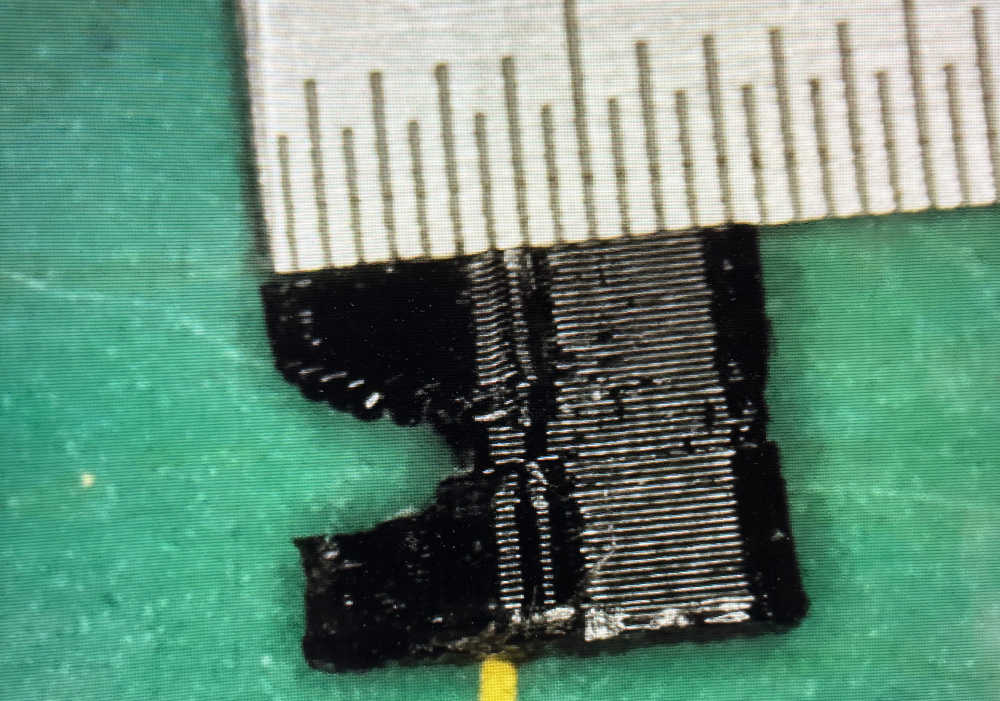

6mm high. I flared the entrance hole which is a bit rough because I printed without supports but, hey it works!

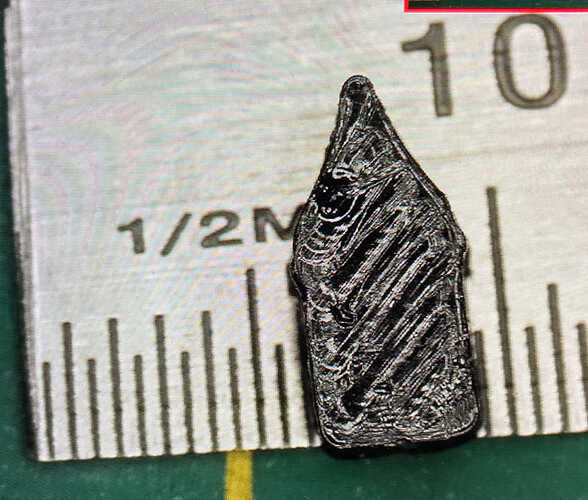

its 3.1mm wide and 7 mm long - could be a mm longer.
