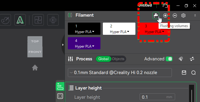

Every time I start a print my k2 performs the normal start up routine and level it does all of this fine. The issue is when it gets to the purging phase it never stops, and I stoped it when I saw ten poops on the ground but my best guess is that it would go indefinitely. I’ve had the printer for a month and everything else has gone smoothly, can someone please help.

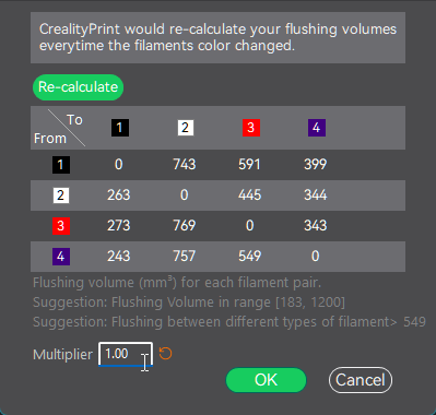

Check the flushing volumes settings on the creality print slicer
If you put a high multiplier you can waste a lot of filament.
