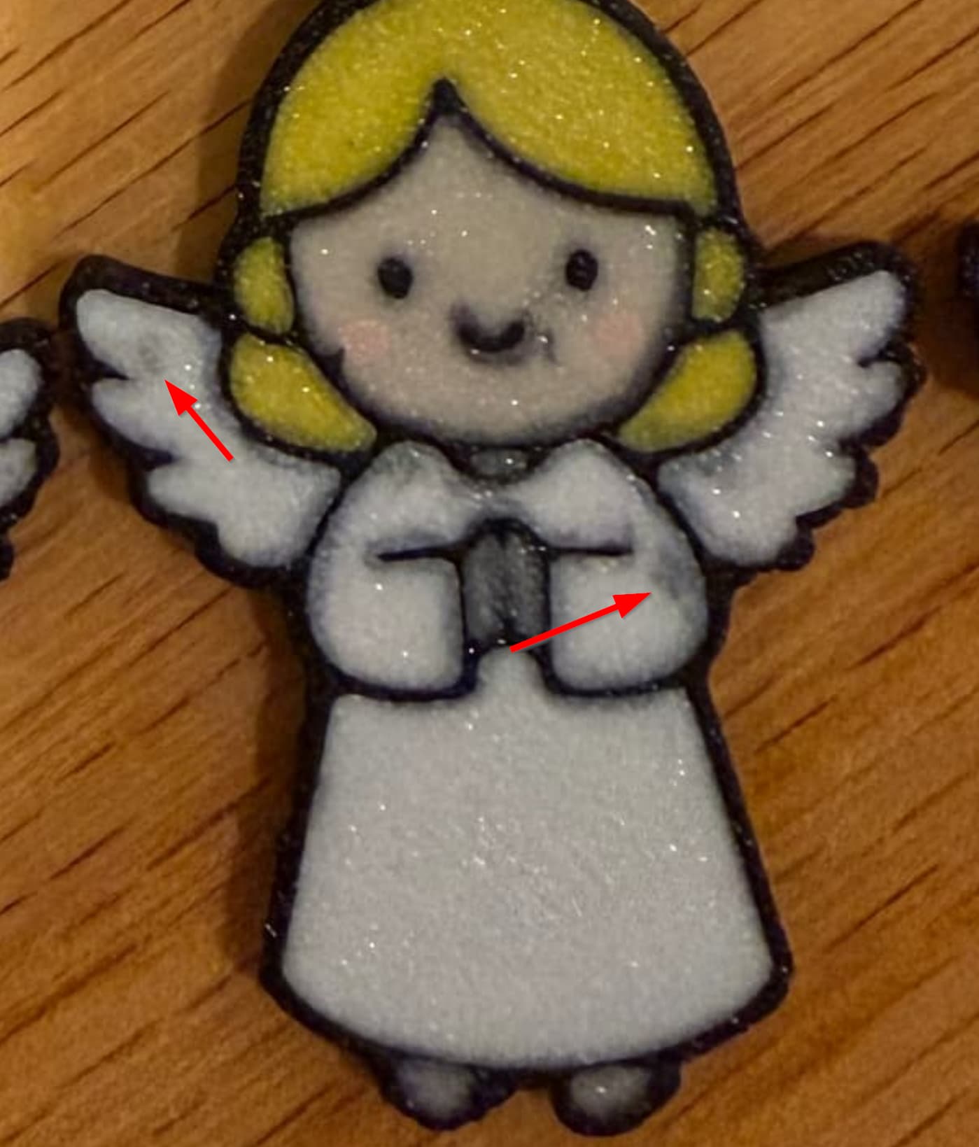

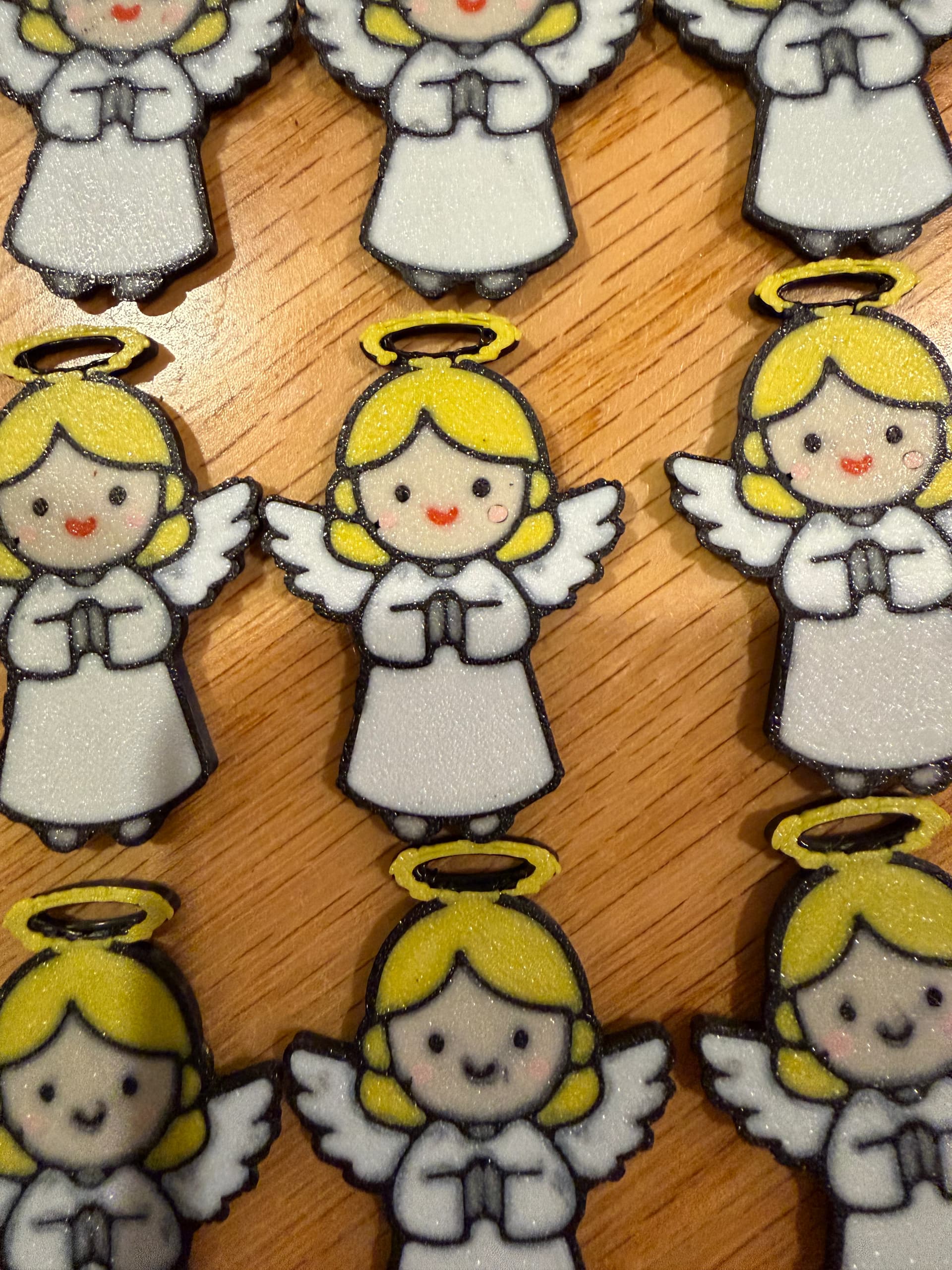

I previously posted about poor K2 Plus prints vs K1c prints–which is still an issue. It is a bit better at times after optimizing filament settings, but I am still getting frequent poor prints. The two pictures below are from within the same prints of identical cloned models– Print settings include slow layers 1-3 (0.2 mm layers, speed 20-30 mm/sec). I just checked my bed flatness and it is generally within <0.06 variance for the bulk of the print bed space.
What am I missing that is giving such erratic prints?
The color bleed is a new one on me. What kind of filament is this?
Elegoo PLA+ rapid for all but the skin color–which is Creality (HyperPLA non-RFID). I’ve been battling it for a while–but within the same print runs it doesn’t make sense to be so varied. I’m trying to avoid the black line prints until after the first layer print on the next run to see if it makes a difference. I have no idea what would be causing most of them as the bleeding-through black should be tightly confined to its spaces (eyes and nostrils, which I actually shrunk down in size relative the the holes in the lighter filament part of the model).

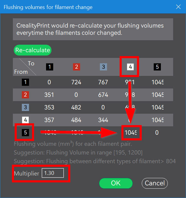

This looks like a purge issue. If the last filament is not purging completely, when the next filament starts to print, the remnants of the previous color will still be in the nozzle.

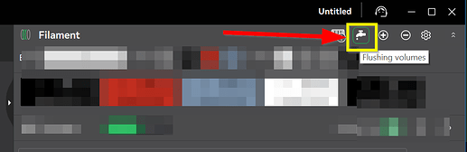

The way to remedy this is by increasing the flushing volumes.

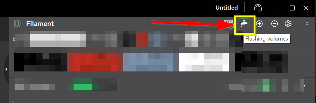

You’ll be provided a table whereby you can increase the multiplier between colors. This table below is what pops up and it will be different depending on what colors are in your CFS. You want to increase the number which increased the volume of filament that is purges between the two colors. So as an example, the default algorithm would make the purge less between red and black because black is darker and red bleed wouldn’t be noticed as much. Goin the other way from black to red, the purge value is higher for the opposite reason.
To test this, what you would do is to create a simple model with different color layers and flipping it on it’s side. You can do this by stacking some cube primitives at different colors, then flip it on its side to get the stripe between black and white.
Here’s the latest wiki guide on this topic:
Good luck :four_leaf_clover: and let the community know how you faired so others can benefit.

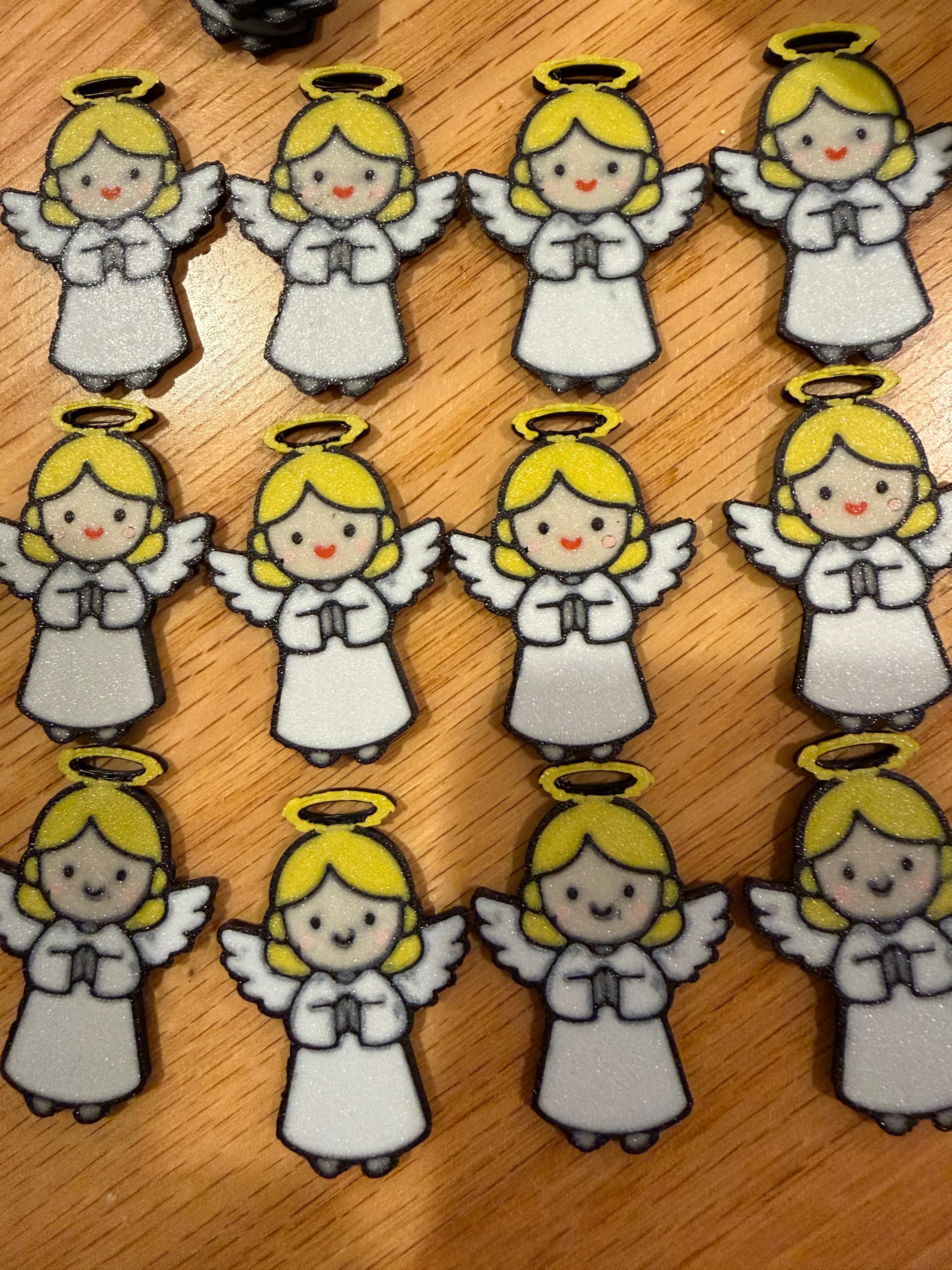

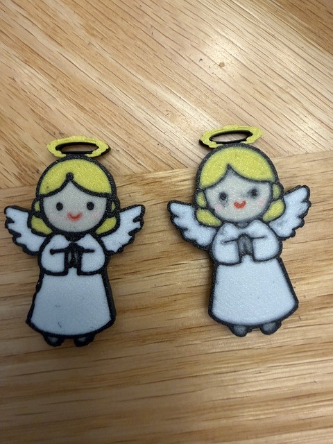

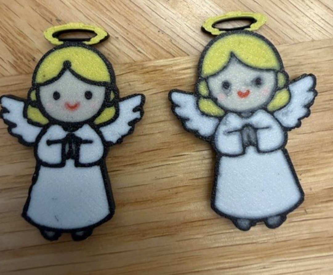

Thank you for the info. I put in flush volumes of 1200 for anything related to black with implement but still some stuff still obvious. It seems to be in the same spurts in general. The top set : same as the last posting. 2nd row: with high flush volumes and print tower 120, last one I corrected the model before printing in case that’s an issue.
The increased flush volumes has helped but still has sine artifact and it’s always at the same parts of the print.
Could it be that the lighter filament is dragging in from the outer black line? Should I try printing from the inner to outer wall? What else might I be missing?
If you increased it to 1200 and that did not work, try 2400, then 3600 and so and and so on, to see if it has any impact.
The pronounced bleed-through reinforces the likelihood that this is a purge-volume issue.

I’ll try a higher number. I didn’t know I could go above 1200 lol. Why would the bleed through occur at precisely the same spots in each case within that print run? If it were only bleed-through, wouldn’t it be more random?
I don’t think that the printhead is getting contaminated, but hard to tell for sure. The model parts are directly abutted without space, so there may be some possible overlap–although I optimized pressure advance, flow rate for all the filaments I use. I wonder if the reproducibility of the effects suggests touching the black line as it progresses around at specific parts? It is printing outer wall first.

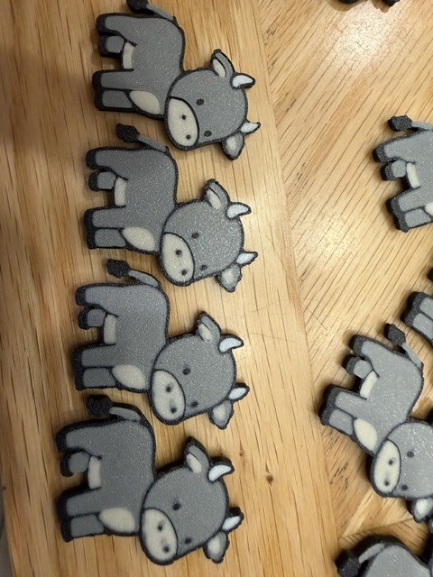

Thank you for all the thought & effort in your response! I wondered about more opaque filaments–that would definitely make my life easier for this model anyway. I was unaware of how big a problem bleeding could be–and assumed it was just my printer. The kicker: for a different model that printed poorly on my K2 plus, it prints nearly perfectly on my K1c. I tried using all the same speeds, jerk, etc that the K1c uses but still got poor results. I don’t know why my K1c prints so much cleaner still.
