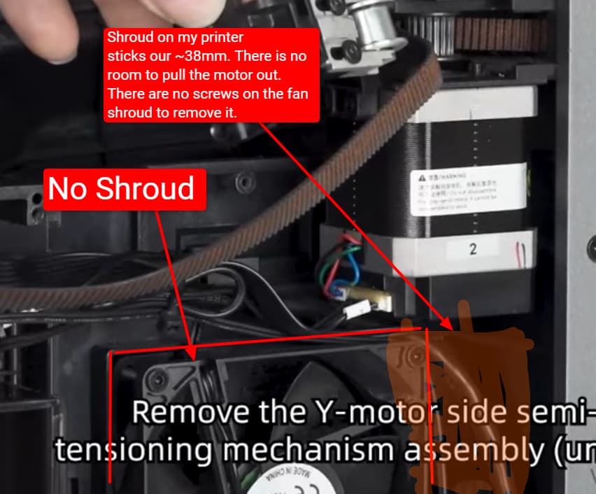

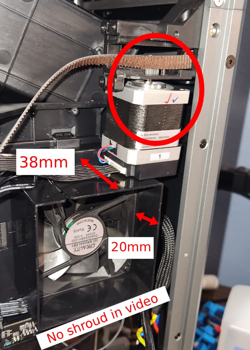

The printer sold by the reseller (#1): 1 month later, I was told I needed to replace the Y-axis motor. The motor arrived on 7/28. The next day I watched the video for replacing the motor. The motor is attached to a bracket with tensioning wheels. The video made it look fairly easy to change out the motor. I got to the point of sliding the gear/shaft of the motor under the bracket it is attached to. In the video it came out easy. I tried different ways of twisting, different angles, nothing worked. I went back and noticed the printer they had was different. The video had a fan below the motor with only 1/3 of the fan was directly below it. Looked at my printer and it has a shroud sticking out directly under the motor and completely covering the motor.
The “L” shaped bracket has screws on two sides of the printer in the corner. One set of screws are under the glued in side glass. The shroud has no screws to take it off and is either molded into the backboard of the printer.
Video printer
My Printer

Based on the video, do you think it’s possible to replace the Y-axis motor assembly by removing the upper shell?
You can refer to the tutorial to see if this is possible:
https://wiki.creality.com/en/k2-flagship-series/k2-plus/replace-idler-wheel
Go to the WIKI page, it’s almost humorous.

Creality support wanted me to replace the Y-axis on the second one but there wasn’t a way to remove it without removing 75% of the printer parts. I demanded a refund or replacement. I’m shipping this one back (at their cost) and getting a full refund.
