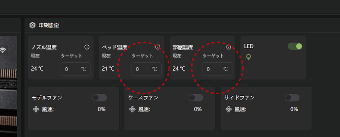

At what point during the print process can I adjust the bed temp and the extruder tem? Do I have to wait for the actual model to start printing? Or can I adjust it during bed leveling or flow calibration?

こんにちは。
私はプリント前に、スライスソフトからデバイスを選んで赤点線のtarget温度を上げています。
又はタッチパネルホーム画面右側の温度を上から2番目と3番目をタッチして上げています。
ノズルはプリント開始をすると上がるのでしてません。
ベット温度とチャンバー温度を上げて、しばらくしてからプリントします。
日本は冬なのでビルドプレートにフィラメントが上手く接着しません。
Hello Keith,
You can adjust directly in printer or in CrealityPrint, as @usagi show in his picture. You can change at temp boxes, but a pro tip, if you change it for first layer, normally, as it print, it should change back to the config defined in CrealityPrint! So, if want to change temperature, change it after 2 layer. But if you have multi-colored print, it always change temps back to what is defined in CP. You should create a profile for your material.
An example: I change my temps for winter and summer, because in my house, where printers stay, it can be a lot of cold and can be hot. So I create 2 material configs, for summer and winter. I add more 5/10cº in wint and -5/-10cº at winter.
