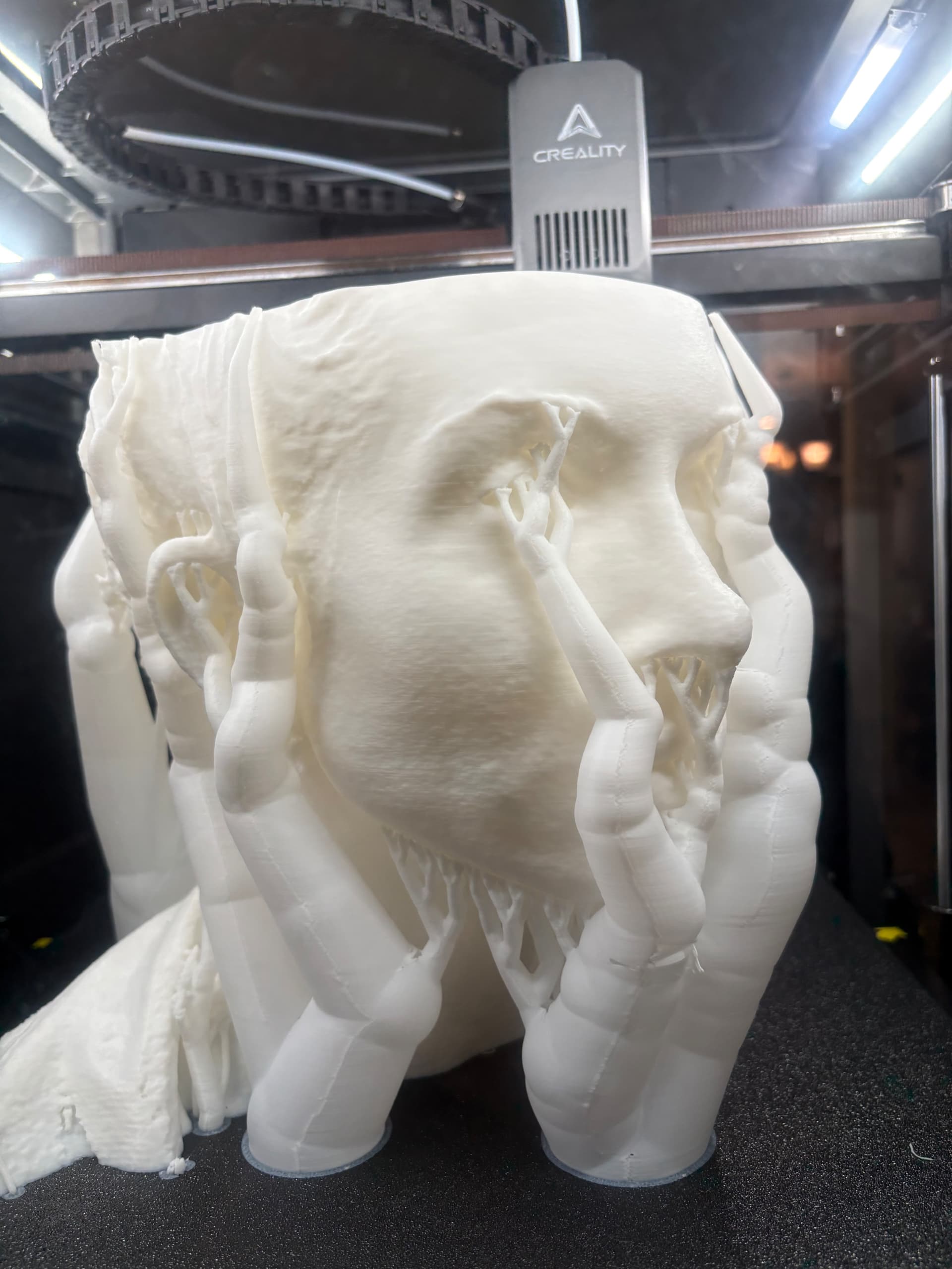

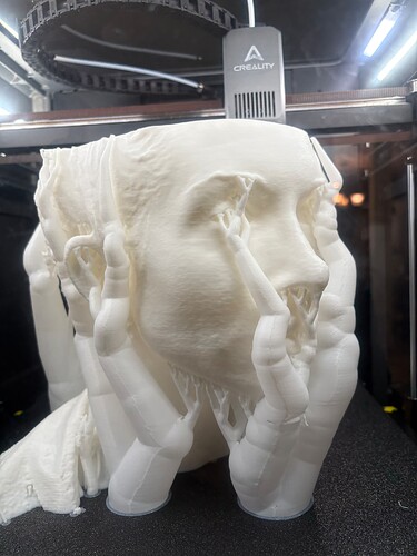

I have been emailing back and forth with Creality support since I posted this. I did a printer factory reset and then I couldn’t print at all. As soon as it tried to set the Z height it would stop , turn off the light and lock up the printer. Numerous emails and mostly one line requests. They sent me a link to WIKI for how to access the Z drives. I did a calibration and it said the belt test failed. I looked up how to fix that and adjusted the belts per the video. I adjusted the two Allen wrench screws 2 turns and re ran the test. It passed the belt test. Then it printed perfectly and even a second print. It am now on my second day of printing a full scale head bust of my daughter. Yea.
