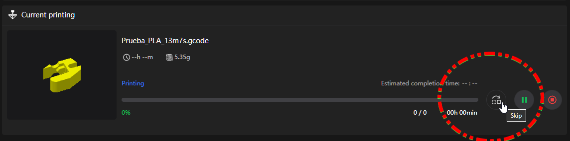

I was a large fan of, and frequently used the option in the upper left corner of the printer screen to omit an area of the print bed if you were perhaps printing many of the same item and one went bad. You had the option to stop printing the bad one but continue the rest. This was a great feature and limited wasted filament etc.
That option seems to gone in the newest software. Has it been moved to either another part of the printer screen or software and I just can see it or is it gone?

It looks a little different but it should still be there. Now It’s on the bottom of the printer screen just to the left of the pause icon.
Also make sure “Exclude Objects” is enabled in the Creality Slicer.
Is there on the Creality Print interface
Then a picture of bed is shown and you can select which one object to skip
