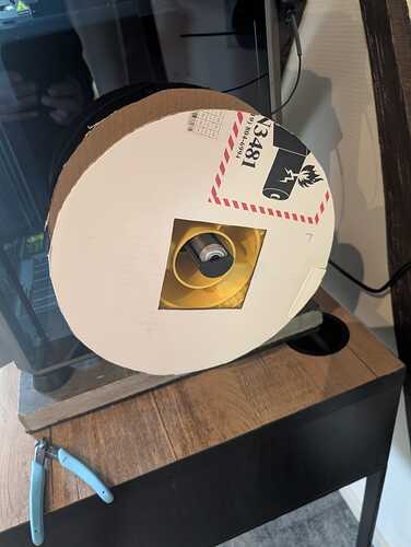

This is my first time trying to print with ASA filament on my K1C.
After 2 failed attempts, I found the cause… my filament spools were still too full, so the filament kept slipping off the spool, which caused a blockage.
After thinking for a moment, I noticed an old cardboard box lying around and thought: you know what, I’ll make the spool bigger so the filament can’t slip off anymore.

As you stated, it is not the type of filament but the manufacture who either overstuffed the spool or used an inadequate spool. Did you weigh the spool before printing? If it came in above 1KG, then you got a bonus. But if it came in at 1KG then the MFG has a bad design. Can you share who the brand is?

Thank you for your reply, and maybe it’s not such a bad idea to put the cardboard spool enlarger into production, but your suggestion to look on Printables seems better and faster.
As for your question about the brand: it’s from 123D, which I believe is a Dutch brand that sells almost everything, including printers and filament.
