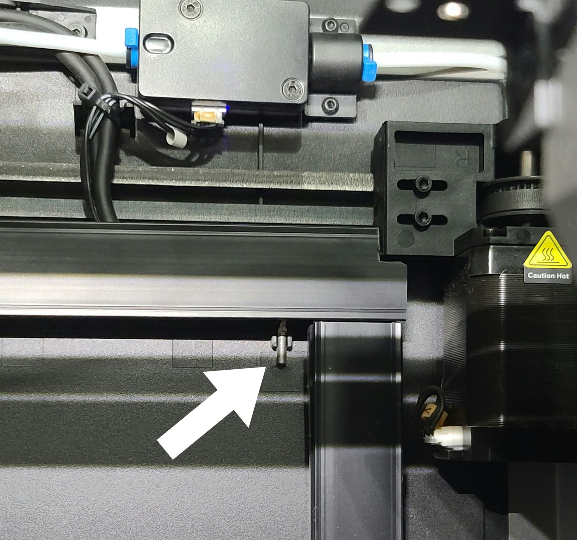

hi to all , i bought k1 max for repair then found no chamber thermistor in the back panel of printer , could not find it anywhere so which temp sensor or thermistor can be used for , thks for help.
From what I was able to find out the K1 Max uses a 100k NTC thermistor with a B3950 beta value. Several other machines use them also. I don’t know if the connectors are the same though. Should be a 2 pin.
Found here:
thks for help , i did look at it and will modify the connector in case can not find 1 right , thks again.
