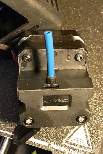

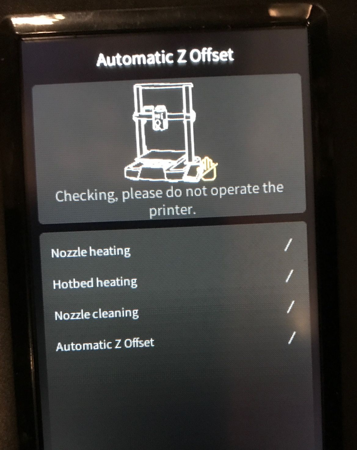

Finally got my Ender 3 V3 KE printer in after several mishaps on the shipping. Got is all put together, made a test print, came out quick ! And not too bad for ABS. first print|690x390 Ready for 2nd trial print and got this error msg
Can’t get away from the error msg, Every time I turn on the printer the msg is there. And tried to load factory defaults and got stuck here
Hope fully Creality will see this and help - already written and nothing yet!
Have a read of this, seems to be pinched wires to the CRtouch
Thank you Bonfireman, I’ve read it, tore apart the BL Touch, no wires twisted or pinched.

Well that was a waste of 20mins, in the cold! Garage shop, Oregon 34 outside
Got it apart, no visible kinks
Even switched out the PTFE for a Capricorn one
, twist or pinches on the Touch.
Broke one of the little latches holding the Touch body together, no screws just snap together put a little lube on the plunger, wiped off the excess. Those connectors are tiny.
It’s together and the error is the same. Nojoy
