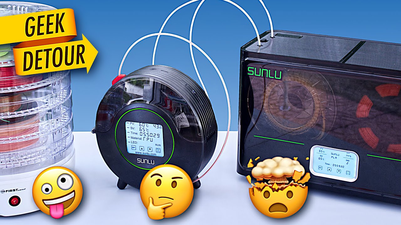

Hello GreyArea,
I have a couple of Sunlu driers and they are ok…just ok…not brilliant.
They do their job, sort of. I had to put extra holes in the top and later a small fan to let the hot moist air escape.
About a week and a bit ago I purchased a food dehumidifier (the round type one) and it works much better and cost nearly half the price of 1 Sunlu drier .
I cut out the size of a filament spool (round) in 2 of the drying levels to allow me to put a roll in and it works well.
Being that I am into making sensors and such with wifi, I have monitored it along with the 2 Sunlu’s and is definately doing a better job.
My view on it is because it, like the Sunlu driers has a fan, but it also has vents and the fan is positioned to blow the hot air up through what ever is in there, where as the Sunlu driers simple circulate the hot (moist air).
Someone once posted a question regards my saying hot “moist” air trapped inside the Sunlu drier and I said,"put a spool of filament in it for an hour and then with your face close to where it will open and simply open it; you will FEEL the hot moist air on your face.
I trust this is a long enough rant.
If not, I will supply the circuits and programs I have for my setup and spend an hour or two discussing the ins and outs :grin:
Cheers.

Ahhh Martin_Prent you have woken the “drier” subject I keep trying to be quiet about…but can’t :grimacing:
I would like to star a thread on the subject with the hope that someone that is involved in that field can give definitive answers about it all.
My belief is that filament will absorb moisture (yeah ! we all know that…move on), I think that the filament will not simply let that moisture free, as with using Silica gel.
If you put a roll of damp filament in a box filled entirely with silica gel and leave it for a day, it will still have the same dampness.
Silica gel will absorb moisture from the air because it is free to move in the air, but it is trapped in filament.
Filament will only release moisture when it is hot enough to do so, 50deg and up. And it will release it into the hot air space of the drier and will stay there unless it can escape.
And on the subject of silica gel that can “yes” absorb moisture from the air, if you have dried your filament and seal it in a vacuum bag, why put in a bag of silica gel ? you have taken the air out of the bag anyway.
How many have bought a roll of filament that comes in a vacuum sealed bag “with a bag of silica gel inside” and found that the filament is damp and gets stringy ???

Hello GreyArea,
It is, “once again” a time where I need a good kick up the rrrr’s.
Because as I often do, I over complicated what should be quite a simple fix.
Block up the extra not needed holes and simply throw in a bunch of Silica gel bags (take them out when printing).
Yes, the drier simply moves hot moist air around, but with Silica gel bags in there, they should soak up that moisture the filament is releasing.
And there I was, monitoring the humidity with or without the added holes (and the extracting fan) when I didn’t really need to do anything other than add Silica gel bags.
Please tell me I am wrong, my rrr’s is getting sore.
