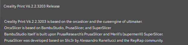

Upgrade to later version.
I’m on this version of Creality Print and it saves/loads multiple object types/colours correctly in the 3mf
