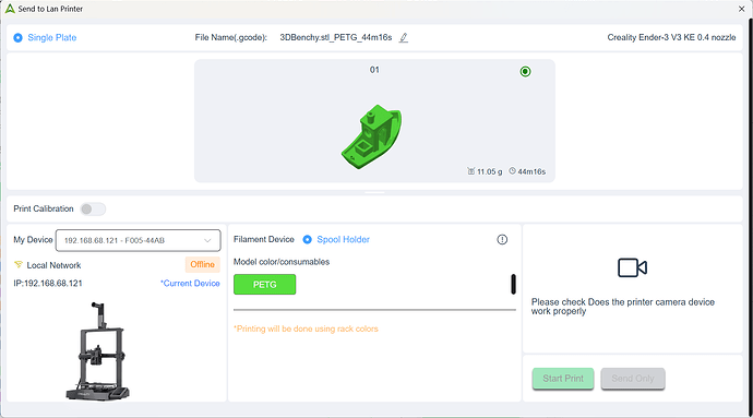

Ender 3 V3 KE , printer is 2 weeks old now. Scraping issue. I have found that if I take a Creality file from Cloud Beta it works great, but if I take the same file to Creality Print 6.0 the .4 nasal scrapes the filament. It has to be a presetting in the Printing app, but do not know what to fix.
Is the nozzle scraping previous layers or is it scraping the bed? Scraping other layers could be using the wrong infill, such as Grid. Another thing is flowrate too high. If it is scraping the bed you’ll need to adjust the z-offset, first start by recalibrating the bed and getting a new level mesh.
Not scraping the bed, but it is scraping the previse layer. What is the Cloud Beta calibrating that Creality Print is not? When I print from Cloud Beta it asked me if I would like to auto calibrate. But Print does not ask the same question when sending to the printer.
On the middle left there is a print calibration slider on the send print page.
