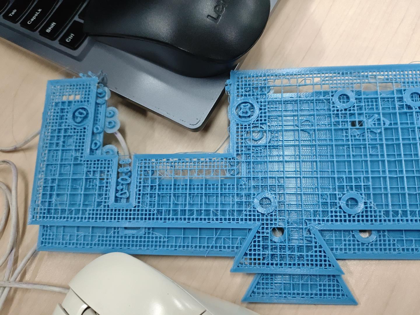

Hi everyone,
​I ran into a massive layer shift issue mid-print, and it’s the first time I’ve ever experienced something this severe. As you can see in the photo, the print shifted significantly along one axis while laying down the infill, completely offsetting the rest of the structure.
​Print details:
​Printer: K1C
​Filament: PLA+
Print speed: 60mm/s
Before this, prints were coming out fine. What could be the most likely cause for such a drastic slip? Could it be a loose belt, a stepper motor driver overheating, the nozzle hitting the infill (grid infill catching), or something mechanical?
​Any advice on where to start troubleshooting would be greatly appreciated. Thanks in advance!

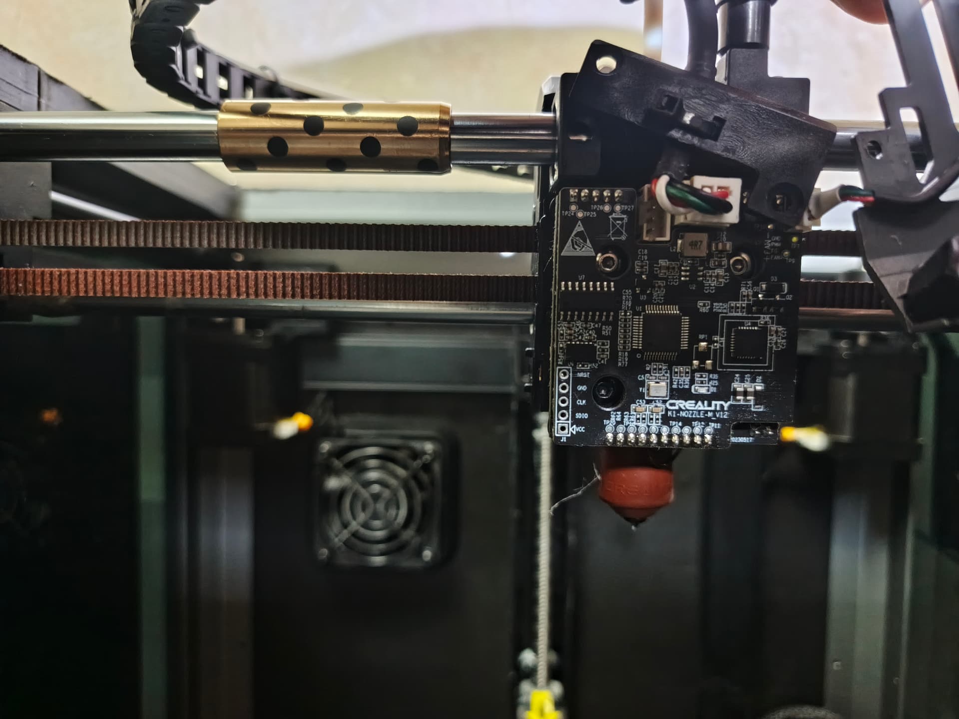

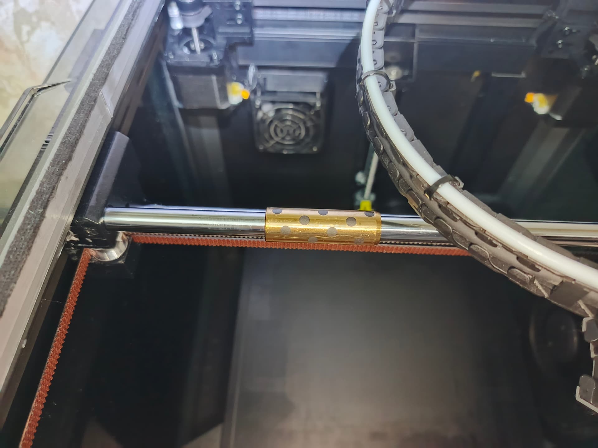

Hello, the layer misalignment issue may be caused by a software error or mechanical failure. Try thoroughly cleaning the X-axis plain bearings, then lubricate them with machine oil. I used weaker bushing pressure springs on my printer to reduce wear and reduce the load on the stepper motors. Layer misalignment may be caused by the print head jamming during movement, which occurs under certain conditions. Start troubleshooting step by step: test models, print at different speeds, clean the plain bearings, check the belt and belt tension, and check the idler pulleys for possible jamming. If you manage to solve the problem, please let me know.
I had the exact same fault but in the last third of big prints ,after a lot of time i found like a poster below it was those graphite bearings .I bought a new set from aliexpress but take plenty of pictures theres a lot of dismantling to replace them .I think its pask of 100% clarity about lubrication of those two bearings .i am now using graphite dust but its a messy way and for goodness if your married dont let the mrs see you blowing the stuff around .on a side note dont hoover it either graphite dust is extremely dangerous around electric motors i hold a damp rag under the tube then tap the surplus onto it ,it really just needs a minute layer to work
@user5288579351
….actually, these bearings are self lubricating, they like to run dry / no external lubricants at all. Brass/graphite on it’s own are low friction components, introducing external lubricants increases friction and enables the external lubricant to catch stuff like dust, which keeps on collecting and eventually damages the bearing itself or even the shaft.
In i 3D printer, there is plastic debris flying around, instead of lubricating the bearings, i would suggest to invest is some high flow active air filter module.
Curious, which filaments are you using the most? I seem to not noticed a lot of dust/debris when printing with ABS/ASA.
Mostly glass reinforced asa .i discovered the bearings were shot by pushing them out and pushing them along the rail ,in a certain bit i realised the bearing had turned and it became obvious there was wear .They are only held in by a screw and i guess when the whole hotend became warm enough the bearings were turning .As i said only in a couple of positions 80% of the time the hotend moved freely .I also moticed as the hotend was going to shift one motor got very hot ,i guess it was having trouble moving the hot end .A set of bearings from Aliexpress and the problem went
