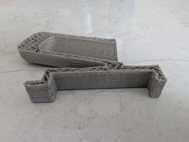

The picture explains it all:
You can see it started nice and solid but after maybe 1/4 of the height it no longer fills the shape with material.
Not a problem with the model – I previously printed exactly the same model without any issues.
Have you reset something? Looks like an e-steps/rotation distance issue or a clog.
Replacing the nozzle fixed it. Thanks!
