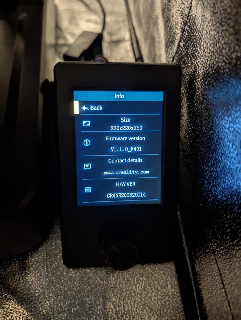

I recently received a refurbished Sonic pad from what appears to be an official refurb store from creality. I was trying to connect it to my ender 3 vs 3e but it seems to not be taking the firmware? I am using the sd card that came with the printer that has been used for other firmware updates. I have printed the USB stabilizers to correct the god awful cable wobble, updated the pads firmware, made sure the card is formatted properly (fat32 with proper allocation size) it flashes the SE firmware to the card fine and have tried connecting to every usb port on the pad. I even tried having the USB-c connected in to the SE’s vestigial port that seems to be for nothing alongside and instead of the serial cable.
every time I try to flash the firmware the old marlin pad just goes to normal operation and doesn’t stick to the creality logo as I have heard is supposed to happen. I am at a loss here and am about ready to return this thing if i cant get it to flash and connect to my printer. I have my printers current configuration here if it helps.

Radical_Data yes it came with all the official cables. Other forums seem to be indicating that the C14 revision boards are not compatible with the sonic or nebula pads yet without custom firmware solutions. So now I am hoping someone makes a custom firmware and guide to making it work i guess unless Creality makes it first
UPDATE: SOLVED, after opening a ticket with Creality support they confirmed the C14 revision boards in the newer printers (IE the ones you see dirt cheep on temu and ali express) are NOT currently compatible with the sonic or nebula pads. they were kind enough to make me a custom klipper firmware for my printer that will interface with the stock profile in the current version of sonic pad and they even sent me, for some reason, a firmware for the nebula pad that will get released soon though I have no way to test it since i have the sonic pad… waiting to see if i can get an updated firmware for the sonic as well to use a dedicated c14 profile but as of now I am printing in klipper!
