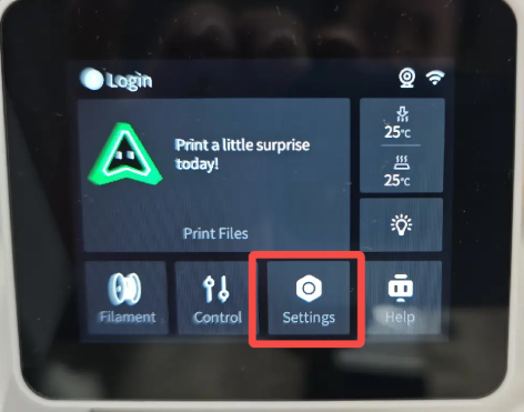

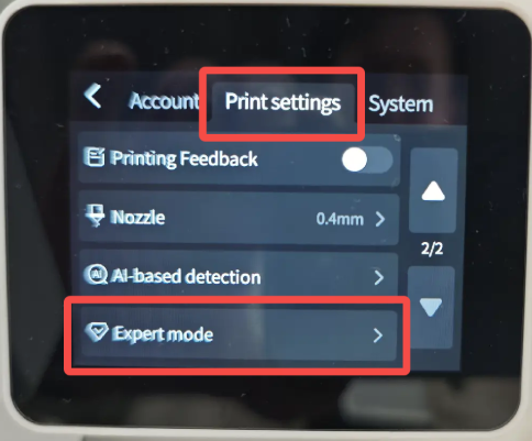

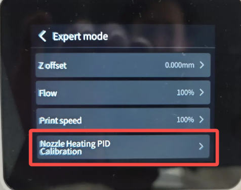

The PID calibration option is located at Settings → Print Settings (Page 2) → Expert Mode.Select Nozzle PID Calibration to start the calibration process.

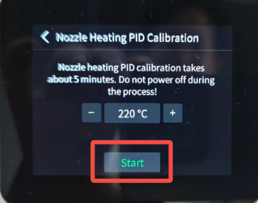

Set the temperature to the recommended printing temperature for the filament.

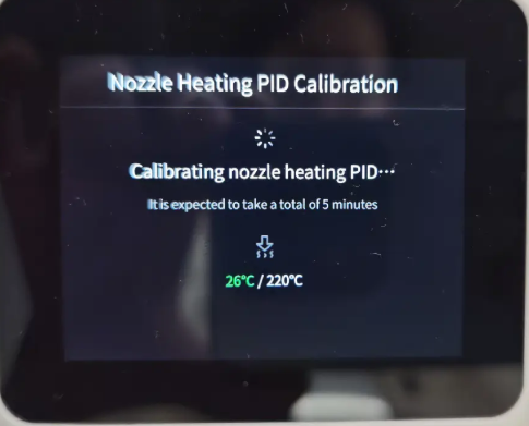

Tap Start, and the printer will automatically perform the nozzle PID calibration.During the calibration process, the nozzle temperature will increase and decrease multiple times. The entire process takes approximately 5 minutes to complete.
Once the calibration is complete, the printer is ready for normal use.
