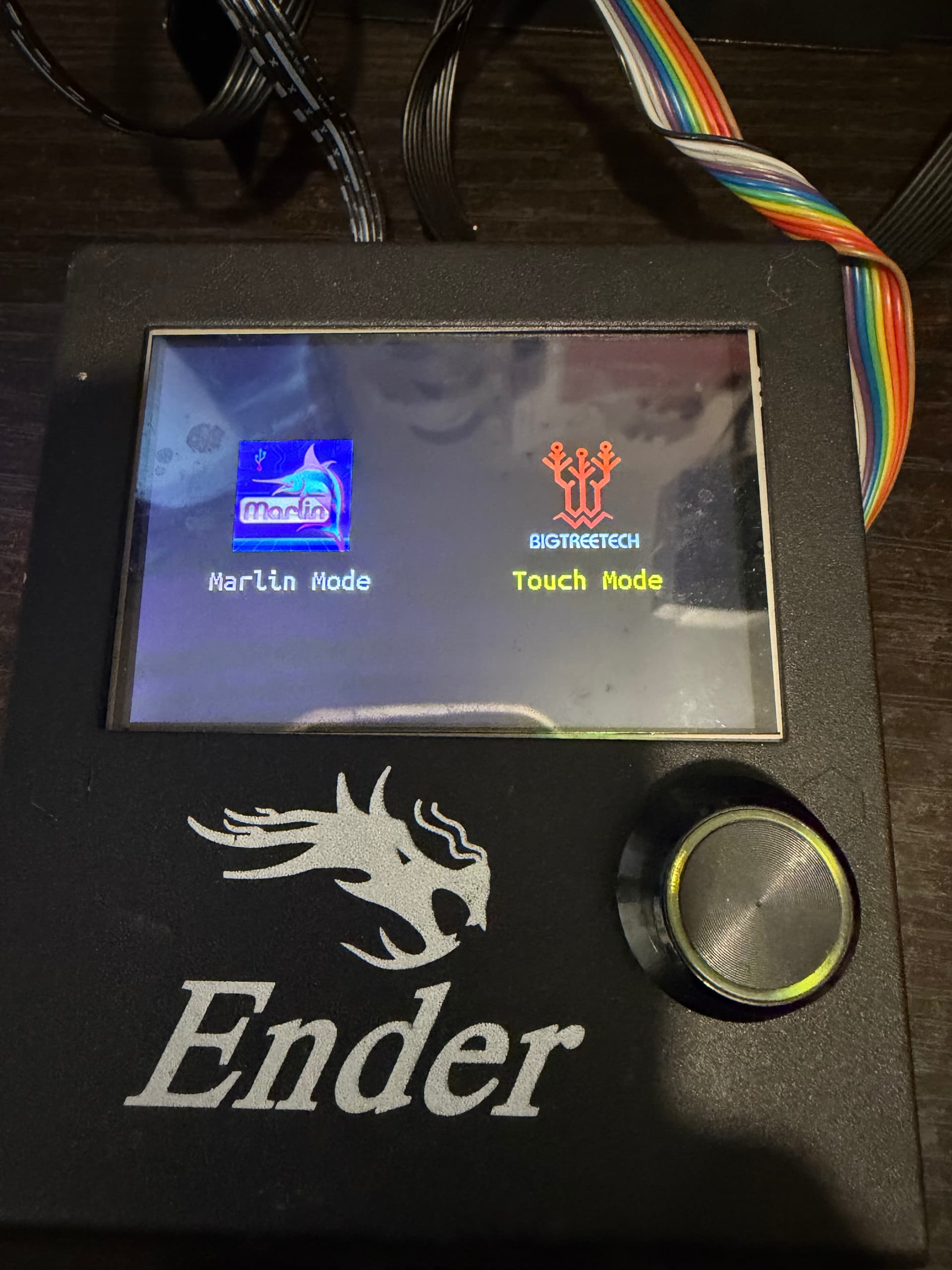

One printer is working well. The other ons I can’t get past the boot screen. So I think my best bet is to identify them both first (They are probably heavily modified) then that should help me decide my way forward.

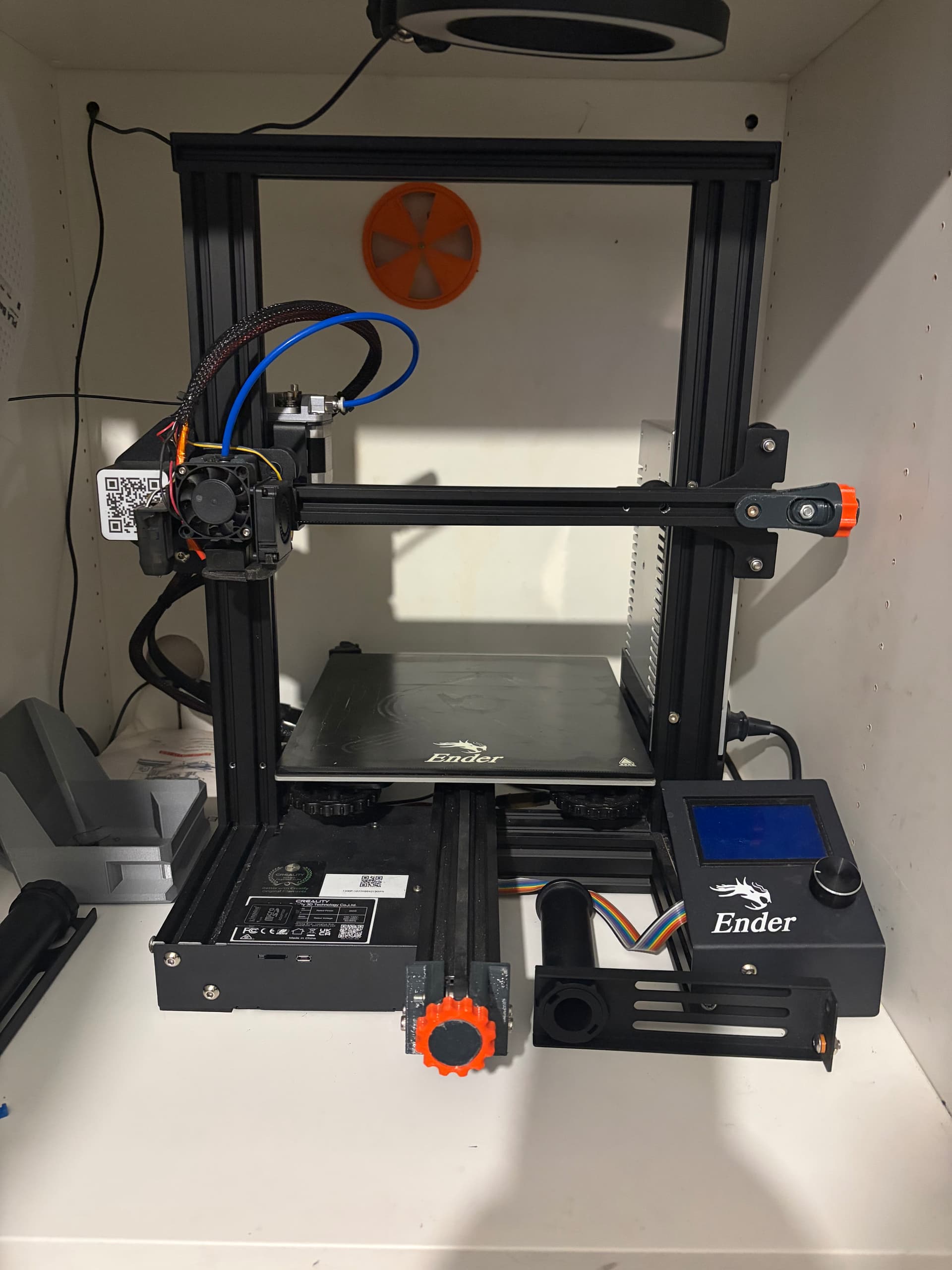

The working one I believe is an Ender 3 V2 or Neo.

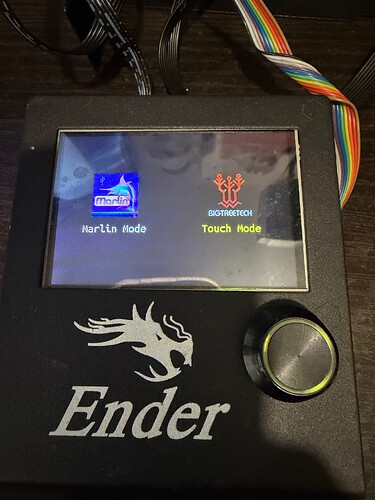

The second on I think is an Ender 3 V3 and I can’t get past the screen in the picture.

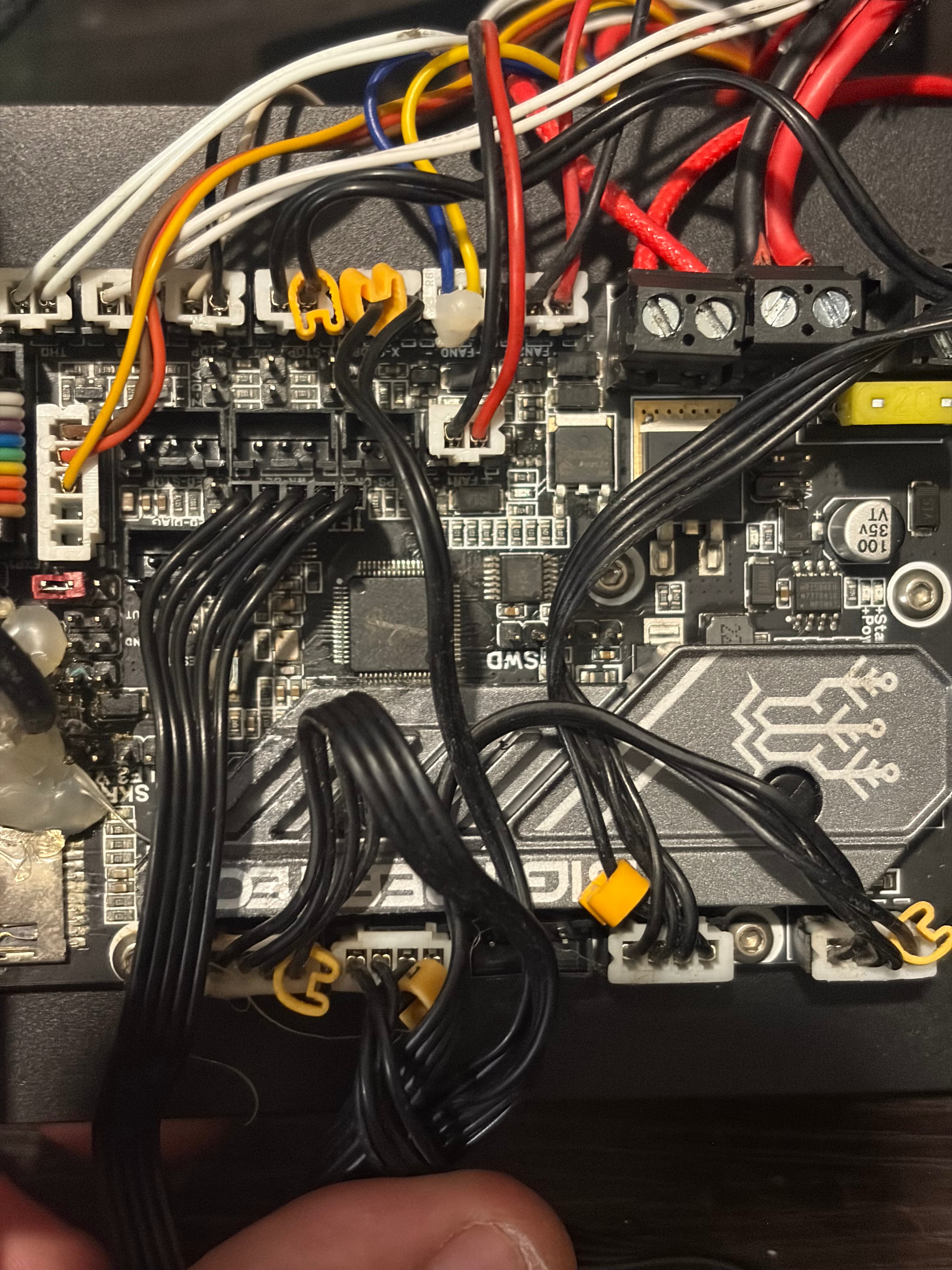

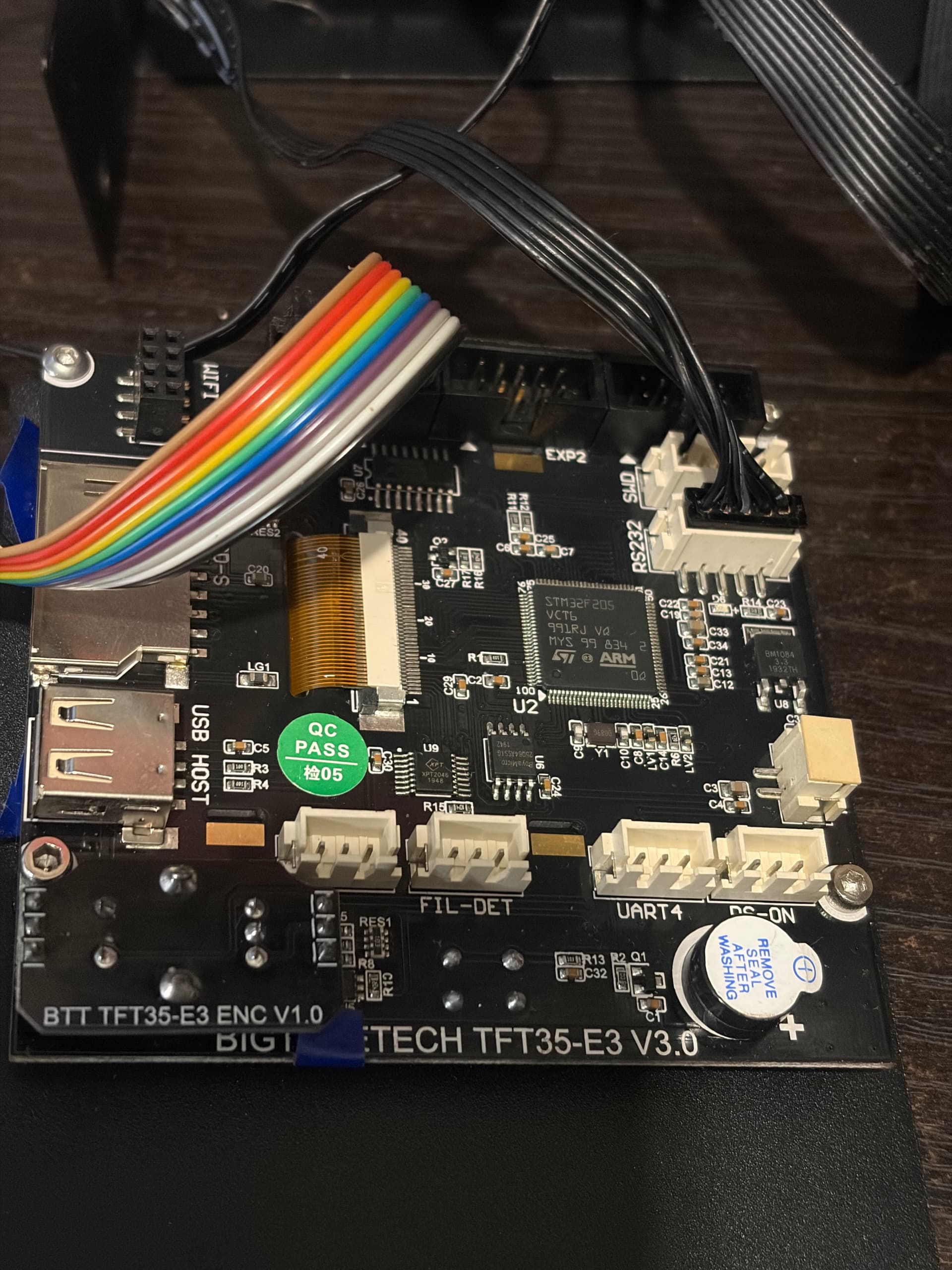

Image 4 is a BigTreeTech E3 V3 control board (Very Good) and image 5 is a BigtreeTech TFT 35 E3 v3 dual mode display. This combination is generally used to modify Ender 3 , Ender 3 V2 or Ender 5 printers.
You may need to learn how to configure Marlin firmware to modify or add to this board.
The TFT 35 display can be used in Marlin mode typical on Ender3 printer or in graphic mode with touch screen in bigtreetch mode.
To use either mode you have to connect the ribbon cable and the serial cable from the display.
The printers are not Ender V3.
Bill
