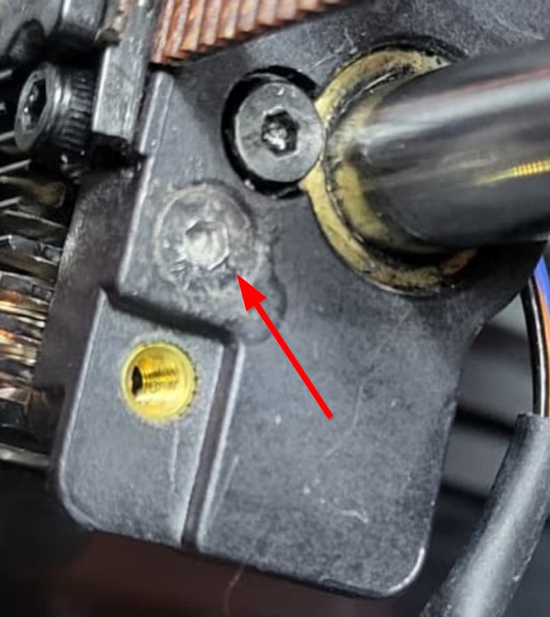

My K1C has been nothing more than a door stop as of late. The nozzle was constantly jamming. If the nozzle wasn’t jamming, the layers were shifting. I ordered a new nozzle to replace the current one which resulted in [CB2564] The Hotend is not heating as expected.
I spent a few days troubleshooting that. Reseating the wiring, but the issue wasn’t resolved. So I ordered a new heating block with hot end. Now one of the hot end screws is stripped on the side of the print head. I cannot get the darn thing to turn.
I’ve tried a rubber band, piece of foil, a vinyl glove. I’ve even tried hot glue. I don’t want to have to get a whole new print head due to one flipping screw.

From what you describe, I assume by “stripped” you mean the drive recess in the screw head is damaged and the screw will no longer turn, rather than the threads being stripped.
There are several ways to remove a stripped screw, but the best method depends heavily on how damaged the head is and how much access you have around it.
Can you post a clear close-up photo of the stripped screw, along with one or two wider shots showing where it sits in the print head? Different angles would help as well.
Once we can see the screw and the available clearance, we should be able to narrow this down to a specific removal method rather than having you keep trying things that may make the head worse.
Yes, that’s what I mean by a stripped screw. That’s always what I’ve referred to the situation as when the screwhead is damaged.

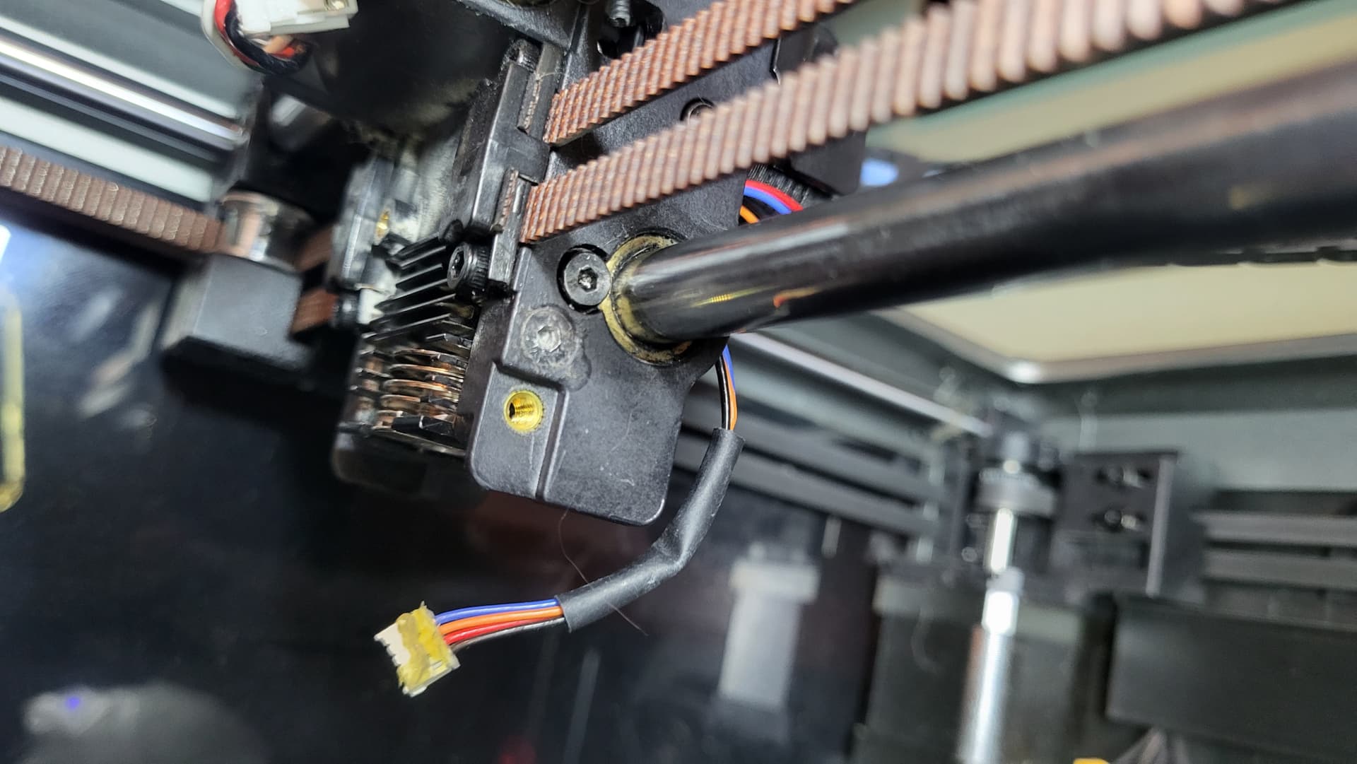

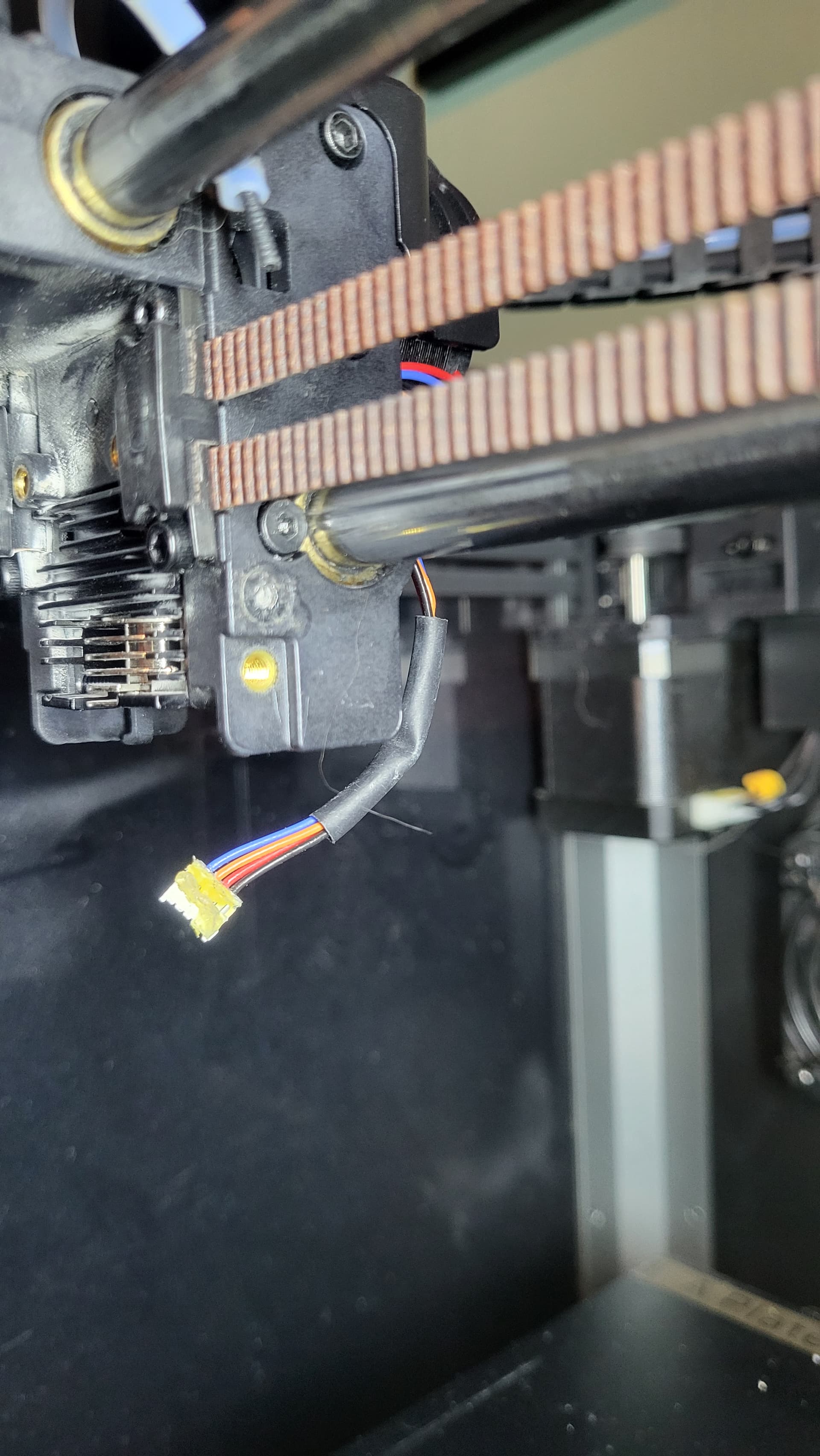

The screw in the middle is what I need removed so I can replace the heat sink block.
Thanks for the clear pictures. This helps. Just to be clear, we are discussing the screw with the damaged hex socket shown in your picture.
Here is what I would try first. I’ve used both these methods and with patience and care, they both work.
The original screw appears to use a 2.5 mm hex driver. I would try a T10 Torx bit. The Torx bit is slightly larger and its star-shaped edges may be able to bite into the damaged hex socket.

That is the screw! Thanks for the tip! My husband has a torx bit set that should have the T10. I’ll give that a go!
