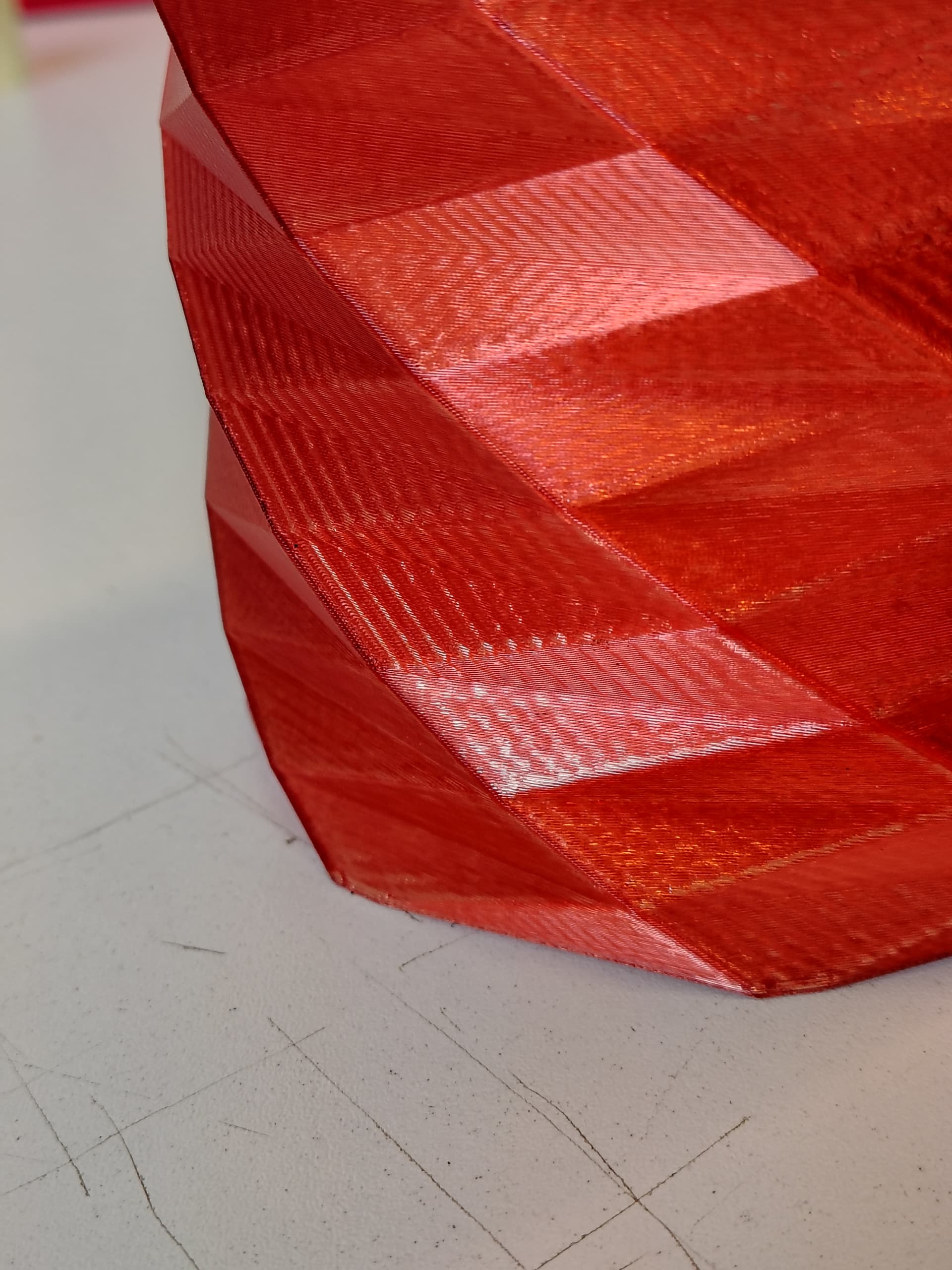

Since I installed a cartographer probe and the k2-improvements library, my K2P finally runs well (had serious bed-level issues before). One issue that remains however, is very strong ringing:

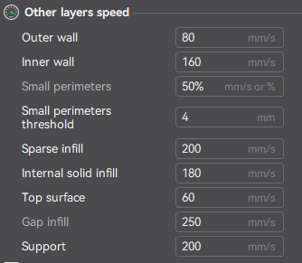

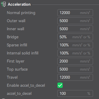

That particular filament and model geometry make it particularly obvious but it’s an issue on all prints. I’m not even printing very fast:
The printer is on the ground (concrete floor with a thin, firm carpet), I’ve tightened all screws (none were loose before though) and the motion system seems pretty rigid to me. I’ve also run input shaping calibration. Am I missing something? It seems almost like input shaping is not running at all but it is included in the bottom section of the config file:
