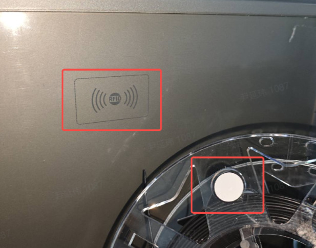

I have a K2 plus with one cfs. I have been printing items with the main colour being white and a band in another colour. I have white in A, Yellow in B, Green in C and Orange in D. All Hyper PLA and identified by RFID tag being read correctly. If I choose the Yellow or Orange for the band it works fine but if I choose Green when I send to the Printer it defaults to B the Yellow even though It shows it as Green. I can select C - Green at this point and it will use C. I have removed all the filaments and re-installed them but it hasn’t changed. The Printer/CFS do show the colours correctly. I only have the K2 pus with no other devices installed. This has only happened in the past week or so. Any idea what is wrong please?

Another easy test is to use the RFID sensor on the side where the external spool is mounted and see what that sensor reads. It could be a case of a bad sensor in the CFS. The one on the side of the unit is a way of cross checking the filament RFID and the Sensors.
Thanks.I will try the side spool. When I take the reels out and put them back it reads the tag and shows it is Green. What I am printing will be done in a few minutes and there is little green left. I want to use Black next so I’ll put it in slot C and I‘ll see what that does.
Well it sees the Black in C and the slicer does too but that did only after I exited the slicer and the brought it back up. There was no problem when I sent it to print. It accepted C for the filament without my intervention. There looks to be more Green left than I thought so just out of curiosity after this print it done I’ll try the Green on the side spool and back in C and let you know. It will be some time tomorrow though :slightly_smiling_face:
This afternoon I offered the tag up to the sensor for the side spool and it read it fine. I decided that I would take out the Orange in D and put the Green in there as I had a good bit more I needed to use the Black for. The Green was recognized and I was able to do a little test print without needing to intervene. Tomorrow I will finish using the Black so I will then put the Orange back in D and try Green in C again.
